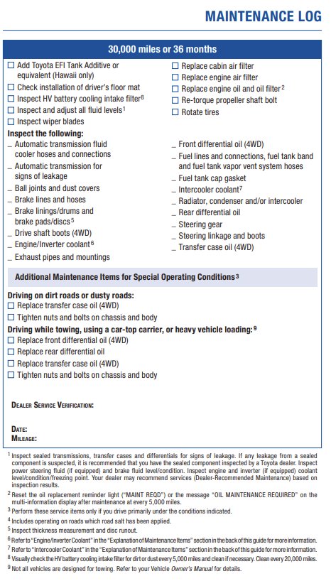

    Do you meet the "Special Operating Conditions"??? If not, then you just need the driveshaft bolts checked. 2wd will be cheaper to have serviced vs 4wd if you meet the conditions.
