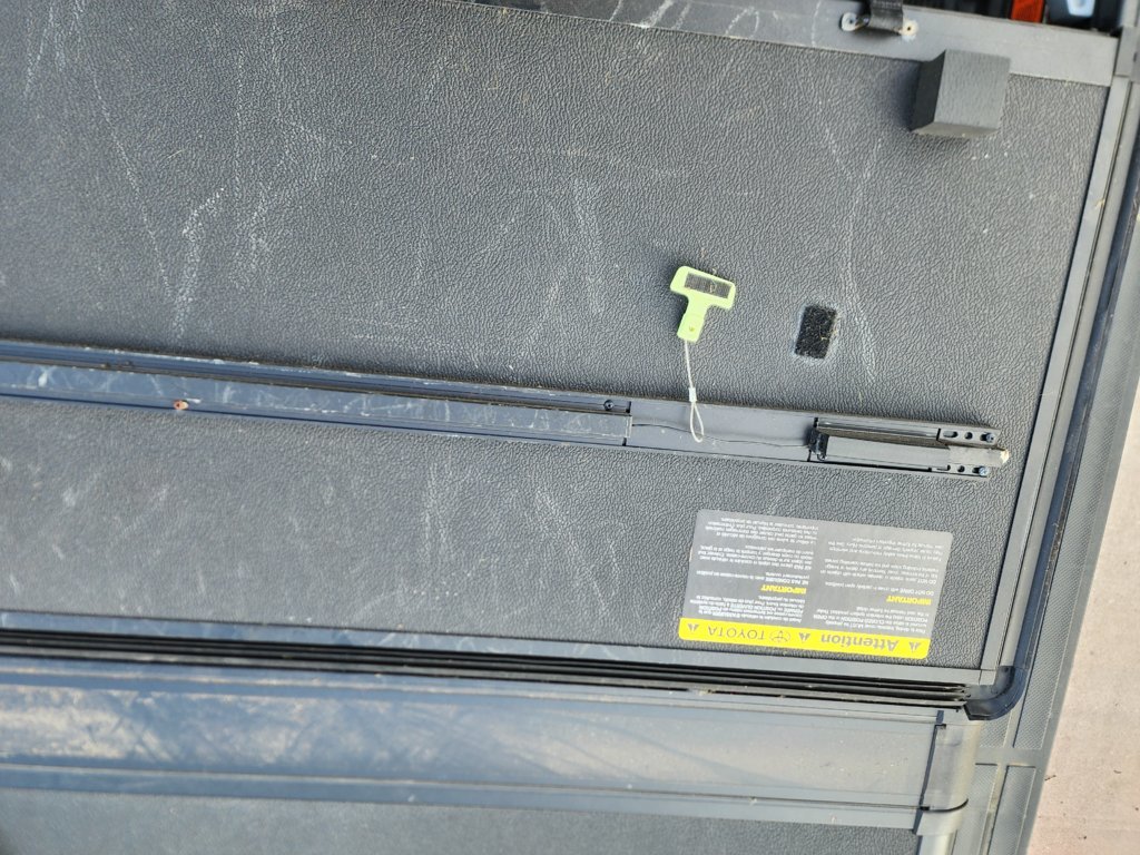

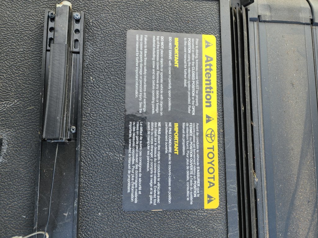

    Hi all! Just picked up a new to me OEM bed cover looks in really good shape, only one problem, it was missing the correct rail system to mount to the truck bed. I have scoured the interwebs looking for the correct parts and so far no luck. Any ideas? Anyone have pictures of an OEM one? Thanks in advance

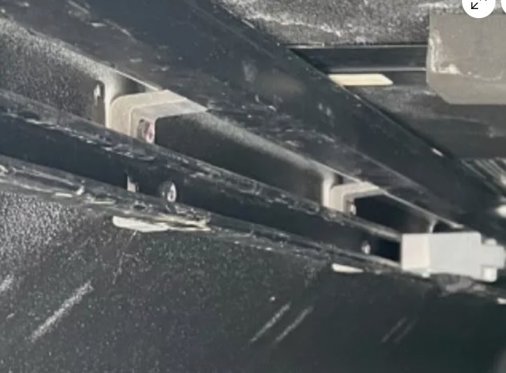

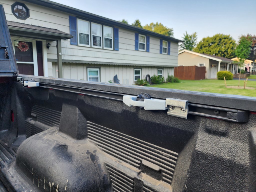

    Looks like I have the standard bed rail system that sits horizontally, the rail system I think I need sits vertically

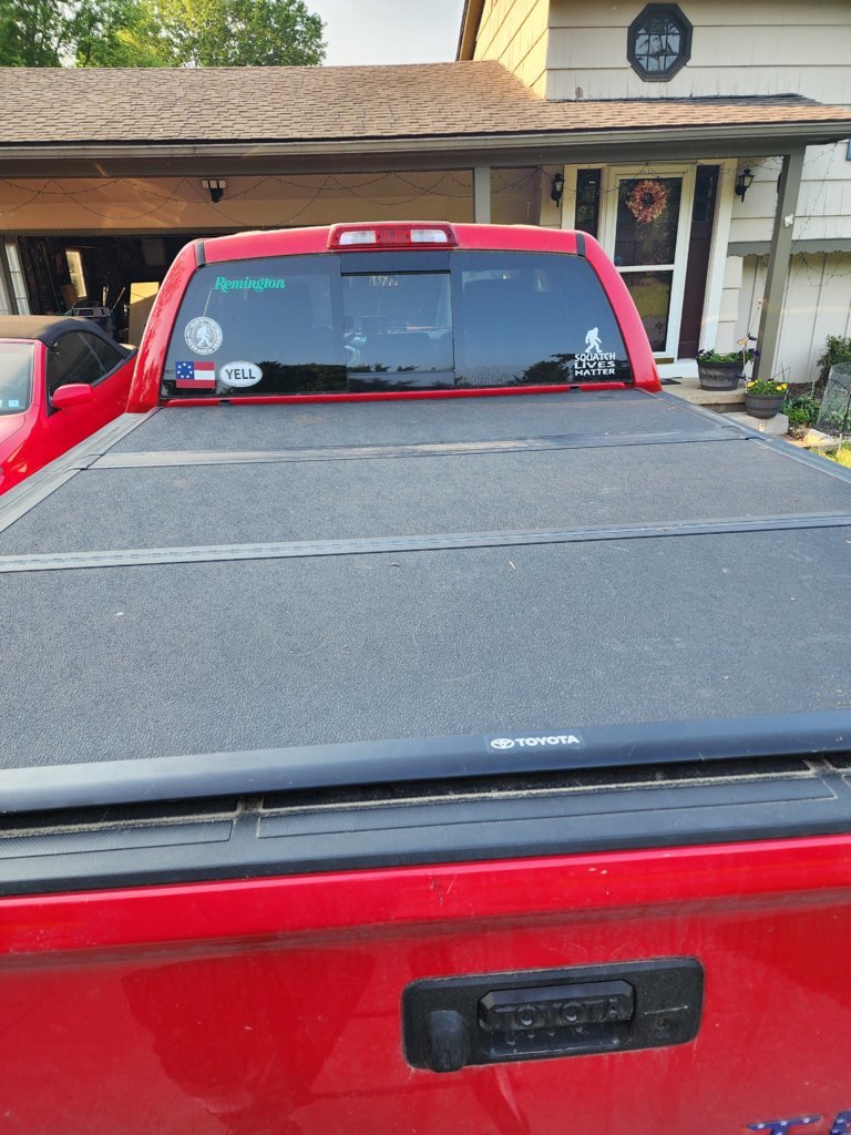

    Dang my truck is filthy

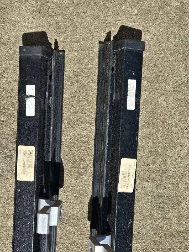

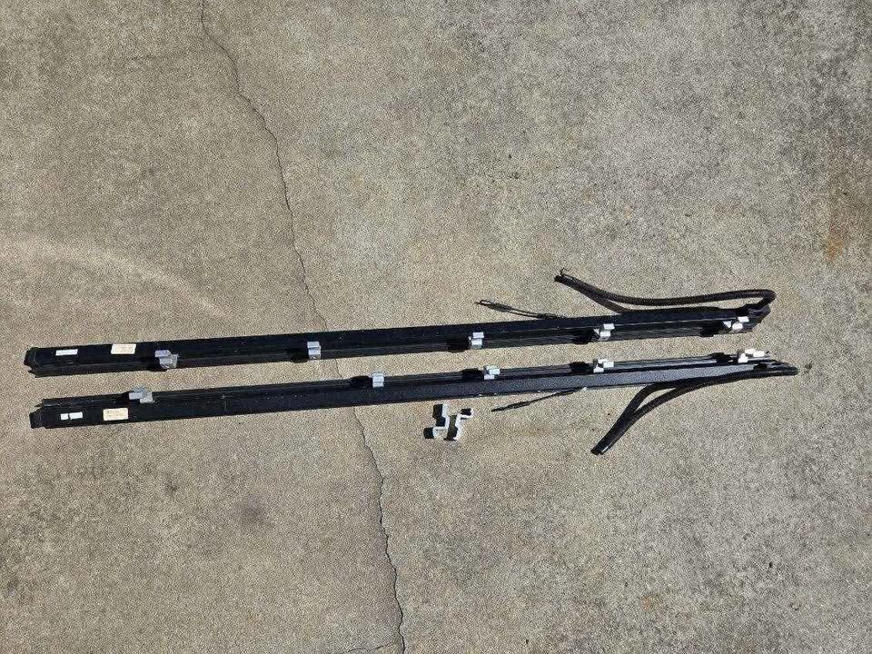

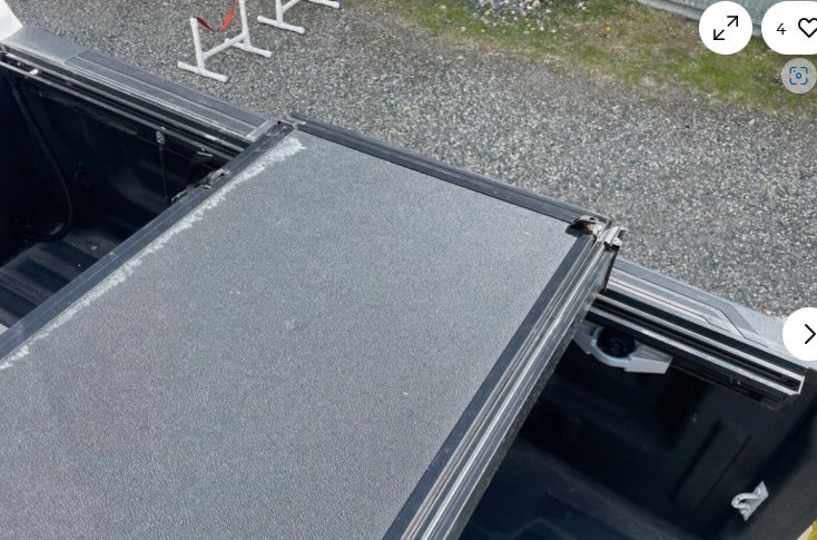

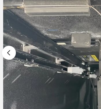

    This is what I think I need but I'll be darned if I can find a part# anywhere.

    I believe this is a system that installs into the original bed rail locations w/'drop down' brackets for the factory bed rails. In other words once the bed cover is properly installed, the factory 'rail system' will sit lower than its original location but still be functional and this will allow the bed cover to be anchored into factory holes and sit flush with the bed caps...

    I think you are right, I'm going to try my local Toyota Dealer tomorrow

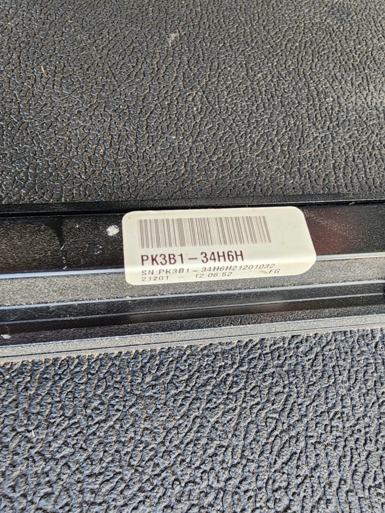

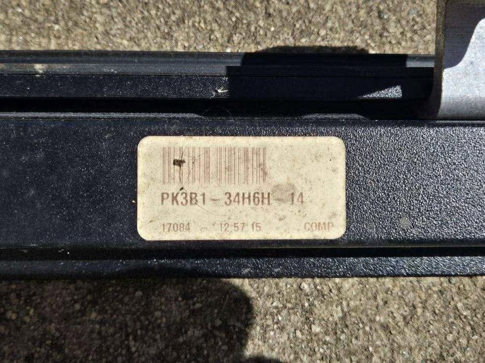

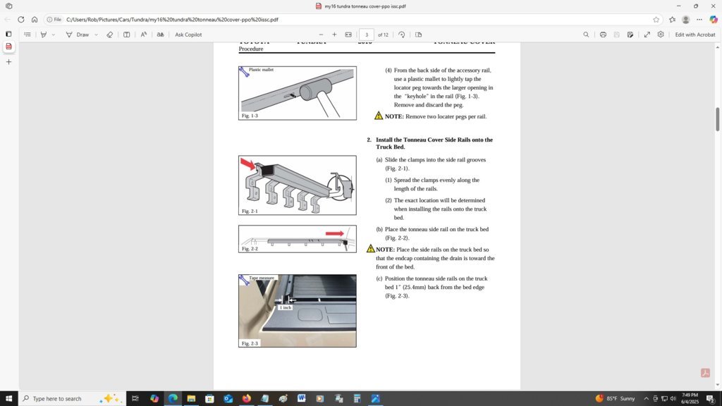

    Ok I'm getting warmer
