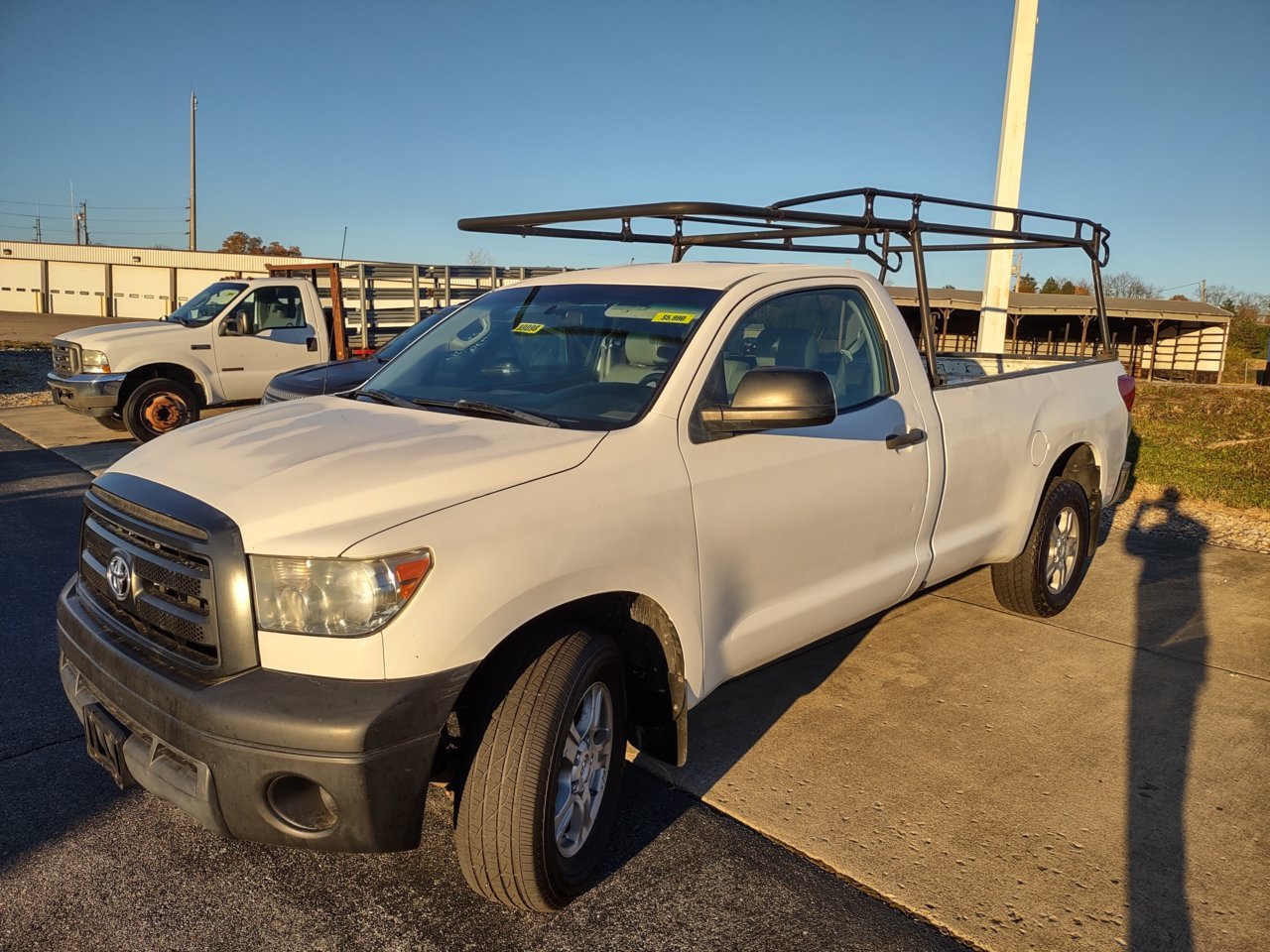

    Hello!
    Maybe I'm crazy, but I recently purchased a 2011 single cab, long bed tundra with the V6 and 300K Miles.
    I don't have much maintenance history other than oil change records from the Carfax every 6,000 miles. Any common issues or items I should immediately replace?
    Thanks!
