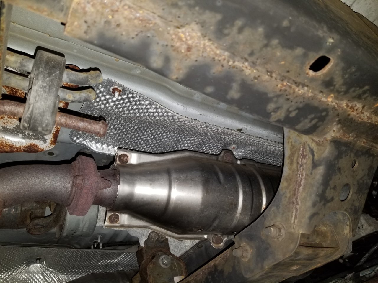

    4. This is the only thing I have found wrong with the 13K mile one, in the picture. This is just the emergency brake that needs to be reattached to the other side, right?

    Welcome! :hattip: Not sure what a "tundra SC" is - do you mean a regular cab? Those are the only ones that came with a full length bed (versus the AC and DC which have a bed just over 6 feet-ish). The powertrains on these are the strong point (4.7L plus the transmission) when maintained well. The frame, not so much. Not sure where your 180k transmission rumor came from...
    Speaking of frames, and not wanting to sound negative, but that undercarriage looks to me like it has seen more than 13k miles.
    Yes, that appears to be the brake cable that needs reattached and adjusted.

    13K???? Thats insane.
    Yes, you have to fix your parking brake. Not only for parking, but the parking brake is what adjusts the rear drum brakes and you will eventually have poor braking without it as the shoes wear down.

    looks like the cables broke. hard to tell from the photo. may need a new cable

    Yes, that's the parking brake cable. I can't see if the hardware is broken at the bell crank or if the crimped on swage is just torn off. If you have the ability to crimp a new swage on you might be able to salvage it. Otherwise, you'll need a whole new cable.

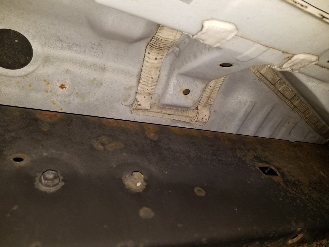

    One more thing: has the frame been replaced on that truck? The small part I can see looks pretty black along with the springs. The rest looks a little rusty. Are you in the north east/midwest?

    I didn't realize not attaching the parking brake would affect the regular brakes.....but if I actually thought it out, it would make sense. The only way it wouldn't would be if it had the old school jeep parking brake where the drum is on the rear driveshaft. Yeah, had one of those and took it out.

    The truck was a florida truck from an estate, thus the low mileage. I figured there'd be some speckles of rust from the salt water spray down there. I live up north, in a salt on the roads state, which is why I bought another one to drive when there's salt on the roads. This one came from iowa, 113K and rust around the rear fenderwells. I figure that's common as that's where snow sits on most vehicles. This summer I'll blast it, bondo and paint it. Probably put some fender extensions to cover up my lousy work.
    On the 113K Iowa truck, when I washed it, pieces of what looked like undercoating came off the frame by the rear tires, so I figure on an 04 they coated the frame and now that's coming off.
    the 13K one, 05. The heat shield above the muffler has a lot of flash rust on it
