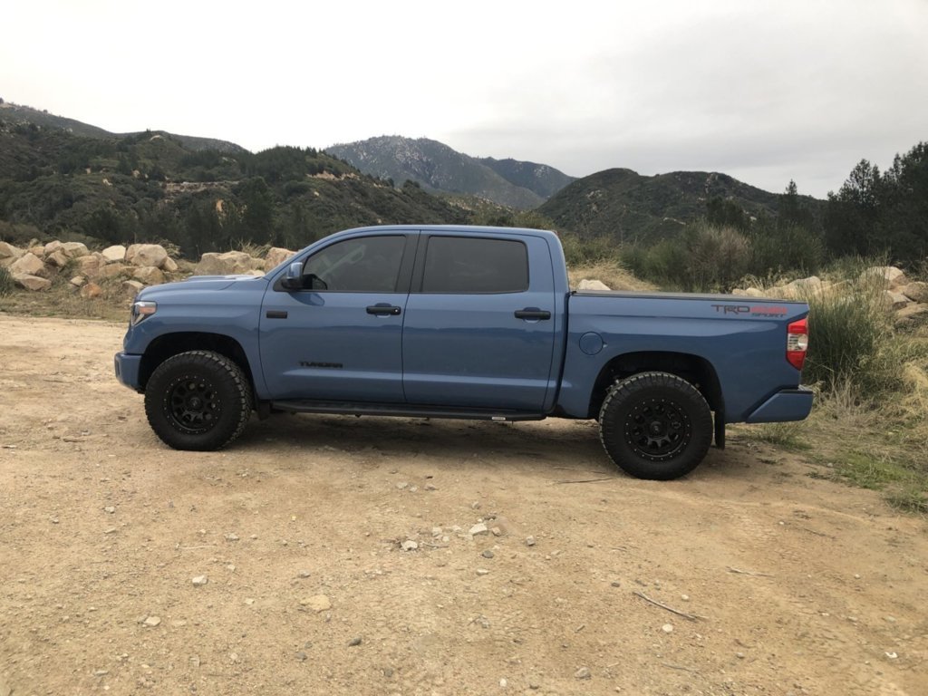

    Own a 2019 with 18”SCS wheels and Nitto Ridge Grapplers with 32,000 miles. For the last 5,000 miles the tires have gotten really loud and the rubber compound has hardened and makes for a stiff daily commute. I’m ready to replace. Also have a 1.9” Bilstein 6112 lift up front, no lift in the rear.
    Looking at Ridge Recons, Ridge Grapplers again and Toyo AT3’s and wondering if anyone is running a 305/65r18 with a similar suspension lift. Do they clear or do they rub? The 305 is 12.2” wide, whereby the 285 is 11.5” wide and make for a nice fit. Feedback and experience with 305/65r18 would be appreciated?
    Here is a pic of my truck on a gloomy morning awhile back with the 285’s.
    -GB
