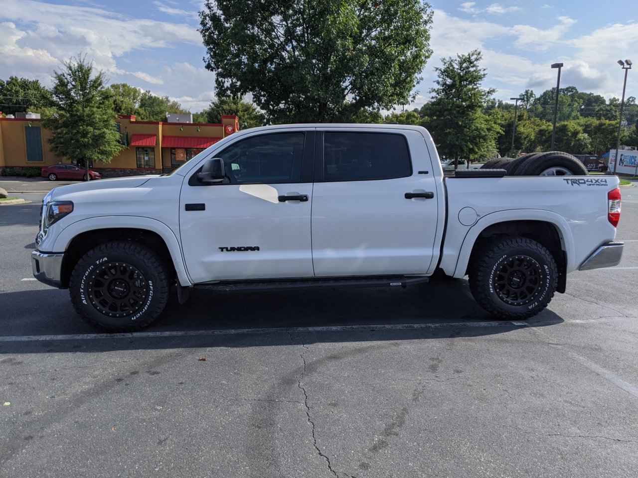

    2020 SR5 Crewmax 4x4 1100 mi on the clock. Bone stock suspension.
    I thought I might try to reach out about my new tire and wheel issues. I am stumped.... Just got 285/65 R18 E1 BFG KO2's mounted on Method 305NV's drove away from the shop and things seemed fine however quickly deteriorated on the highway. from 60-70mph I have a bad steering wheel vibration and the truck wants to drift to the right. Probably oscillating back and forth +/- 5 degrees and my steering loses sensitivity until I either speed up or slow down. So bare with me.... I took it back yesterday, the shop said they didn't get balanced properly. They re-balanced and apparently were having an extremely difficult time getting the tires to balance (took 2+ hrs). When they finished they said they drove it and was not bad. I leave once again onto the highway and it is worse than before! Two of my wheels has 12+ oz. of stick on weights and they double stacked them in two places. Called them back they said this is normal Tundra's are very sensitive to offroad tires and that there is little they can do. I have checked and double checked pressures, torque on lugs, and swapped them around front and back to no avail. I am wondering if since they are lug-centric wheels this could be part of the problem that I may need a hub-centric ring adapter?
    The truck had factory steel wheels with Michelin LTX's which I understand will feel very different than an E range KO2 BUT the truck had no drift and no vibration before what so ever, it drove like butter compared to this. My question is from a standard tire like this what changes do you see in steering? I only can speak from past on my Tahoe and Jeep that KO2's really did not change the drivability much if any.
    I really don't want to change the setup, I think it looks killer. But if I have to go back to a different tire I guess I will if that means I wont have carpel tunnel and numb hands when cruising at 65mph.

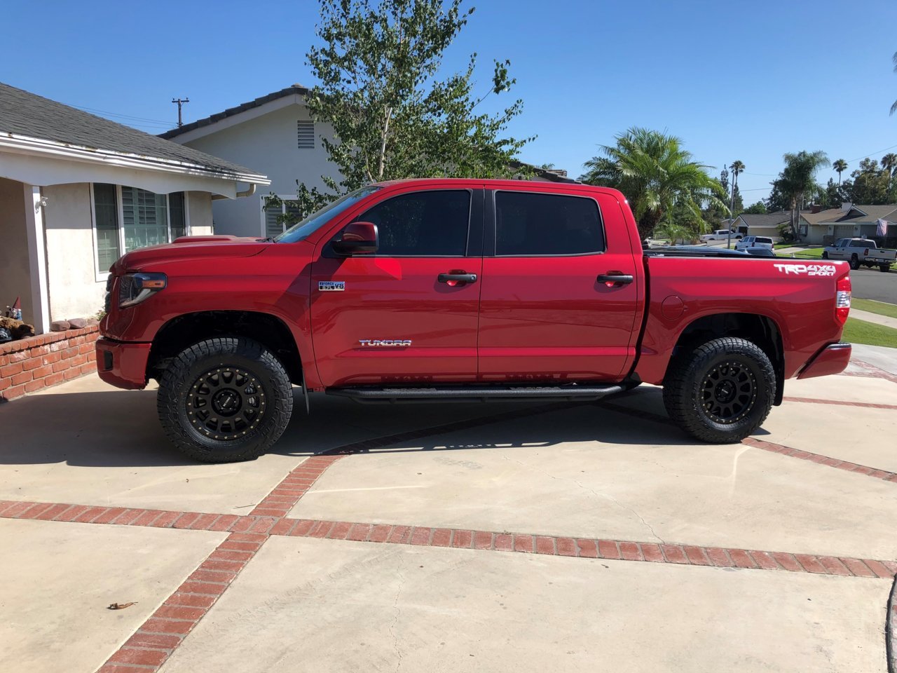

    I have the Falken Wildpeak 305/65/18 on Method 305NV's with no problem.Lifted.jpg

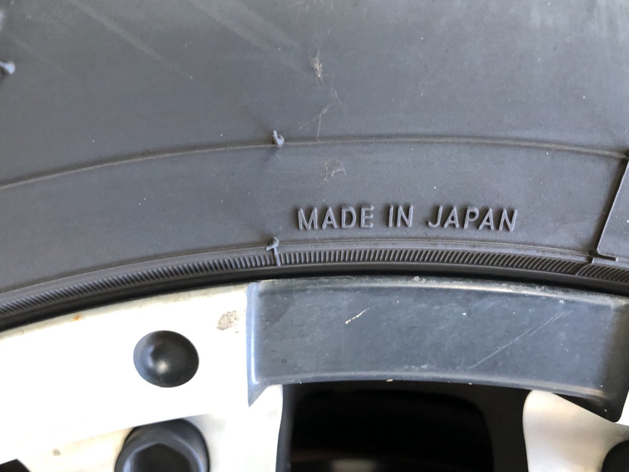

    Nitto is a U.S.A. subsidiary of Toyo. All Nitto’s I’ve bought were made in the USA. Not something you can say about the “American” brands.

    The TOYOs in my garage say Made in USA, but the fact is they are a Japanese company sucks to me but at $202 each free shipping its close enough. I mean I'm driving a Japanese owned truck made in Texas LOL...
