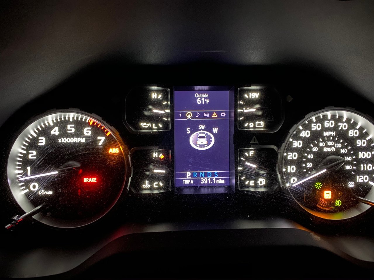

    I have a 2019 TRD Pro. I cracked on of my tail light housings so I replaced both with a pair of Lumen LED tail lights. I have to say the smoked out lenses look awesome. However, I was driving for the first time and all of a sudden my dash lights went haywire. I've included a photo. When they initially did it there were also errors for trailer something or another, ABS, Brake, and LSD failure. After I shut it down and cranked it back up these were the only lights showing. Note: the caution that is showing in the top ribbon is for low wiper fluid which came on before I replaced the lights. I'm going to take them back off and trouble shoot them tomorrow in the light, but I'm all ears if anyone has any thoughts.

    Welcome, that really sounds like a grounding issue .

    I’ve seen numerous 18+ trucks go haywire with the addition of certain aftermarket tail lights. The only known solution is getting rid of them.
