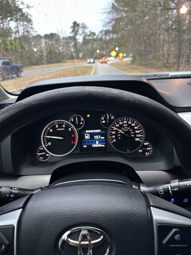

    My foam wheel is worn through at the top. Whats the easiest fix , replace the wheel or cover? Where to get ? Can you get a leather wrapped wheel replacement for the tundra ? 2014 CM

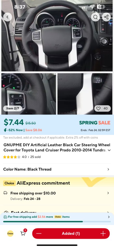

    Definitely not real coming from Ali, some kinda vinyl like 4Runner seats I can imagine.
    I’ve actually ordered some, so it’ll be interesting to see the quality (i will share my feedback). Nothing can be worse than the rubber OE wheel

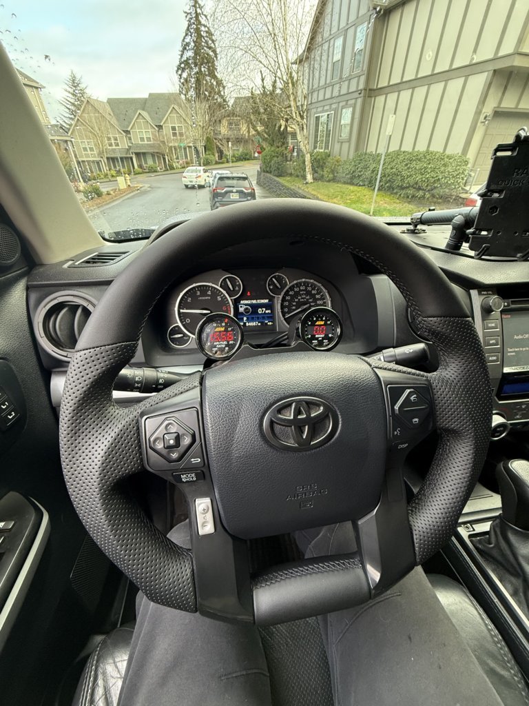

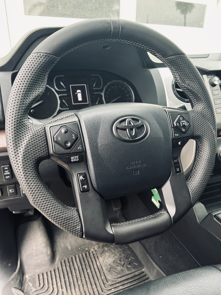

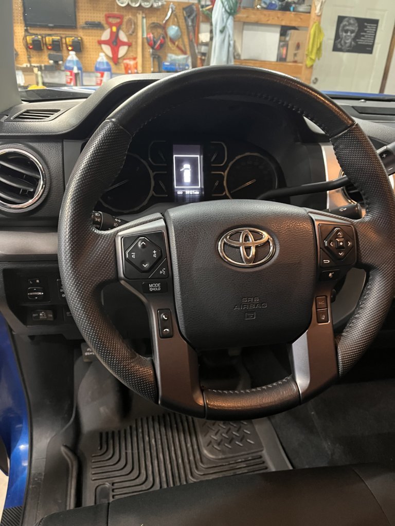

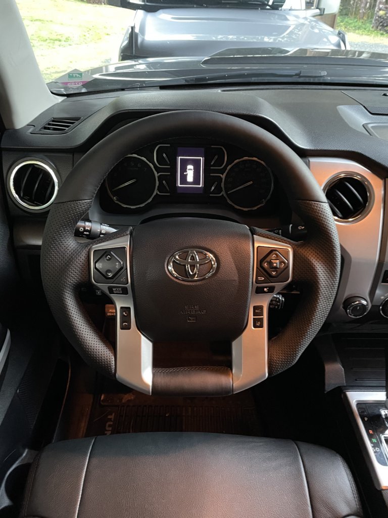

    Purchased straight from Ali for $7-8 and it took me about 4hrs with a break here and there (that was being pretty meticulous about it also).. Very pleased with how it tuned out and the overall quality :thumbsup:. IMG_3715.jpg IMG_3716.jpg

    That looks pretty decent.

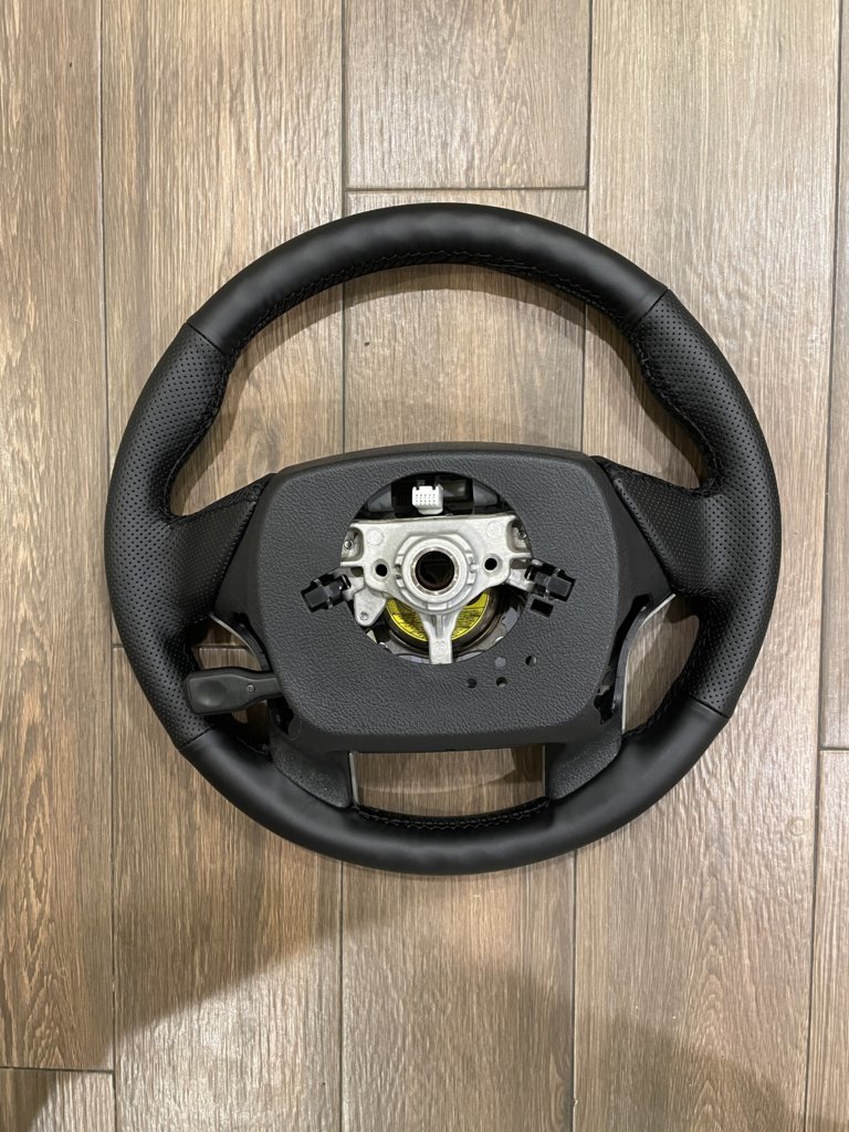

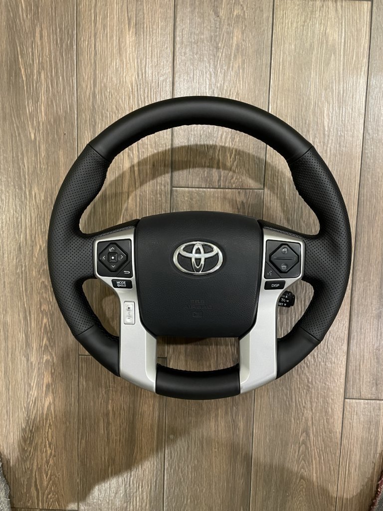

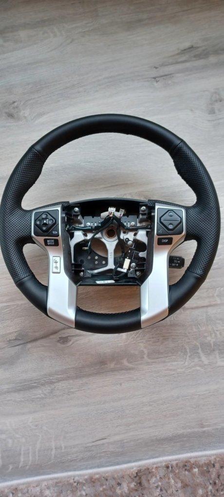

    2022 Tacoma wheel out of the junkyard- you just have to switch the buttons (even if the layout is the same) because the collision-sense connector is slightly different.

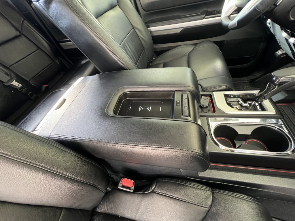

    When I did mine I had a small wrinkle in your picture that I circled. I couldn’t get it out so I applied some sticky hair hold stuff my wife had which I also use for my grips on my motorcycle and bikes. Sprayed a little in and when it was tacky I was able to smooth out the wrinkle. Worked great.
    Best bang for the buck mod. How can you go wrong for $8 with results like this.
    Now you have to do the leather console cover which is about $16 off eBay and the console phone charger for around $32.
