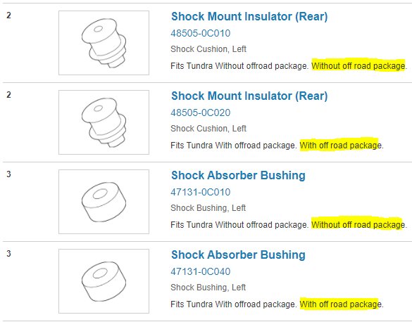

    Looks pretty similar to what I'm finding.
    Since these are the TRD Sport and not the TRD off-road (yellow/blue) shocks, I'd need the "w/o off-road" bushings, as you listed? I'd assume that the bushings fit the shocks themselves and nothing specifically on the truck?

    Also thinking out loud here...if I do need the "non off-road" bushings, I'm not even sure that I could re-use the rear top bushings even if they were in good shape.

    Good point, I’m actually not sure. Hopefully, someone else can confirm that.

    Bushing won’t matter from off today to sport. It’s the same , Good find!

    Interesting convo on the different bushings for off-road vs non off-road. I just recently swapped my stock black shocks for some Bilstein blue/yellow takeoffs and just reused the stock bushings (has no idea there were different ones). I haven't noticed anything weird, but I can let you know if the assembly blows up.

    So I guess that's weird but not totally surprising...they definitely have two part numbers listed for the bushings (off-road and w/o off-road). I'd have no idea what the difference could be though. If they were the exact same, seems silly to have separate part numbers though. But stranger things have happened.
