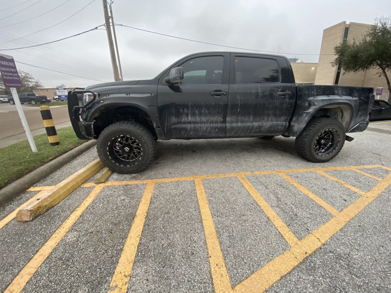

    So trying to buy new shocks for my 2015 tundra and ucas only problem is I don’t know what lift came on this truck I know I got in an accident and they had to replace one of the spindles they didn’t know what lift I had and I believe put procomps spindles for a 6 inch lift in I didn’t think my truck was 6in but can someone help point me in the right direction!?

    And dont worry already ordered new deaver u748 leafs I know mine are done lol

    I would get rid of all of that crap, especially those blocks in the rear. Let me look....that lift on the front looks like a Zone 5".

    Yeah I heard someone else say they thought it was the zone 5” lift. so what are some suggestions?

    Also I plan on getting rid of the blocks I have camburgs 1.5 shackles and deavers u748 2in lift springs but wanted to find shocks first install at the same time if you look at my cvs angles aren’t terrible as a lot of lifts Ive seen and didn’t really want to go any taller

    What lift and tire/wheel size are you wanting to run? What do you want to use the truck for. There are so many options.

    I want this truck more for trail use Nothing crazy like rock climbing or going through Crazy deep mud holes right now I have 37‘s on 20x12 truck handles rough but I’ve had the same shocks on since I bought the truck in 2016 just wanted to upgrade

    So the shackles and springs together will give you 3.5 in the rear? Others will chime in but I'm thinking 3 inch coilovers in the front. Those will put you just a hair over 3 inches in the front and maybe a slight rake in the rear if not closer to level.

    Update: so I installed my deaver u748 and 1.5 camburg shackles threw out the blocks also was told by bds the Fox co’s for their 7in kit would fit with the zone 5 I ordered got them in Friday. night and day difference don’t feel every rock on the road anymore and sits little higher front and back
