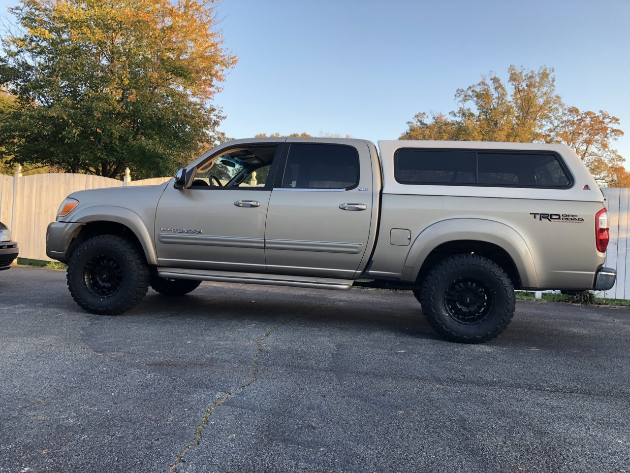

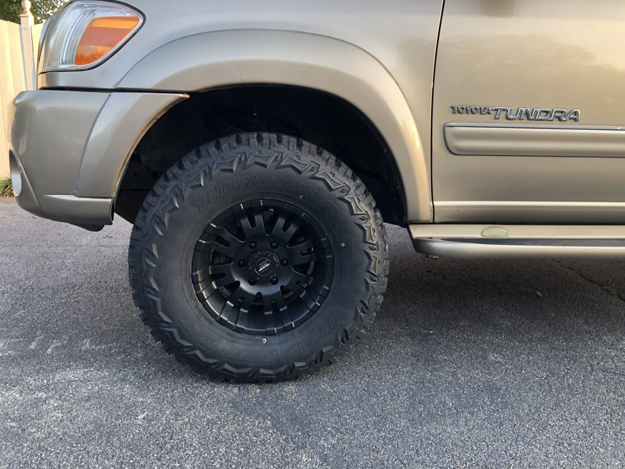

    2” level 285/75R17 Falken wild peak RT 34.1”x11.5” bilstein 5100
    I fit 285/75r16 with mud terrains and billies adj. on the 4th clip (highest you can go on double cab 4wd) and no rub!
    Full disclosure tho in the fall I’m BC86546F-DEBA-4AA4-87EE-7D8BF20D6220.jpg 71791728-D4C1-484E-B82D-756B9E2E29DF.jpg 71791728-D4C1-484E-B82D-756B9E2E29DF.jpg 71791728-D4C1-484E-B82D-756B9E2E29DF.jpg going to put the billies at stock and do a 1.5-2” lift with springs. The ride suffered a little the way I have it. Probably go to a A/T tire also.
    I’d say do it all at once so you aren’t getting it aligned twice.
