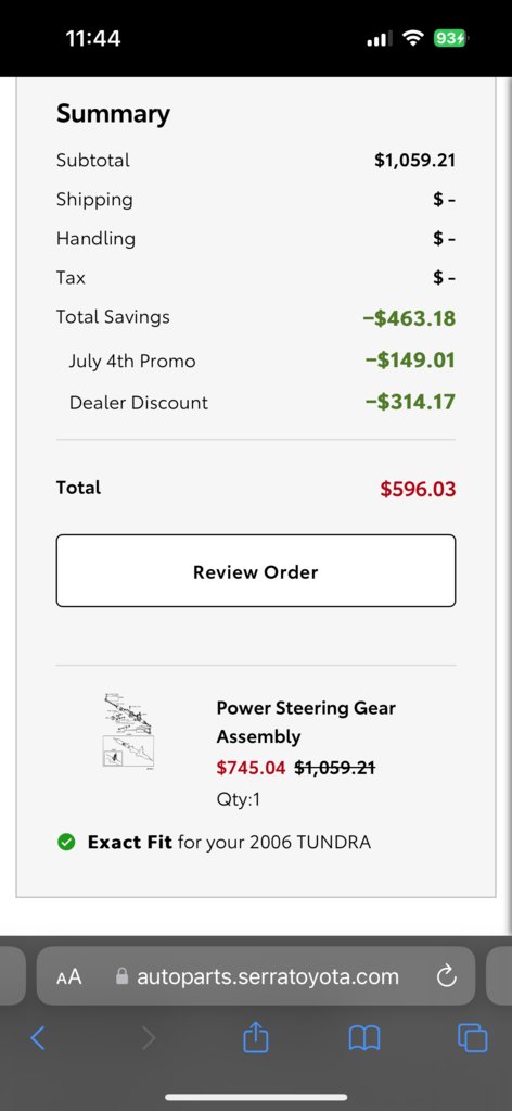

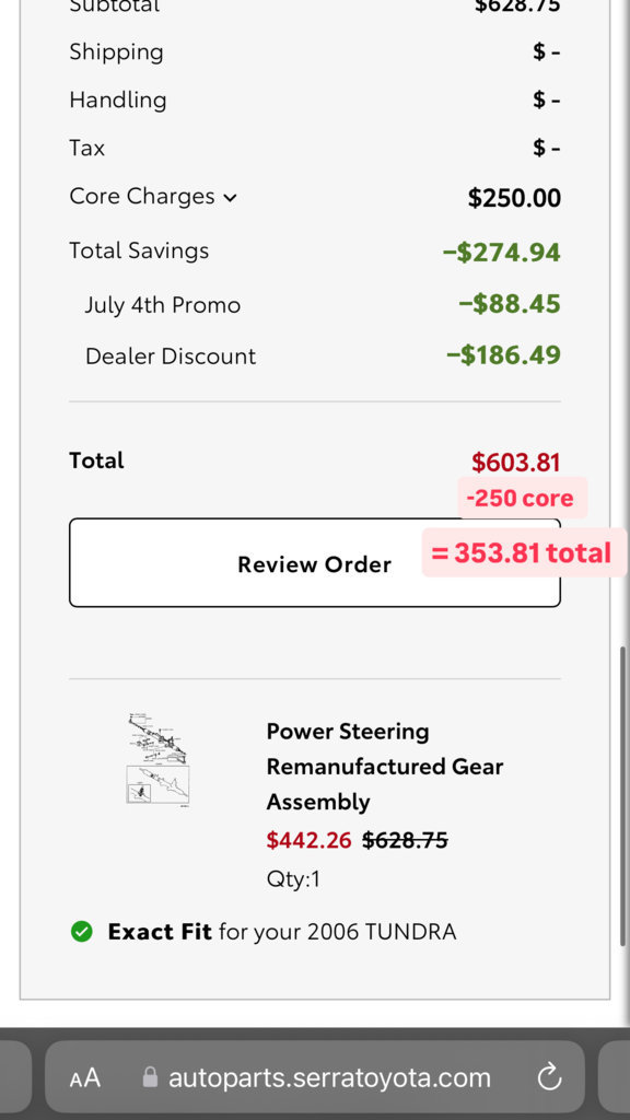

    Thoughts on if it’s worth the extra $250 for a new rack. Or if the remanned from toyota is just as good. Serra has a good deal with a 20% off and free shipping going on, so you can get a new rack for $600 shipped or a remanned for $350 once you send the core back.

    Remember that the free shipping does not apply to you returning the core, so there is that to factor into it.
