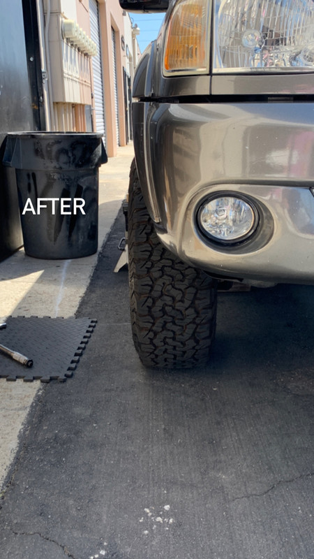

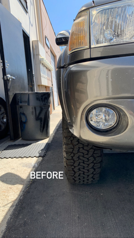

    0 offset 285/70/17 on method nv305
    before no spacer after with spider spacer 1.25.
    I did not end up running the spacer because it push the wheel out to far and required more cutting that I wasn’t comfortable doing myself. Spacer we’re on the truck for about 5min

    Looked good with the spacers Jerry. What did it rub on?

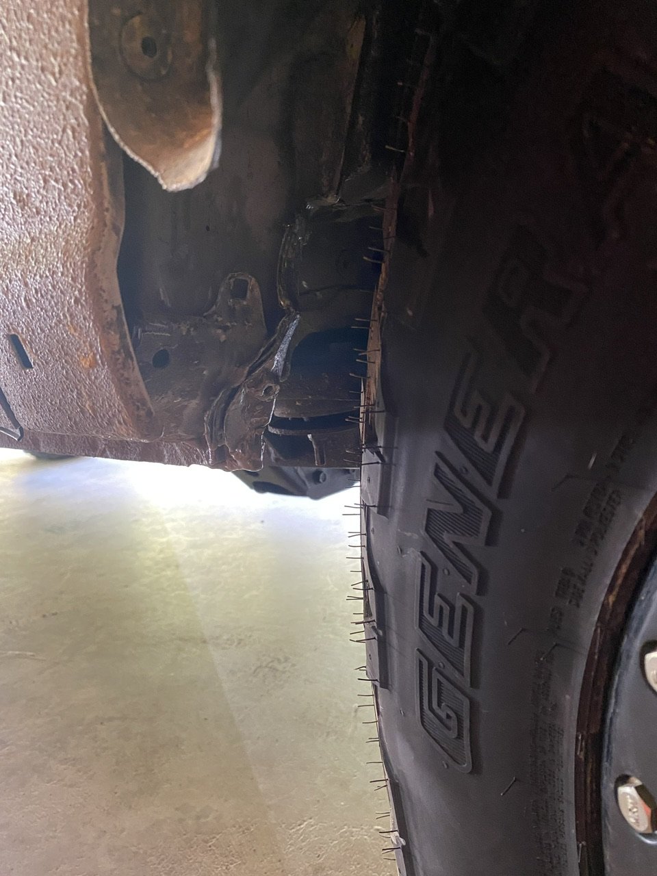

    Rubbed the fender flares off the clips and inside supports
    you can see how much I’ve cut away already. Right up to the bolt. Iv since cleaned it up, you can also see the frame rub. Iv learned to live with the frame only rubbing at full lock to the left.
    Love the look with spacers it was just to wide and rubbed a lot.
    I noticed double cabs 05-06 and smaller wheel, wells and other years and AC

    It rubbed the frame with the spacers?

    The frame rub is with no spacers. With spacers on you eliminate the frame rub but push the wheel out that you rip the fender flares off and rub around the body mount
