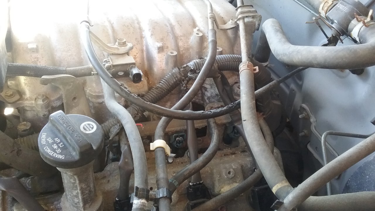

    Thanks everyone! Going to give it a go. Can't make it any worse I hope. I'll try to post a picture.20171201_115325.jpg

    Looks to me like the pigtail to the injector was chewed off not the coil. Also, that's pretty close to the plug so make sure you still have enough wire to work with if attempting repairs.

    20171202_094600.jpg Thanks to all for your help! If it warms up today I'll strip off some of the wrap on the wires for further damage. Does anyone know what the circled connector is or does. The only thing left was the clip on the pigtail (I removed it). I think it connects to the circled wire on #1?? Thanks again, Jim

    That looks like a Vapor Canister Purge Solenoid, Toyota Part No: 2586050100
