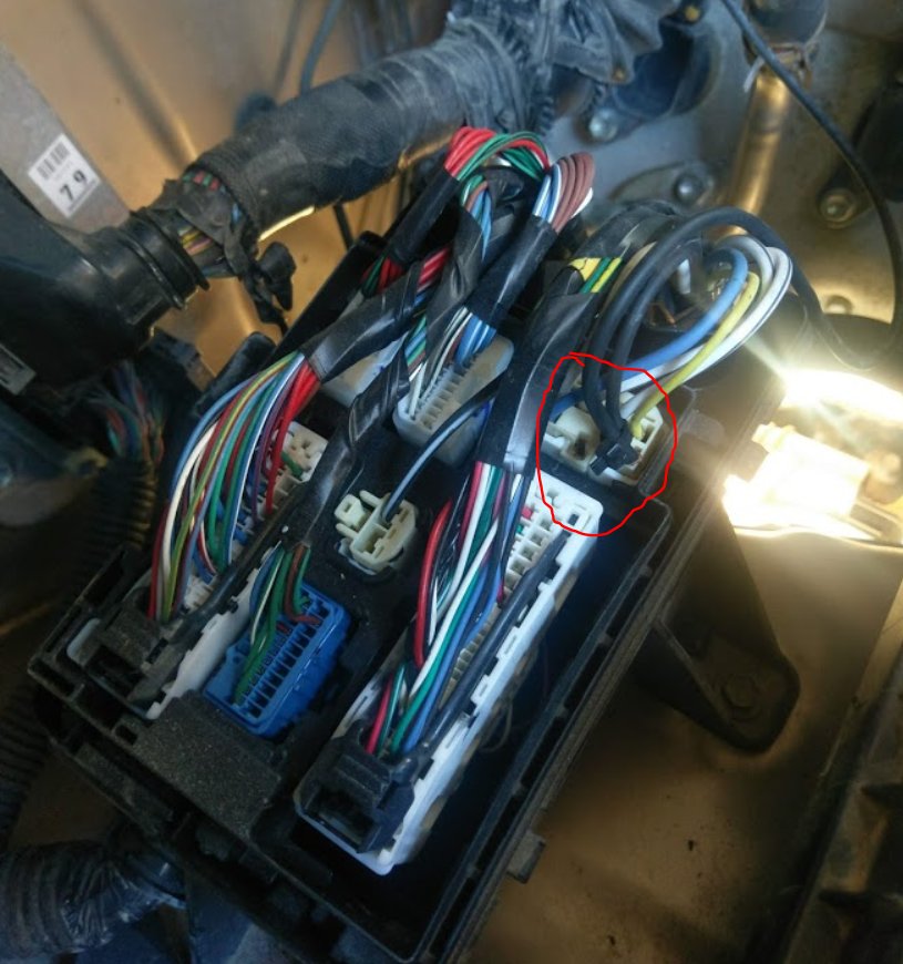

    First question if anyones watching, what's this electrical connector here go to? I've found the electrical diagram pdf but it doesn't show general component location to identify connector number. This is located on the passenger side of the engine bay close to the firewall with a plastic cover over it. For some reason I have a power jumper ran across my engine bay to the pin with the black wire on the connector circled and trying to figure out why.

    On that wire issue, I'd get out a 12 volt light circuit tester, hook the clip end to ground and probe that wire. See if that wire is hot with ignition key switch on/ off. Hot with battery only, key off. ? Mabey look for something aftermarket installed on the truck? Follow the wire / wires, tract it down to see where it/they goes. That plug, next to the tie rap, looks like some wire was there? Typically if its a blank you wont see something in that hole. Did the wire next to it brake off and the old owner did what he needed to make things work. Contact the old owner and ask questions if he knew anything about it.? Aftermarket lights, trailer brake module installed? I'm just guessing at this point. Good luck. Welcome aboard too.
