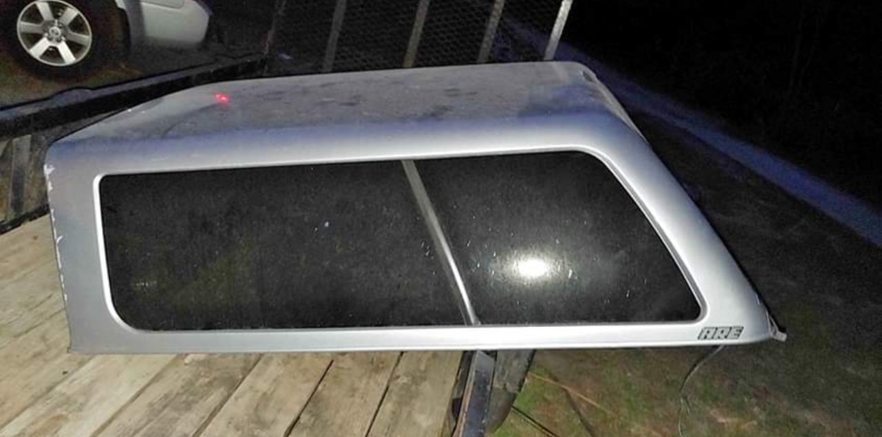

    Here's the cap, it's not perfect but at that price I don't expect it. I can do paint touchups and fix a window.

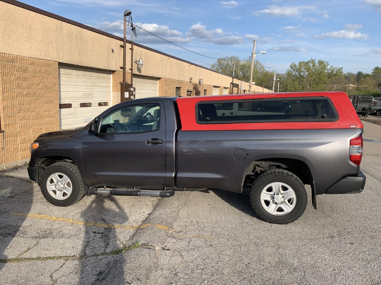

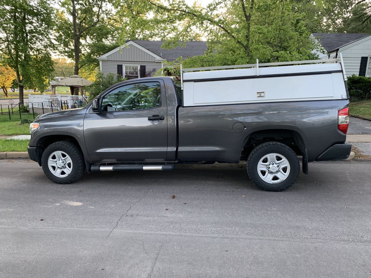

    No problem,I paid $100 for the red one and about $20 for the aluminum L channel to make it fit and my plan was to paint it with black bedliner,at least before I fell into this commercial shell and bought it too!?
    This one is for a Ford F150 with a Long Bed and is about perfect too or at least as a work truck it is perfect!
    The ARE Fiberglass have a contoured fit on the rails that is nice though this one will work better for me in the end.
    A friend is going to try the Red one on his F150 and the circle of life goes on!
    Good Luck

    42,441
    The topper tag clearly shows it's for a 2013 Toyota Tundra "DC". My A.R.E. has the sane "DC" on that tag...but that topper sure looks short for a DC
