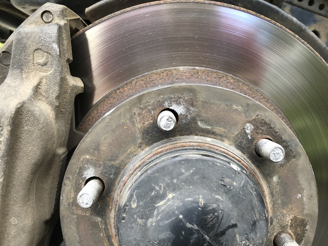

    Dust shields weren’t it. :frusty: I’ve never paid too much attention but just noticed this. Seems like the rotors should be centered on the studs? Should they even be able to be off center by as much as they are. I couldn’t easily center them and didn’t. Put the wheel back on after checking and messing with the dust shield and the sound is still there. Was going to take a dead blow hammer to the rotor to get it centered and see if the at fixes the problem. Anything else I should be really looking at?

    that picture i dont see anything wrong with the rotor. they dont sit perfectly center unless you get them there. but once you remove the wheel its going to move a little bit.. the wheel is what holds it tight to the hub
