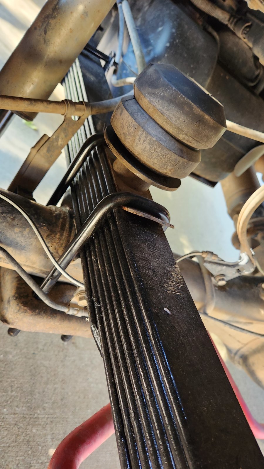

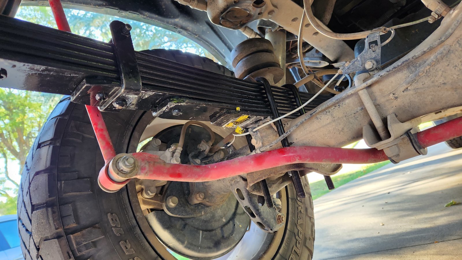

    So replaced rear leaf springs an now truck pulls to the right. What do I need to inspect. Truck had perfect Aliment before the springs where installed..19 tundra limited

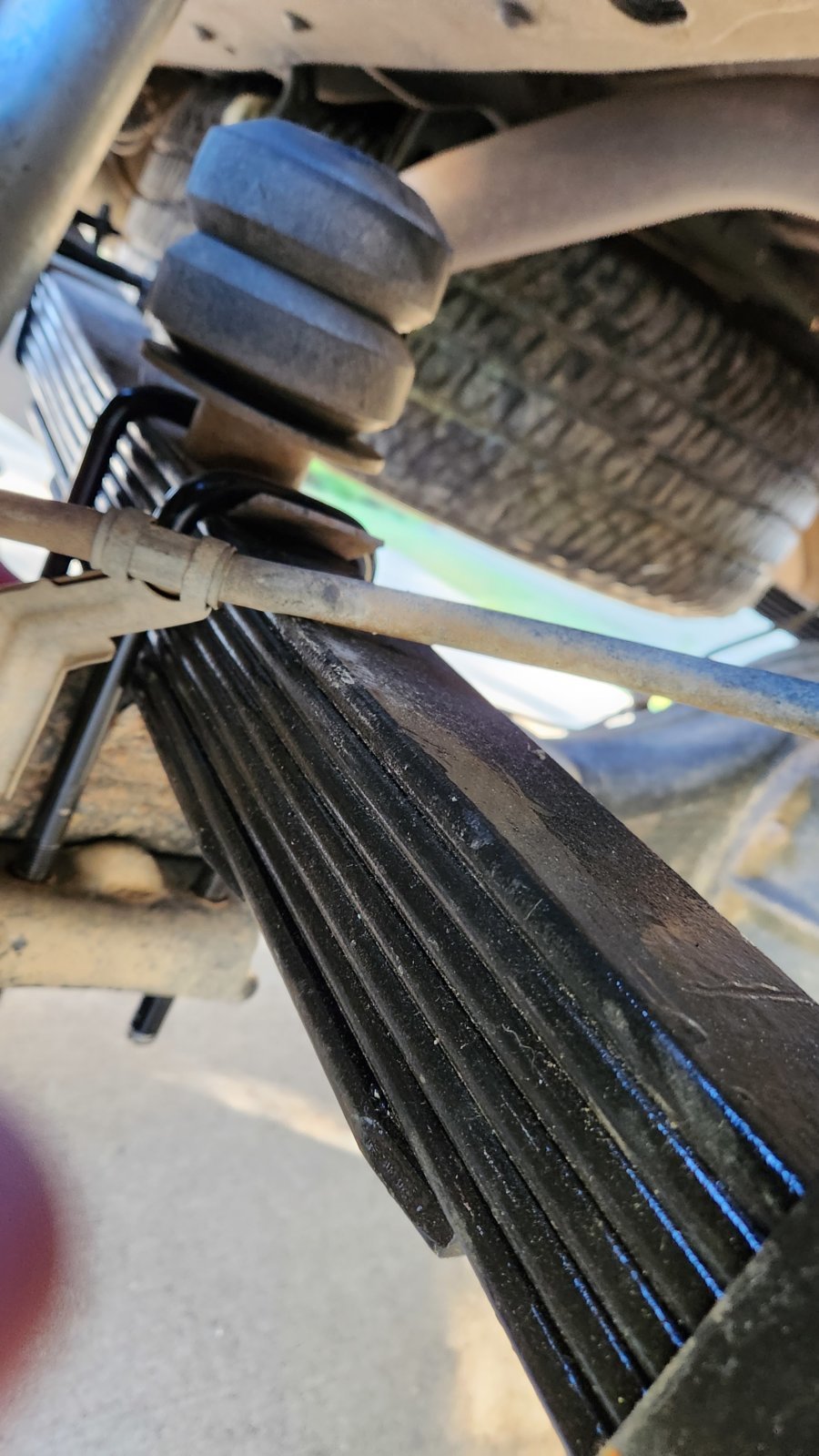

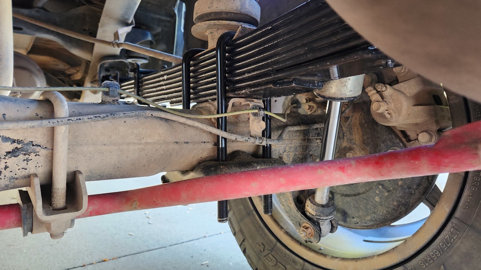

    Can you post pics of where the springs are sitting on the axle? Although I think you would have noticed if the guide pin wasn't seated in the hole.

    Best I could

    Did you do the work? Do you know if the guide pin on the bottom of the leafsprings are in the same position hole on the axle? There’s 3 hole to choose from, the middle one is where it normally is.

    I don't see anything that looks out of place. Are those Alcans? Luckily I didn't have any issues with mine other than creaking noises. I think that's due to torque settings not being what they need to be.

    I have the Alcans on mine. If I remember correctly, the guide pin will only fit the center hole, but I could be wrong. It's been about a year or so since I did mine.

    Judging by the sway bar, it looks like you added some lift with the Alcans - if only an inch or two? This effectively change the castor and can make an alignment issue more noticeable. It may have existed before but is more pronounced now. Either way, have the alignment checked.
