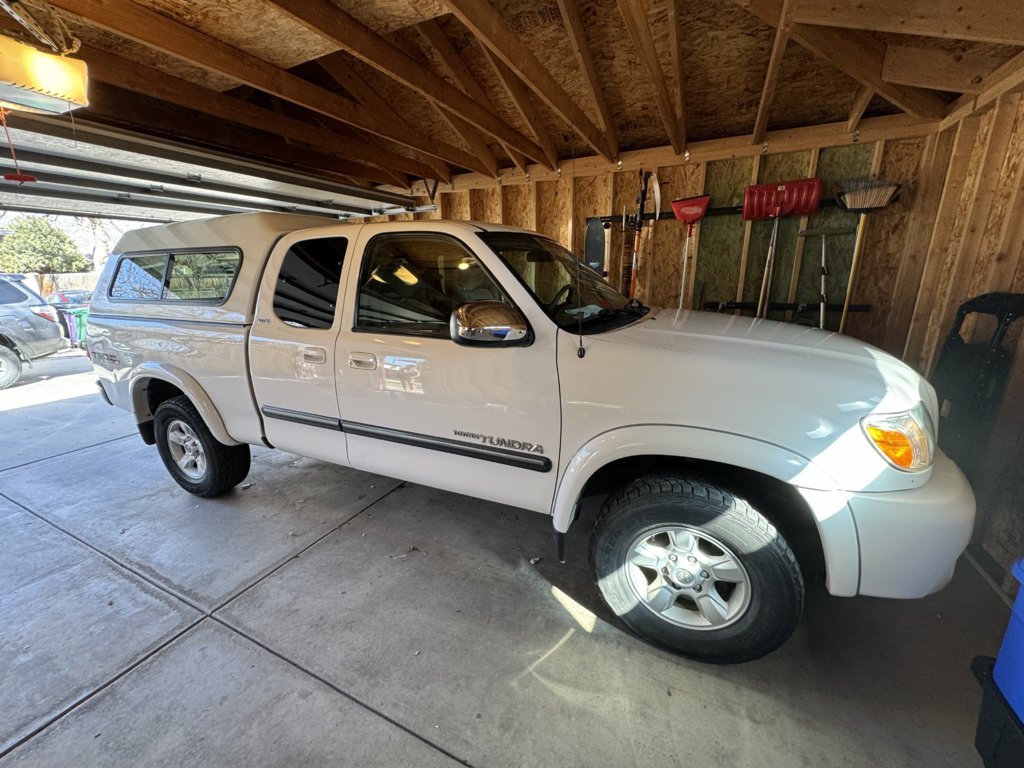

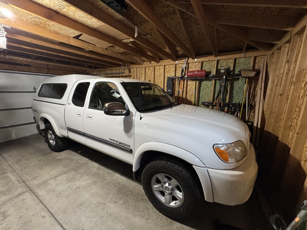

    Sorry if my post was confusing. I got the standard leafs not the HD as I did not want lift so I could fit in my garage and was afraid lift would prevent that. Part number was: 2000-2006 Toyota Tundra 4wd Rear Leaf Spring Complete Kit BT90221CK.
    The 5100s were only installed on rear at this time. Part number from rock auto:24100144.
    I did not get measurements before and after and am kicking myself for that now.
    Here are some pics from when I bought the truck and now after new leaf install. Garage open is stock and garage closed is new set up in rear. I can get better pictures from a straight on a little later.

    And as for now, after installing the new leaf packs, what are your measurements from center-of-hub to the edge of the fender flare, taking into account the wheels are inset differently up front and out back?
    I'm just curious if you're sitting lower out back or not. The HD springs are variable in how much lift they'll give you. I want to say, at present, after a lot of time to settle, with my camper shell on, I might've gotten 1¼"? I feel like @KNABORES said his springs (different company, same part number, I think) got roughly 1", with the shell installed. So it's not a tremendous amount of lift with the HD, but they take a substantial amount of weight before starting to squat by any reasonable amount.

    @shifty` Just measured and it appears rear is sitting at 22 inches from center cap to edge of fender flare. Front is sitting at ~20.5 inches.

    From the thread you linked, here were my stock numbers at around 70k original miles, with a BAKflip cover on the bed:
    Before suspension mods (gas ~1/4 tank):​
    Front D: 20.5"
    Front P: 20.75
    Rear D: 21.75
    Rear P: 21.5
    He installed OEM-compatible springs and got OEM+ numbers. Actually the rear is probably a little stiffer with those springs, it's impressive it's sitting higher than my OEM springs with a shell on the back.
