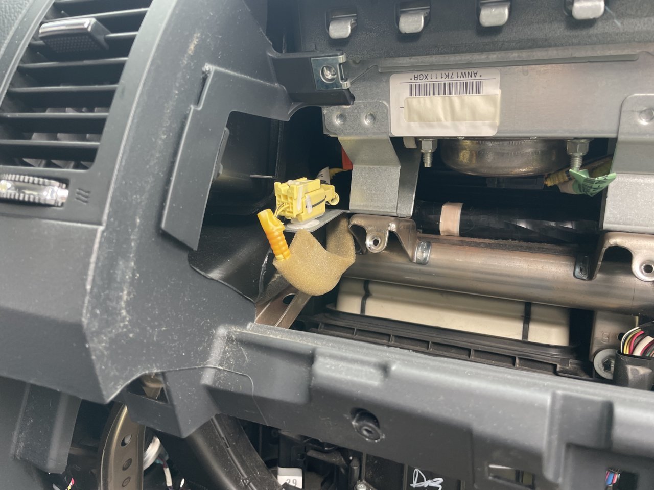

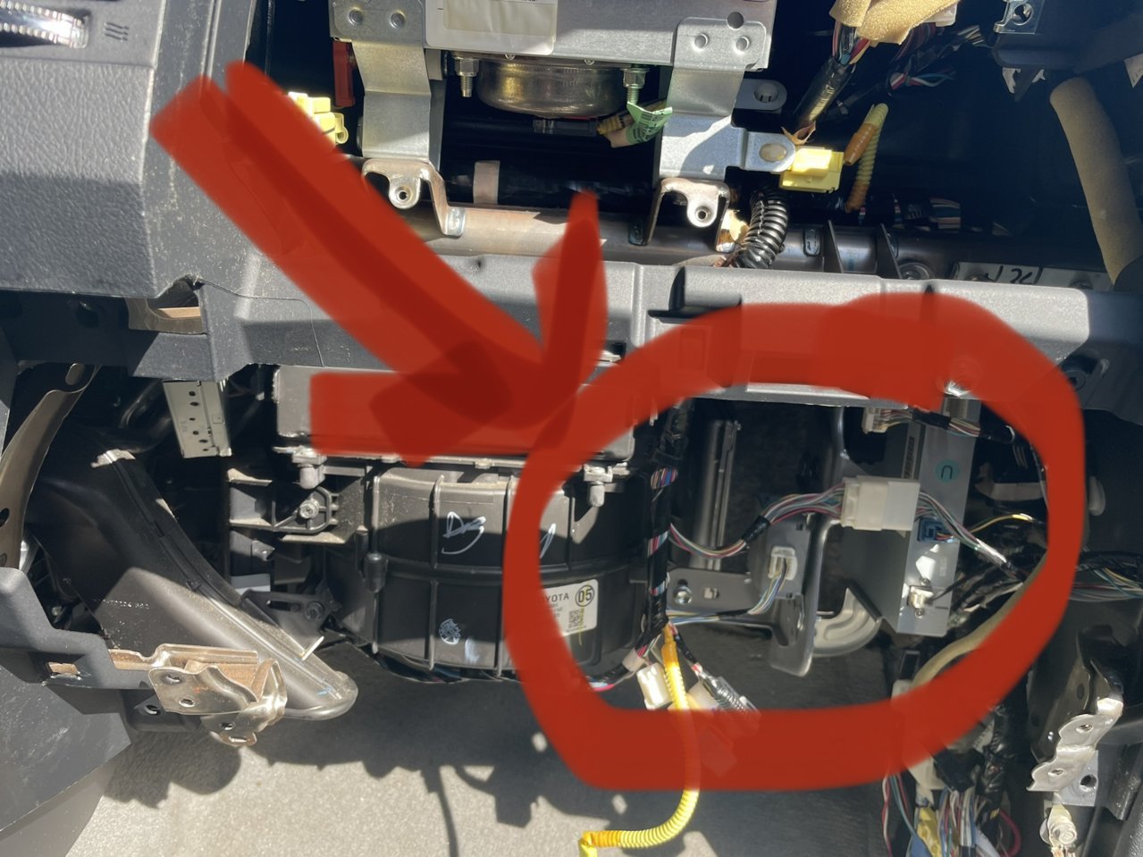

    New guy here. Love my Tundra and Toyotas in general. Currently attempting to replace Body Control Module (part number 896700C011).
    Have removed everything on the dash and can’t find this part on my truck. Seems crazy. It should where I identified on the picture.

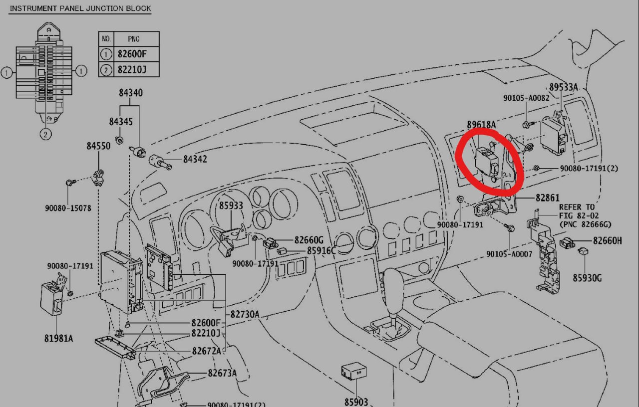

    A few... Definitely more than 2

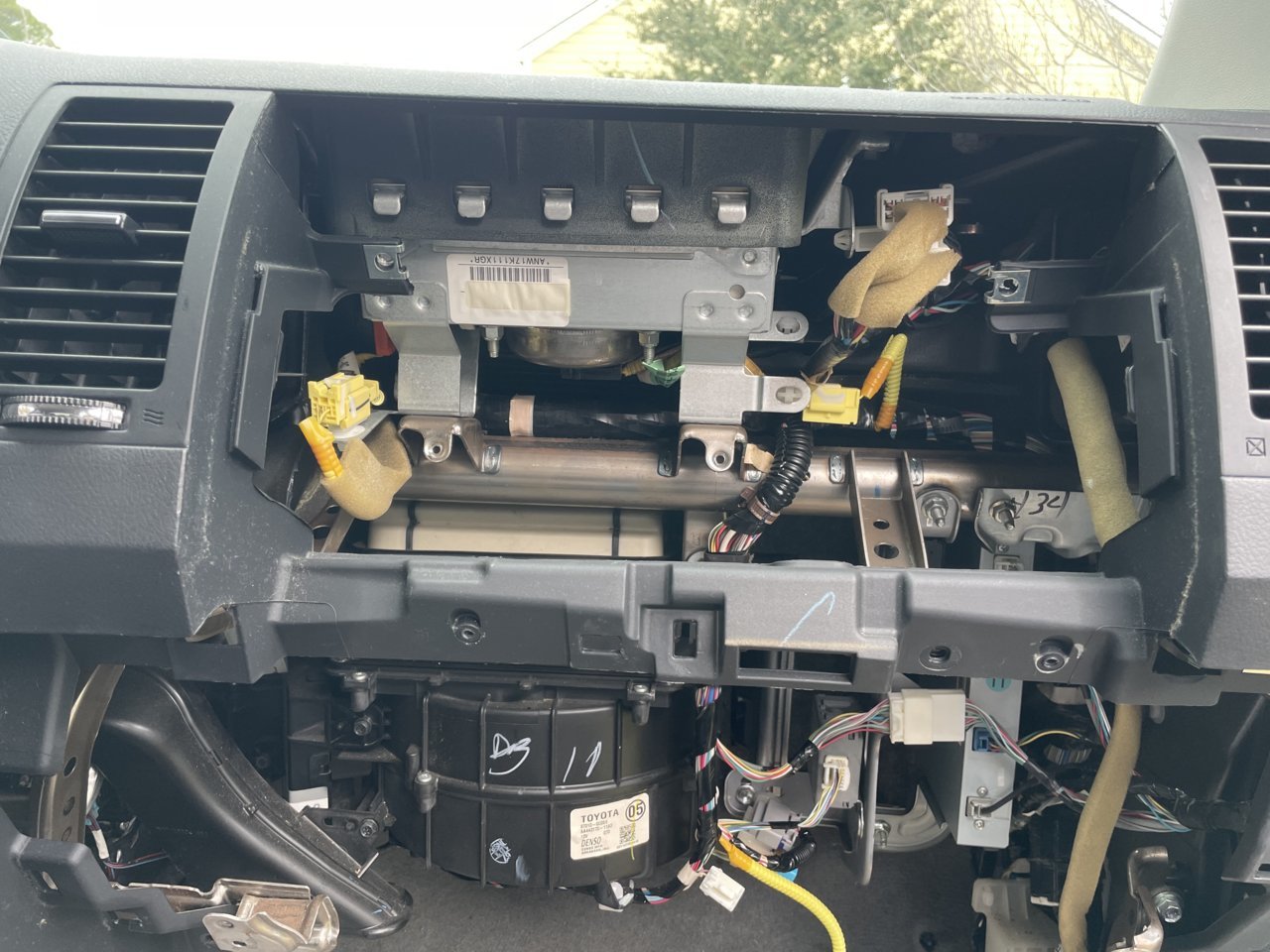

    @APalmTree -I really want to be embarrassed that I overlooked this and get it installed :)
    Unfortunately I have become very quick at disassembling the dash-LOL!!! Thanks for the reply!!!

    @APalmTree -you are right it’s not that easy. It’s not there. What generation Tundra was that diagram for

    That diagram is a 2nd gen. The 2.5 has a different cluster layout and the vents are circles

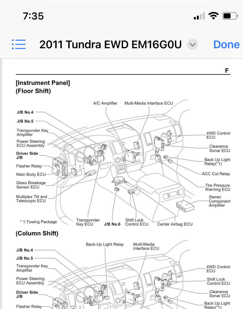

    Update-the EWD I found on this forum indicted there is no Body Control Module. The Toyota parts website indicates there is when I enter my VIN. This is becoming soo contradictory.
