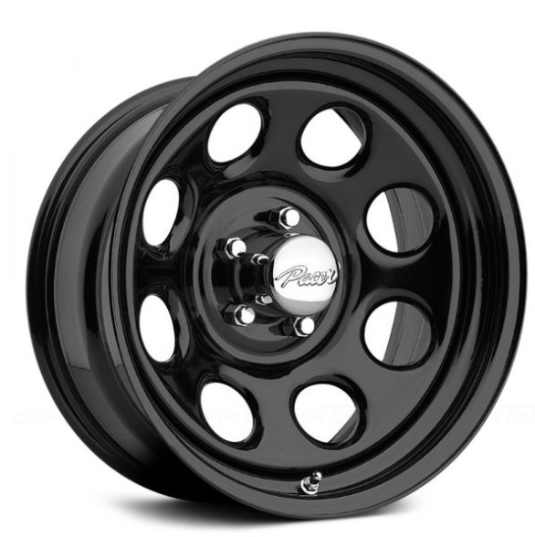

    I'm looking for options with rims. I've decided to go with steel rims because a few reasons.
    -steel is about $90 while alloy is $280+ per rim
    -damaged alloy cracks easier where as steel will bend, just bend it back, and if replacement needed, its about $90 and not $280+ per rim
    -from what I've seen, weight isn't a big issue and if fuel mileage is an issue, then you probably don't want a truck. Even still the weight isn't much considering the tire is most of the mass.
    But I cant find any steel rims that aren't oem steel or spare tire rims.
    Looking for help and not opposed to having my mind changed.[​IMG][​IMG]

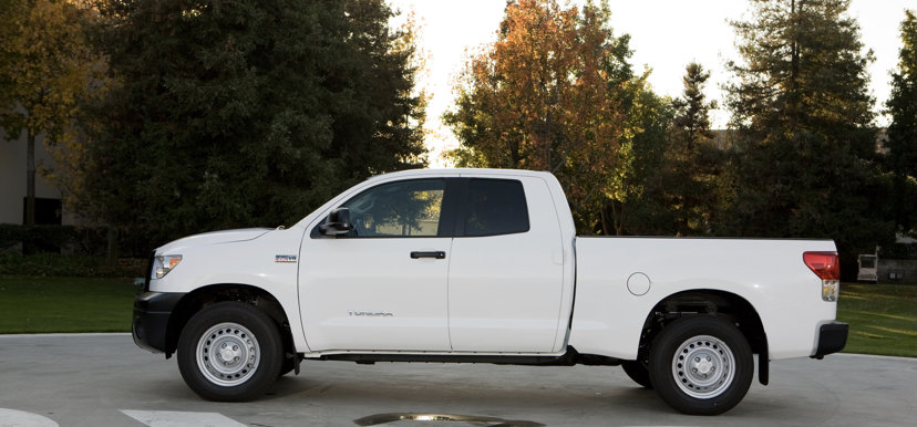

    The styled steel wheels of the tundra are actually nice looking

    This is a stock image online, not mine.

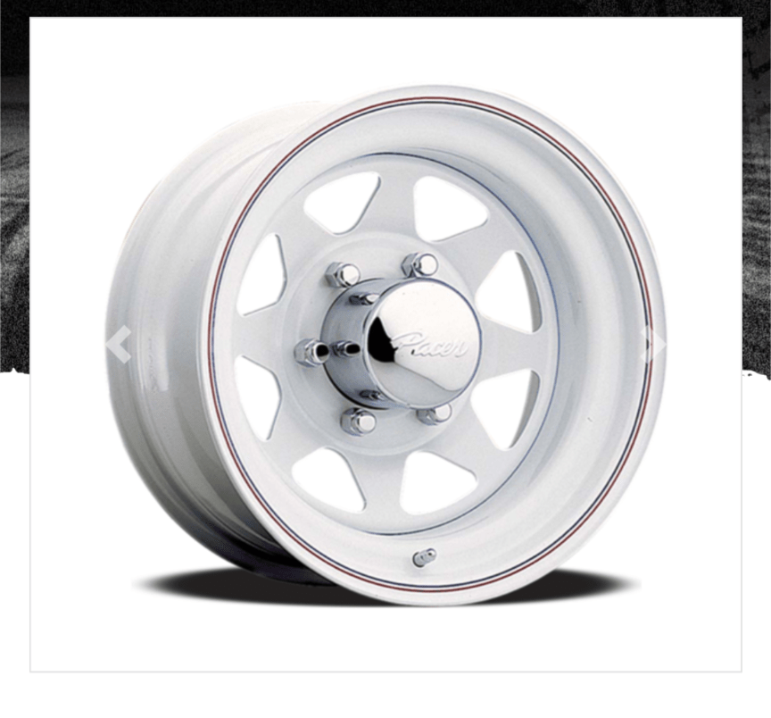

    Go old-school white steelies. $85 each.
    Available in black also

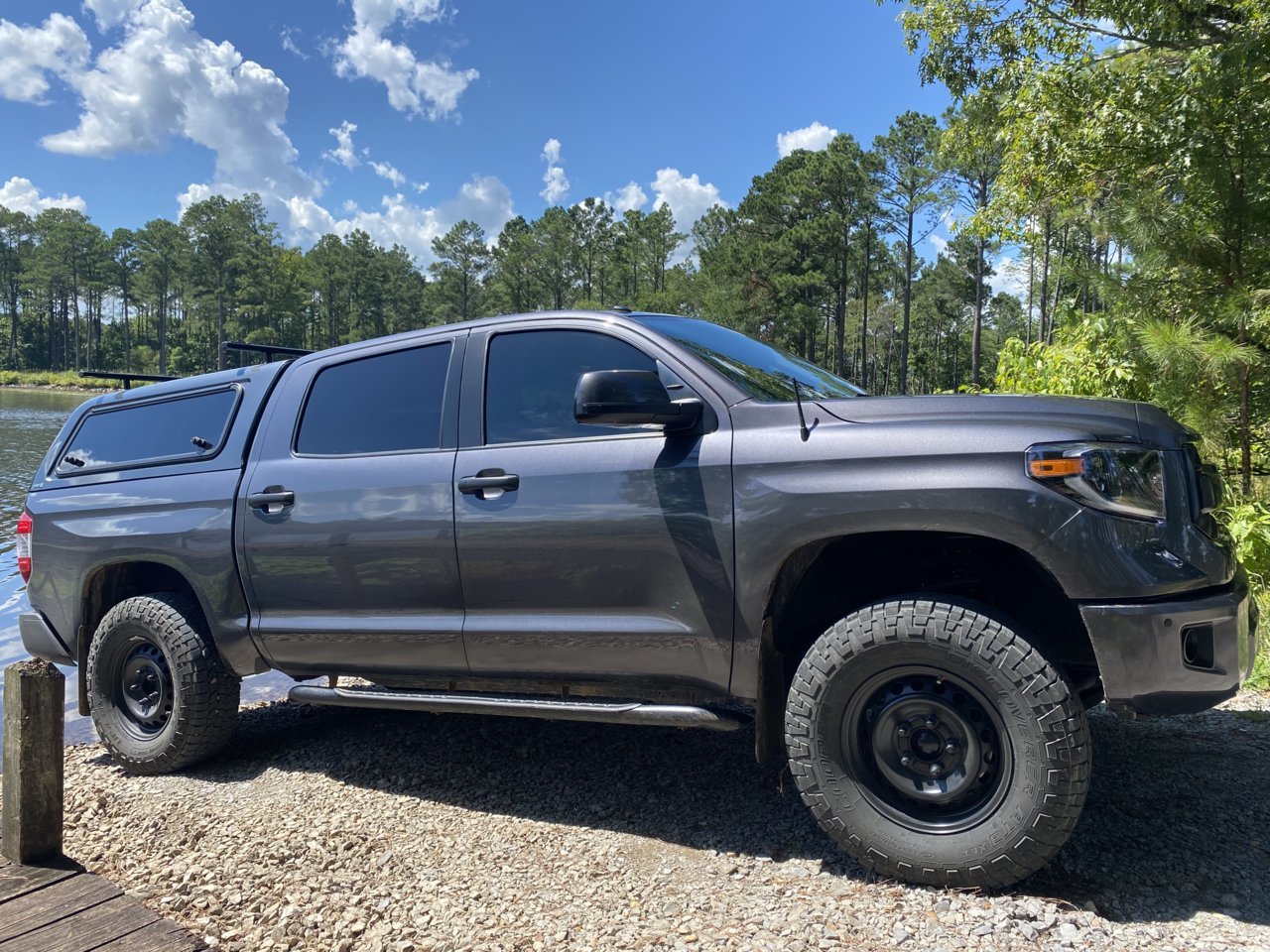

    This is mine with stock spare steelies….

    Same as stock alloy wheels. I used 1.25" spacers to get the 285mm wide tires perfectly flush with fenders.
