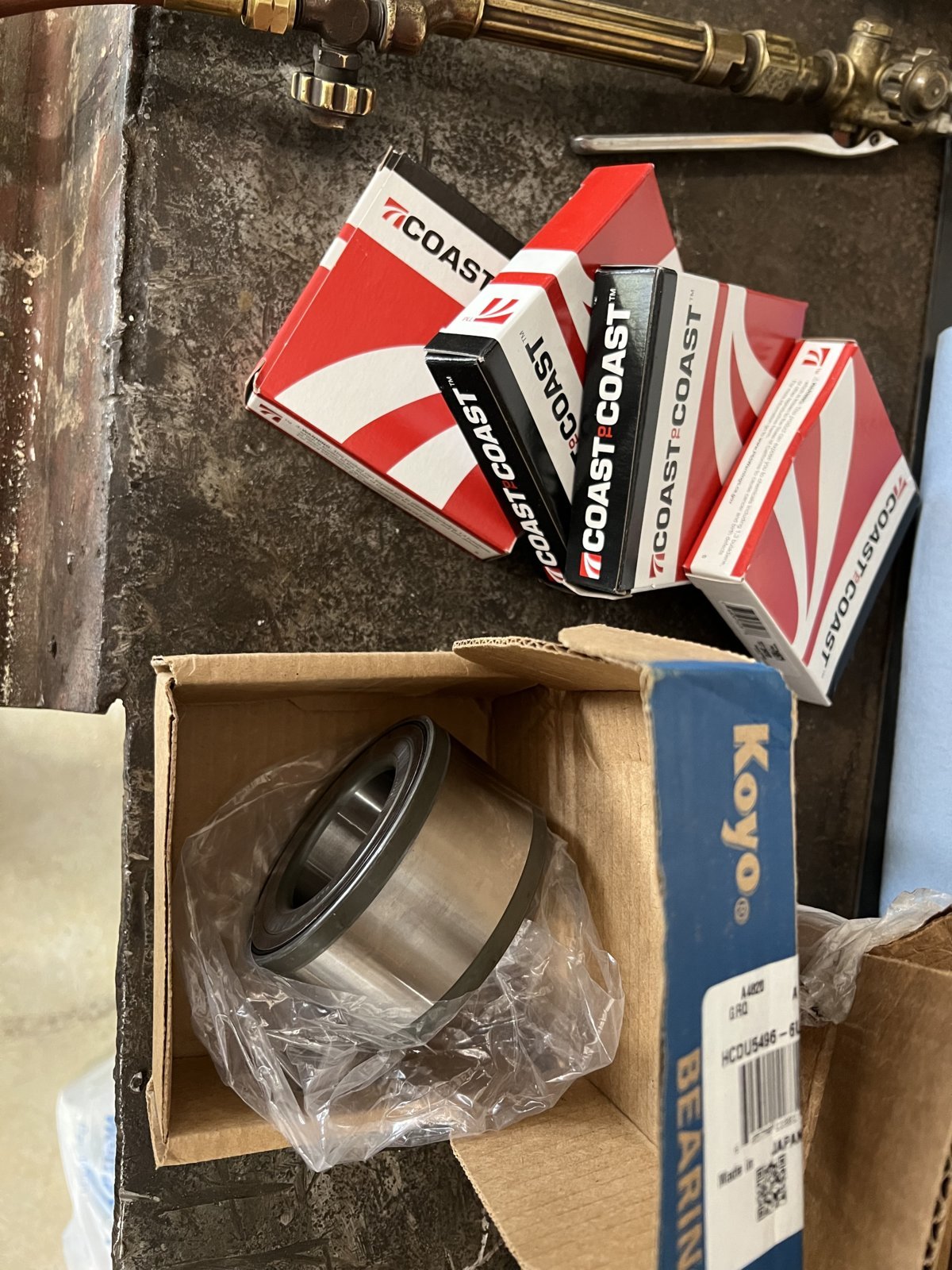

    do you happen to have a picture of the part # for the Koyo bearing?...and i’m assuming that they’re for a 4wd hub? And where did you buy your bearings from?

    I’ll send a pic tomorrow
