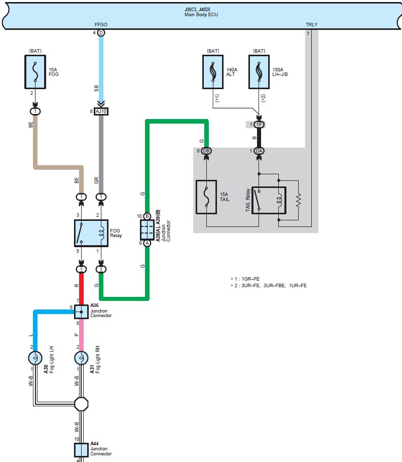

    One Fog light 15A fuse and a FOG relay that feed power to the front lights.
    I would start by turning the truck on, turning on the headlights, then fog light switch and using a multimeter to check for voltage at the front fog light connector. Doing this will tell you if the problem is on the bulb side or the truck side.
