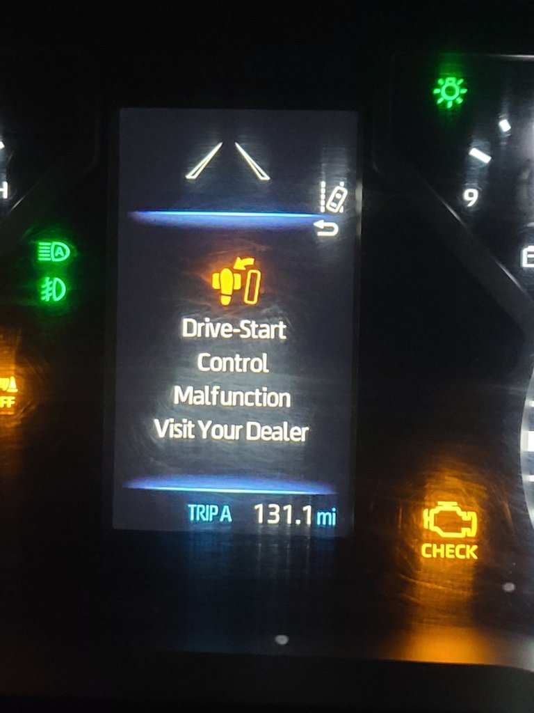

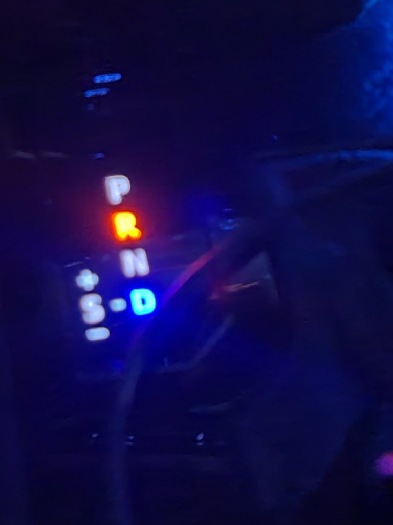

    Tonight I made it two blocks away from home and had a P0705 fault with a drive start control error message. Turning off and on made no difference. Felt sluggish immediately. Checked on scanner and got the code. Reset it on a whim. Turned on , still showing reverse light no matter what gear. Turned off and checked underneath, no fluid leaks or anything - started up and all was normal. Looks like it needed to sit for a minute or two to clear. I'll take to dealership tomorrow.

    This happened while moving from a stop light. R lot up on the PRND lights and the rear camera activated and flashed back and forth between camera and Android Auto. I shifted to park/reverse/drive and it sounded bad and lurched.

    Failed shifter/shift position sensor. They're denying warranty.

    Latest update - water intrusion in the tail light assembly caused a short to ground. So now another week wait for parts.

    Just shy of 3 weeks later. I got the truck back. Left reverse/backup lamp assembly short was the issue.. from what I can tell. The story seemed to change constantly. They recreated the failure and drove it that way nothing a chirp as it tried to engage reverse while moving forward. According to the notes they repeated this unplugging lights until they figured out the cause. Hopefully no permanent damage from this. Reassembly of the shifter area they crunched a USB connector I had routed for a QI charger and they dumped everything that was in the way into the driver's floor mats and left it that way.
