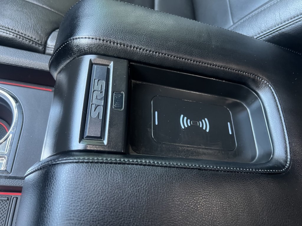

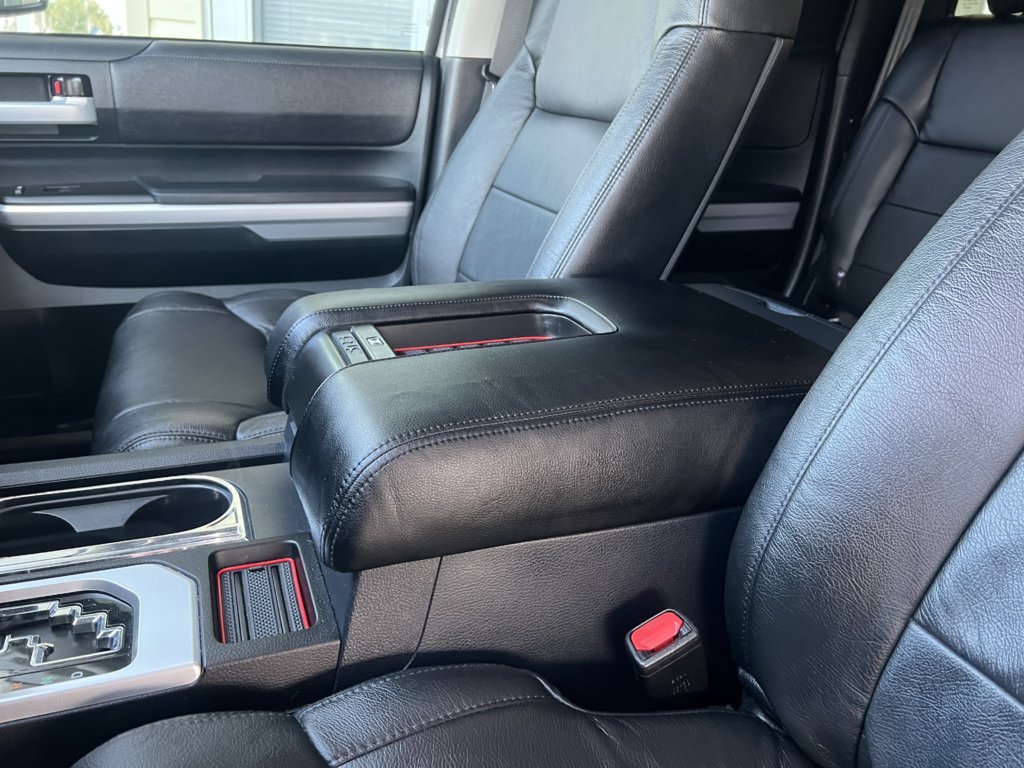

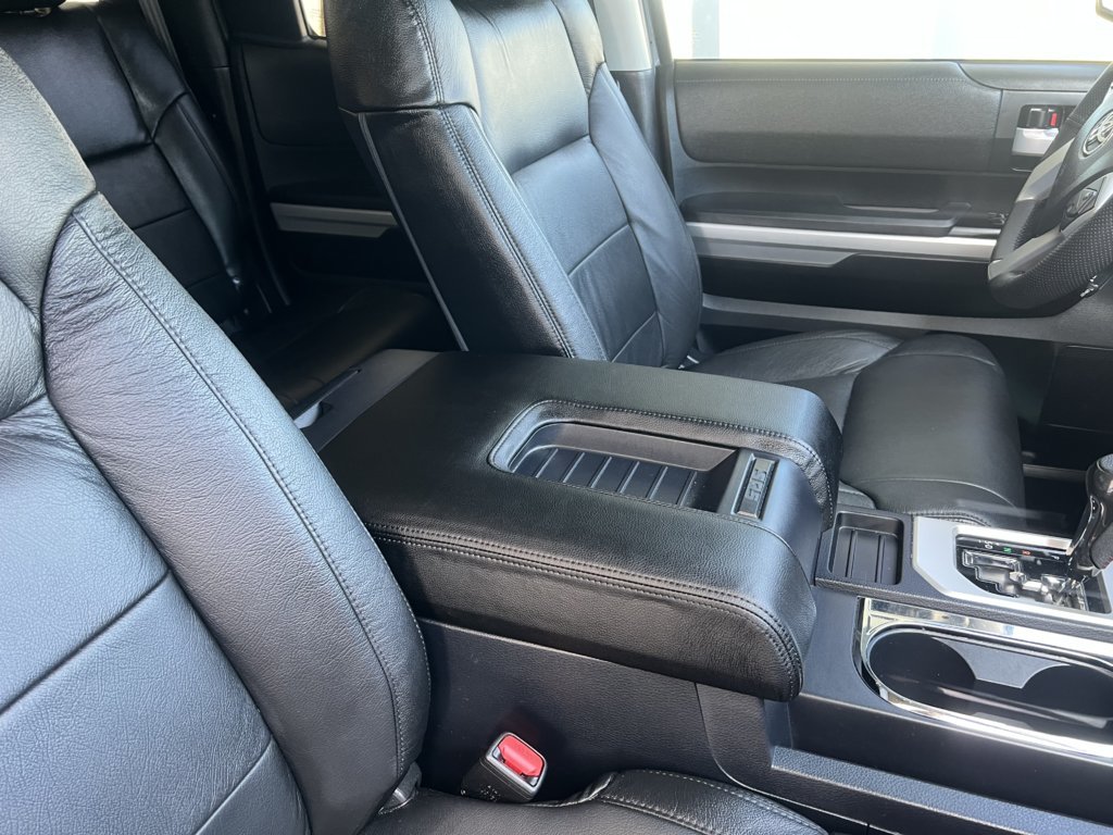

    I just finished installed a new console cover to match my Katzkins leather seats. Looks good and not too difficult.
    https://www.amazon.com/dp/B0CRKSDZSY
    I saw that you can buy a console phone charger for relatively cheap ($34). Has anyone installed one and do you like it?

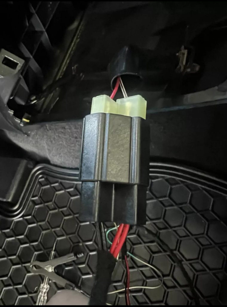

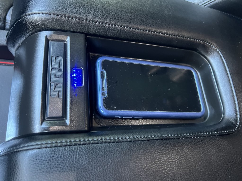

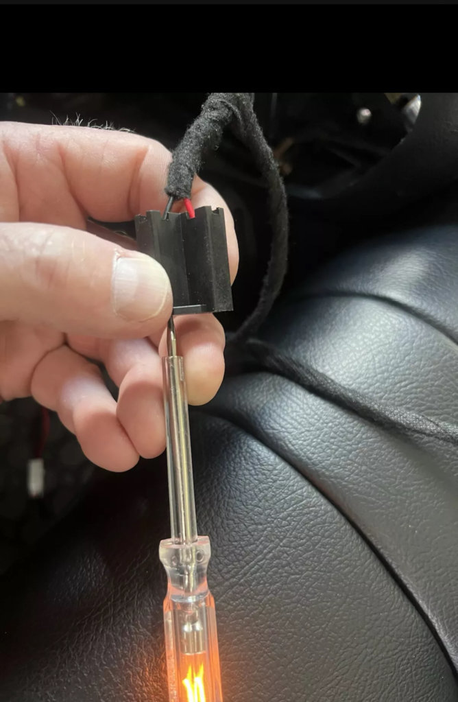

    Well me being cheap I decided to buy the eBay console charger. The seller offered a price of $34 and had free returns if it did not work. Also the seller had a 99% free back with over 34k in reviews. When the charger came I plugged it in to test and nothing. I then noticed the polarity on the connectors was reversed. Put it back in the box and printed the return label. I messaged the seller and he said I could keep it and would send out a replacement and I accepted. I figured what are the chances the second one would have reverse polarity. The second one can and it also had reverse polarity. I decided to remove the pins and position them correctly and the charger worked. I did the same on the first one that was sent and it works as well. I connected the charger to a battery and let it charge my IPhone 13 Pro Max for a couple of hours and no issues so I when ahead and installed it. I like the button changes colour to let you know if the phone is changing and when it’s done
  9. Feb 16, 2025 at 7:13 PM
    29,990
    Looks pretty decent.
    Does it charge the phone fast?
    woods likes this.
  10. Feb 16, 2025 at 7:33 PM
    Ruggybuggy
    Ruggybuggy [OP] Seasoned Veteran
    Sep 23, 2019
    #36508
    3,761
    Dave
    NW ON, CANADA
    2016 Tundra OR
    Yup, it’s pretty quick. I just hope it doesn’t overheat the phone.

    Center console cover looks great - did you install with adhesive or staples?
  13. Feb 18, 2025 at 11:17 AM
    Ruggybuggy
    Sep 23, 2019
    #36508
    3,761
    Dave
    NW ON, CANADA
    2016 Tundra OR
    I used a good quality spray glue.
