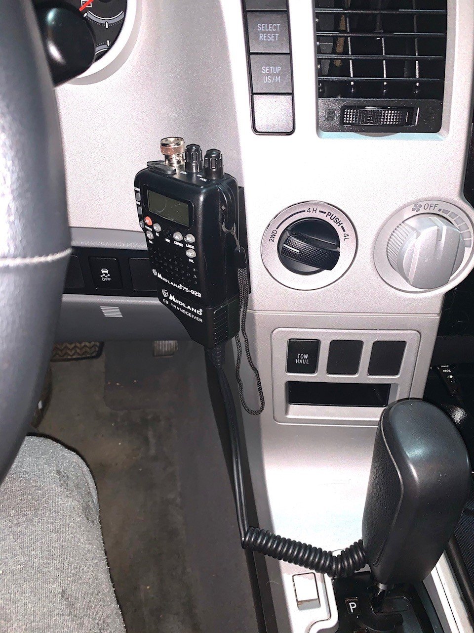

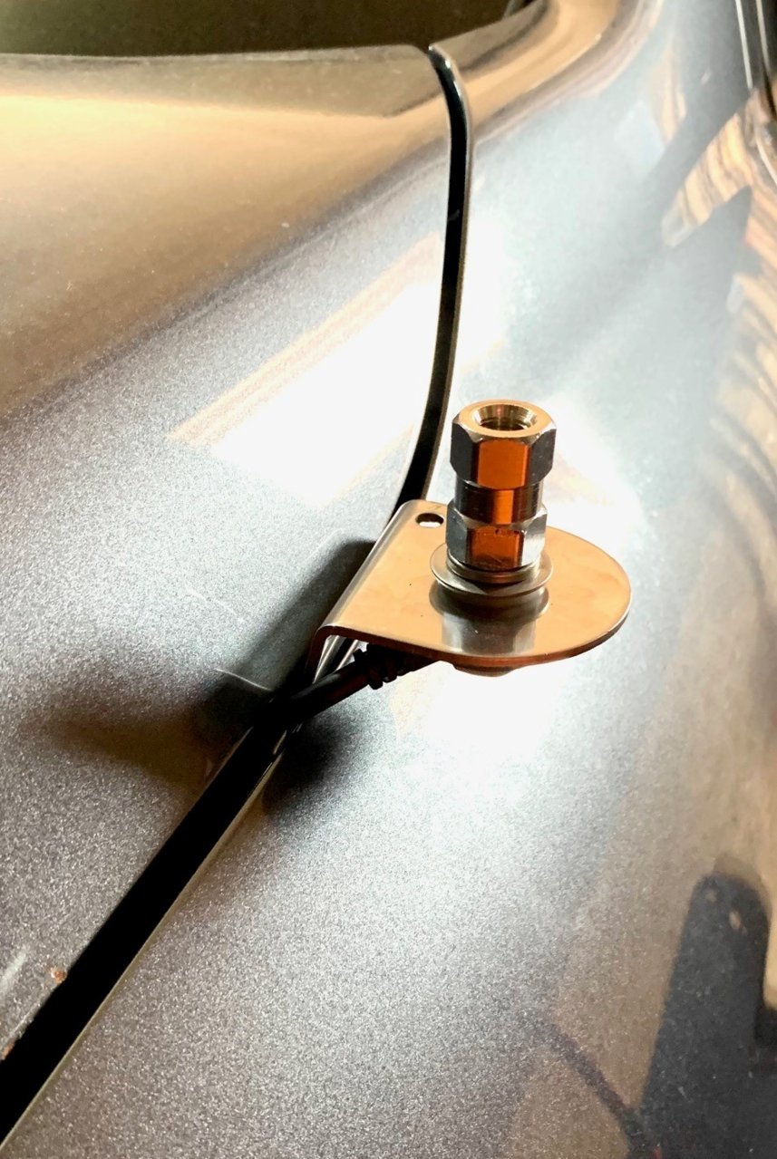

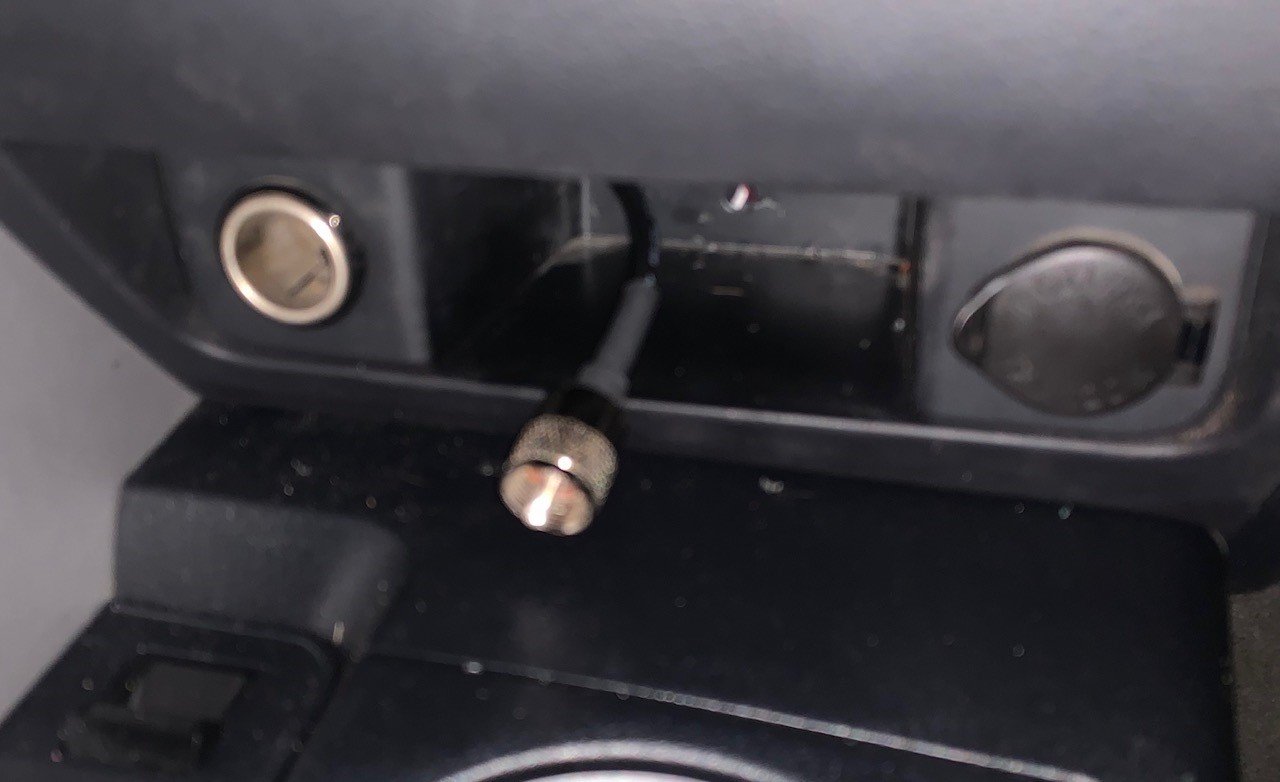

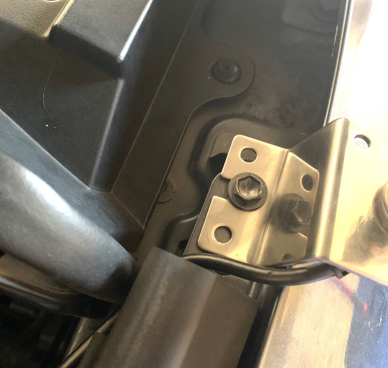

    My son got me a mount and a Firestik CB antenna for my Birthday. works so much better that the Little will mag mount i was using.antenna.jpg mount.jpg connector.jpg radio.jpg

    Question. Did you ground the antenna with a grounding strap to anything under the hood or does it work fine without one? I’m about to do the same thing.

    there is a body bolt that i used and i checked continuity with a multi-meter after it bolted it down and it was great so no strap neededbolt.jpg

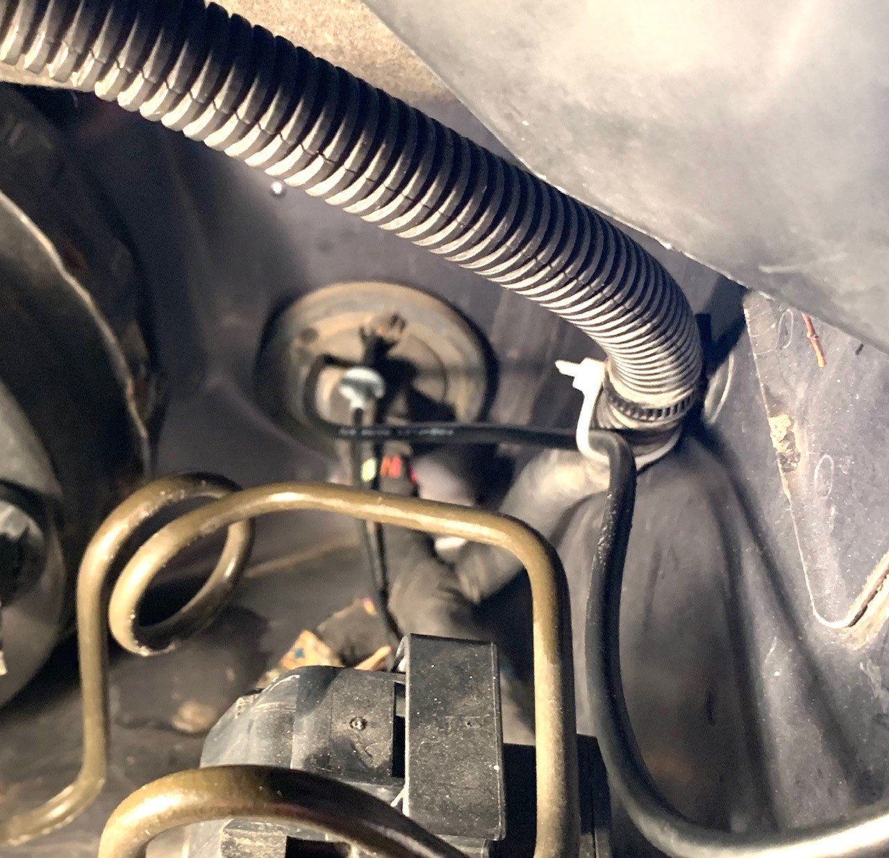

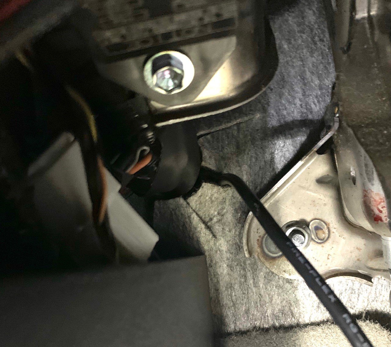

    there is a large rubber boor tor the main wiring harness that comes through by the ebrake the carpet is tabbed so you can just peel back a couple tabs. i used a 1/4 rod with a sharp point ground on one end an taped the coax to it and just threat it through from the engine side since i was using the fire ring cable.FW.jpg FW2.jpg

    don't overthink it. you shouldn't need one. i've never had a grounding strap for either cb or ham. not on the tundra, not on the fj before it.
