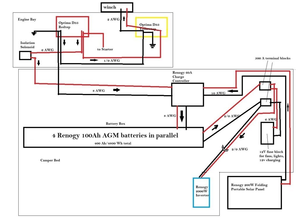

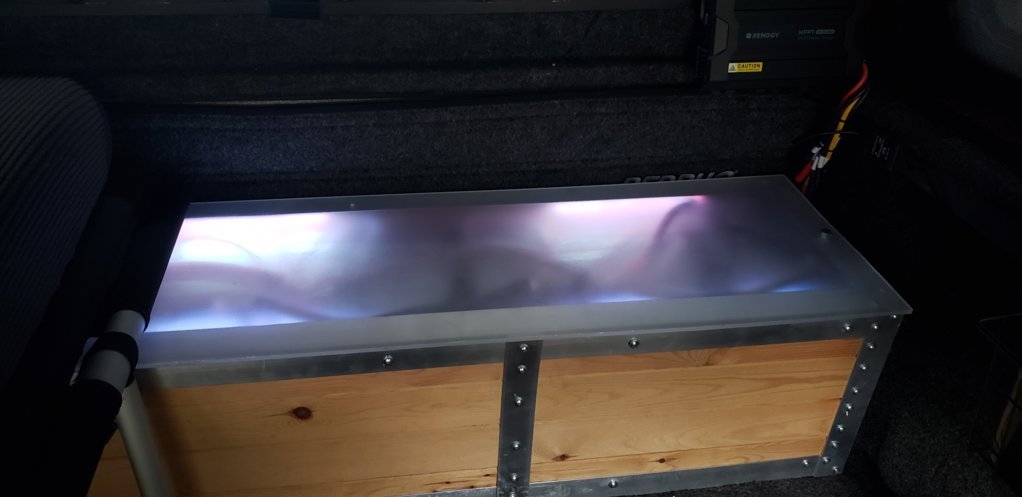

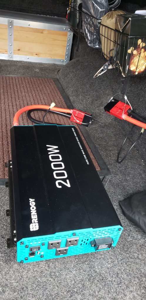

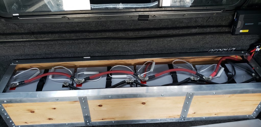

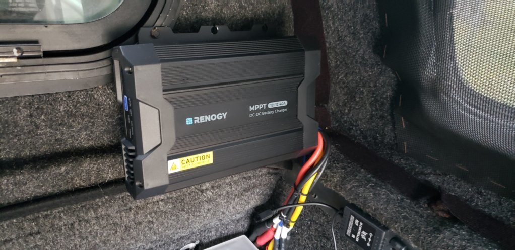

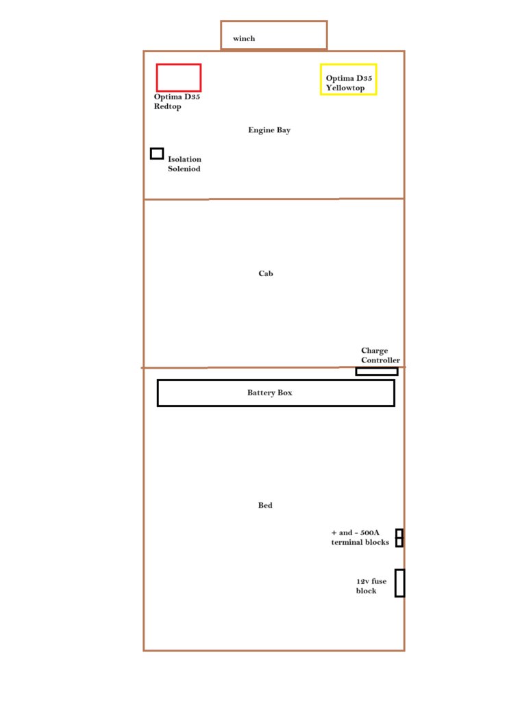

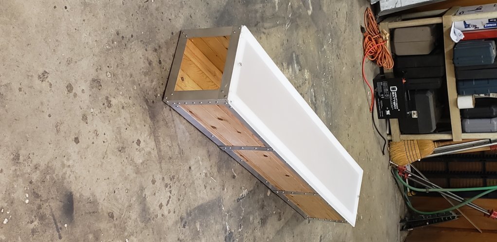

    First off, I'm short enough to be able to have a cot in the bed of my truck. I sleep in it on camping trips. ARE camper shell w/ Bedrug throughout. Built a new electrical system for boondocking. Renogy has a sale on their equipment so I bit the bullet and got the following: 4 12v 100Ah batteries, 1 60A charge controller, 1 2000W Inverter. Already had a Renogy 200W solar panel and knew they made good stuff. Made a battery box out of old bedframe slats, aluminum angle and a piece of plexiglass I had laying around. Bought cabling, lug ends, heat shrink, and lots of solder to custom fit the cabling from Amazon. Installed battery box in very front of bed. Sits about 2 ft in front of rear axle. Installed 4 batteries (260 lbs) in box and wired everything in. Also added color changing led strip lights inside box for ambient light inside camper. I choose red at night for the late night bathroom trips.
    Charges aux batteries via alternator while driving, charges by solar panel while boondocking.
    4800Wh used to 50% will last about 3 days without recharge even using a 700W microwave and an ice maker. 2 days if I use a Portable A/C unit. Using solar panel keeps it topped off.
    Included block diagram of setup and layout. And yes, I have 2 starting batteries under the hood. And the cot fits snuggly over the battery box.

    Really like this set up! Nice job. I bet it makes camping a breeze

    Ok, here comes the big question.
    Clearly this is f'n awesome. I'd love to have this, and I'd camp waaaay more often if it was in my truck.
    But that said, I'm sure you kept tabs on pricing, what's the damage? $3,000? $5,000? Inquiring minds want to know how painful to the wallet this would be.

    Total cost was less than $2000 with all parts and shipping. Battery box was homemade out stuff I had.

    Nice setup. I really like that Renogy DC/DC Charger/Controller.
