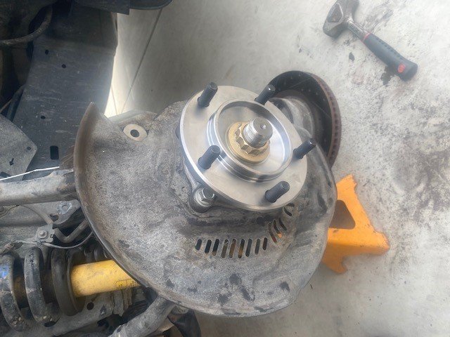

    Hey you guys. I've been working on it since 6AM this morning and it's now noon. I think I got it right.
    I bought complete axle shafts and hub assemblies. When I first got it together I had tightened the hub (4 bolts) before making sure the axle shaft was bolted in place. This caused the axle shaft to have a minor misalignment so when I tightened the axle shaft nut it froze the hub from spinning. I hadnt even gotten the caliper back on yet.
    I disassembled it, got everything aligned, tightened the axle shaft nut FIRST then tightened the four bolts on the hub and it spun freely. Wholly molly! Don't just watch a couple of youtube videos mechanics show. This was my first time and after three tries and pounding the shit of the axle to get it into the diff I think I got it right.
    Thank you all for your quick response.
