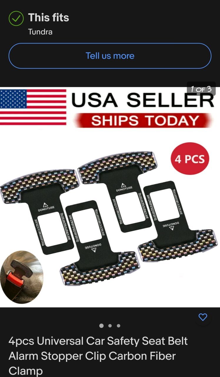

    Welcome from OKC! Two alternatives, dummy seat belt buckle males can be purchased or you can just buckle it before you get in.

    I use these when driving on the beach. Better then buckling the seat belt!

    Good idea!
