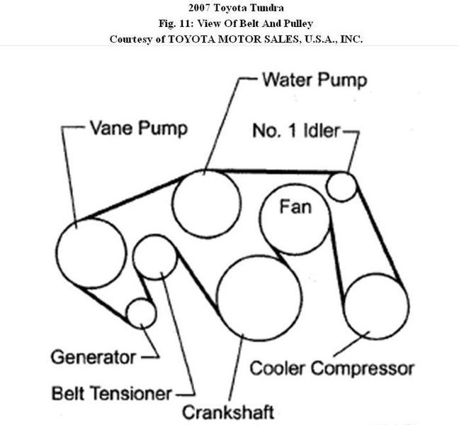

    Make sure serpentine belt is correct?

    I recently watched a Youtube video of a guy that was looking at a 5.7l that had the belt replaced, but it was squeaking. The previous mechanic put it on wrong. I looked in my Youtube history, but couldn't find it. I don't think a charging problem was listed, but it ran ok with the belt in wrong.
