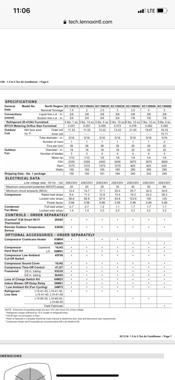

    Is the larger breaker suggestion for the outdoor unit, or an electric heat pack in the air handler? Depending on the electric heat pack size sometimes those need pretty large breakers, but if you already have an electric heat pack in your current unit then it’s probably already suitable. It would be helpful to see the nameplate of the unit. This outdoor unit for example lists the minimum circuit ampacity (the minimum amount of amperage the circuit must be able to sustain). It then also lists a max breaker size for the unit. This is only a 2.5 ton condenser though.

    Not sure if this is the correct model line, but either way I think it should work on a 40 amp. Even if it’s a 5 ton the minimum ampacity of the circuit is under 35 amps. A 40 amp covers you for that, so long as your wire is also sized appropriately. They just don’t want larger than a 60 amp breaker installed is what I gather.
