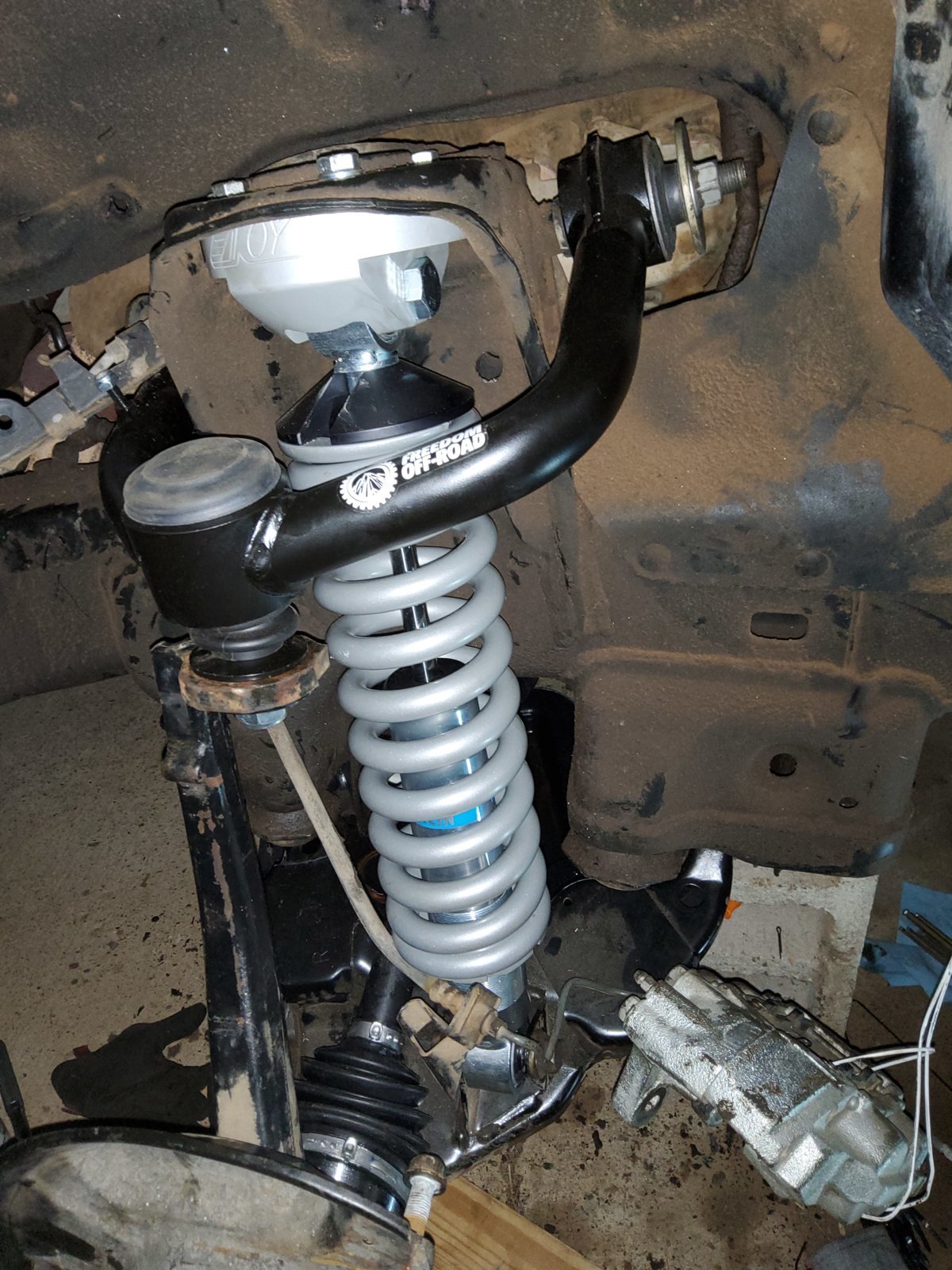

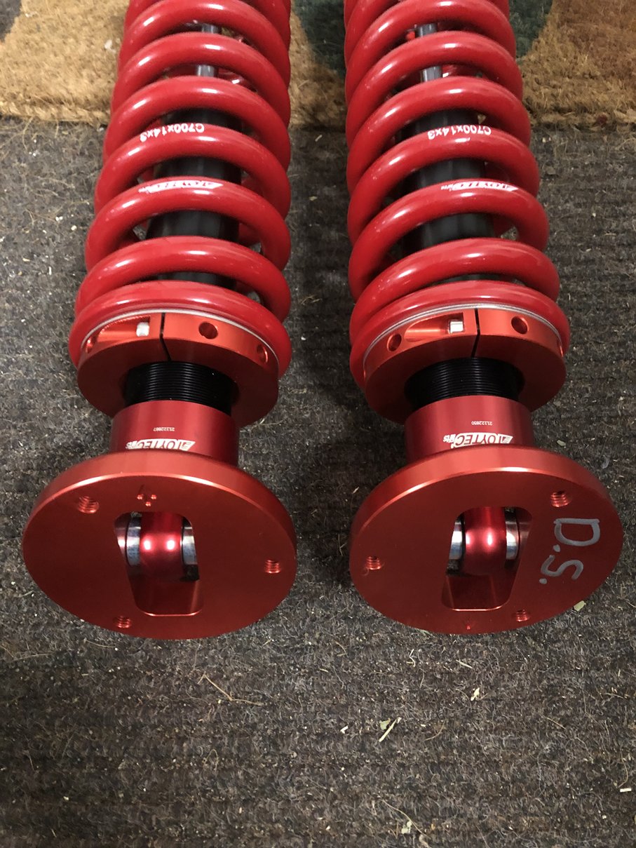

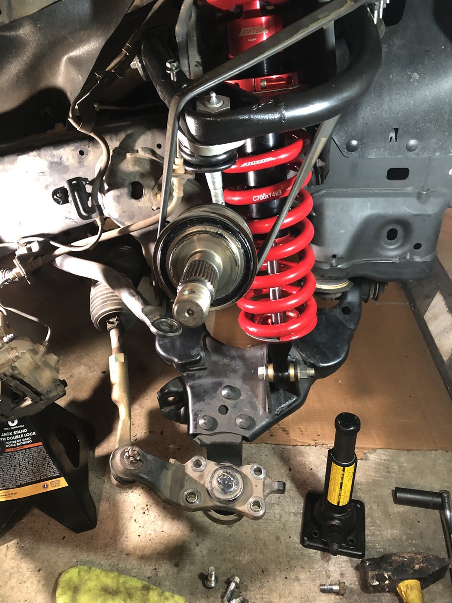

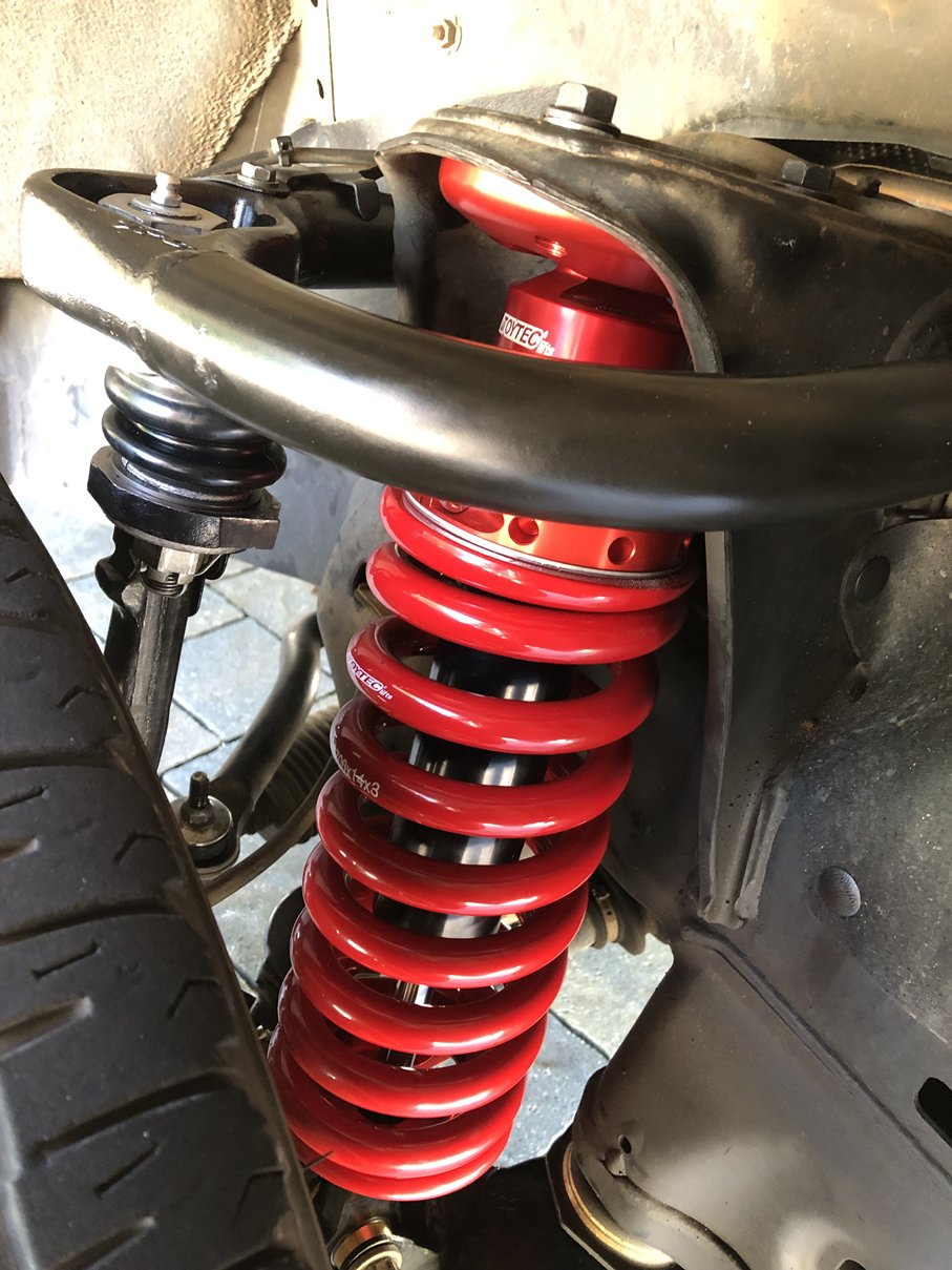

    I was just under my truck because I was hearing a weird jangle in the front passenger wheel well while driving around today. When I hopped in the truck to ship something a few minutes ago, it wasn't there anymore. Super weird. I swear, I think most of my jangles and rattles are coming from these Toytec/Elka coilovers. I need to run out there tomorrow and check the collars and shit, make sure nothing is hinky with any of the accoutrements. If the collar was loose, I would expect something would've spun and I would lower on one side. But what do I know.
    I guess this is the side benefit to NOT having coilovers is, you don't need to worry about this shit. There's no moving parts to let you compress/decompress the spring.

    Does yours have 2 collars? I'd imagine it does.

    Oh, and I'm not a fan of the lower mount on these. The fitment of the lower shock bolt thru the bushing isn't as tight as I'd like it, and I think that causes rattle when the bushing jumps on the OEM bolt. Tolerance seems a little sloppy IMHO.

    Those shocks are quite a bit different than mine. Plus your shocks are upside down!
