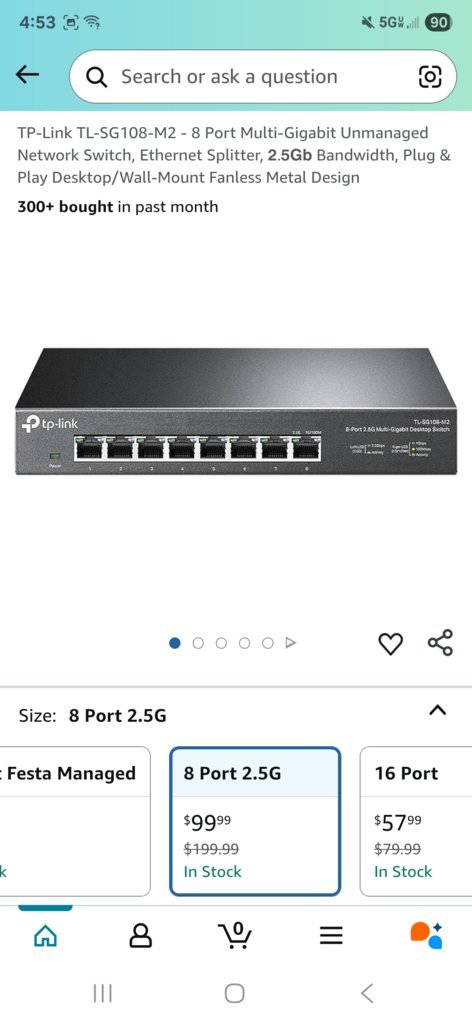

    I was looking at this one. It's a 2.5 gig 8 port on sale at 50% off.
    vtl[QUOTED] likes this.

    I have a couple of TP-Links. Zero problems over who knows how many years.

    For the switch that I am looking at, it says WiFi 6. Does that matter if my WiFi router is WiFi 7?
    The router is the Eero 7 Pro tri-band and the mesh system is the Eero 7 dual band.
  18. Apr 28, 2025 at 6:29 AM
    vtl
    vtl New Member
    Mar 23, 2020
    #44238
    2,899
    Boston 'burbs
    2019 Red SR5 DC 4x4
    You said your uplink is 2 Gig. The router you picked is 2.5 Gig. This is per port. Switch core inside the router is supposed to provide enough bandwidth to accommodate for declared wire speed on all ports. That's why 24 port switches are more expensive than same speed 4 port switches.
    tl;dr: the switch is 25% faster than your uplink, any port can saturate your uplink, good to go.

    Gotcha. So the wifi 6 versus 7 doesn't matter? I have no idea what wifi has to do with a switch....I thought it was just for the wired ports.

    No none of them are. I just got hung up on the switch that I linked says WiFi 6 and my router is WiFi 7.

    Not sure why TP-Link mentions Wi-Fi for a switch. Might just be marketing :notsure:

    Could be but it's all good. I ordered the one that I linked.
