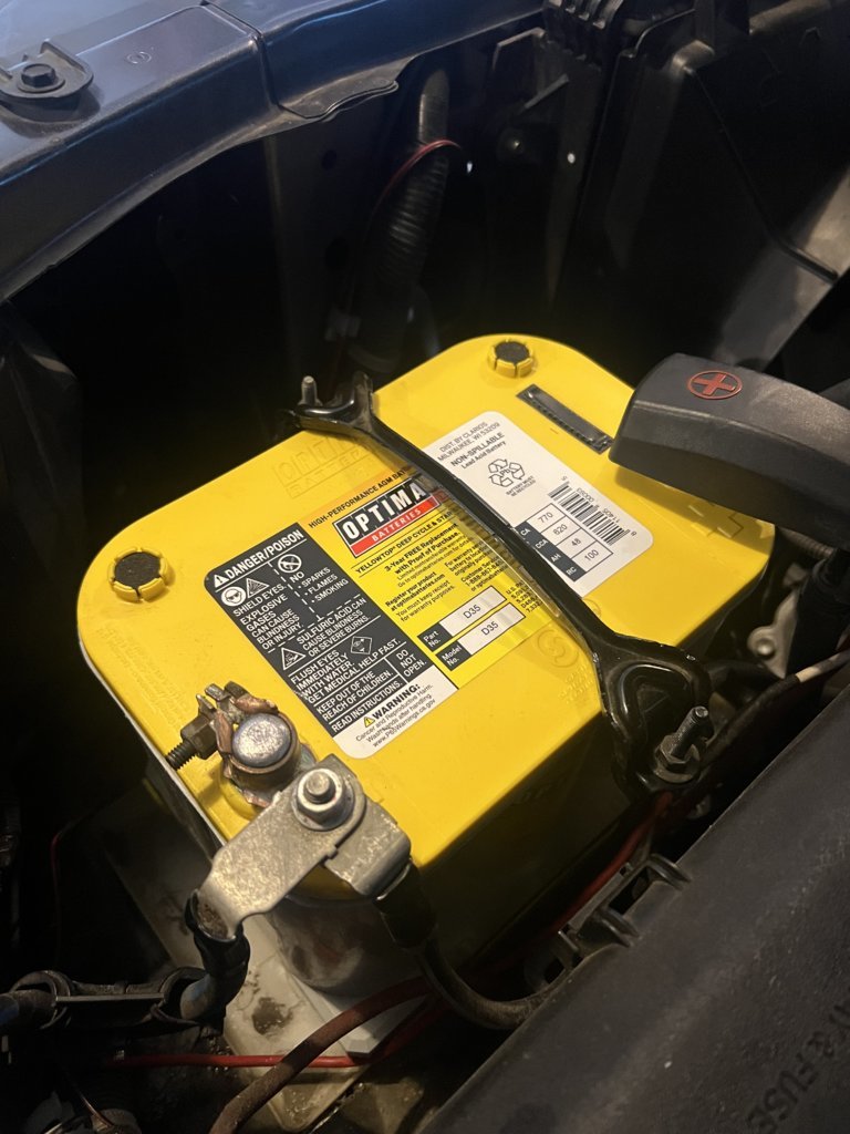

    About a year and a half. I don't doubt the battery at all. IMG_3107.jpg Once I cleaned and tightened, there have been no more issues.

    Your ground terminal looks very bad. At least remove oxidation on the mating surface with sand paper.

    That's what I thought too. That picture is after I wire brushed and applied dielectric grease. I think a beefier negative clamp is in order.
