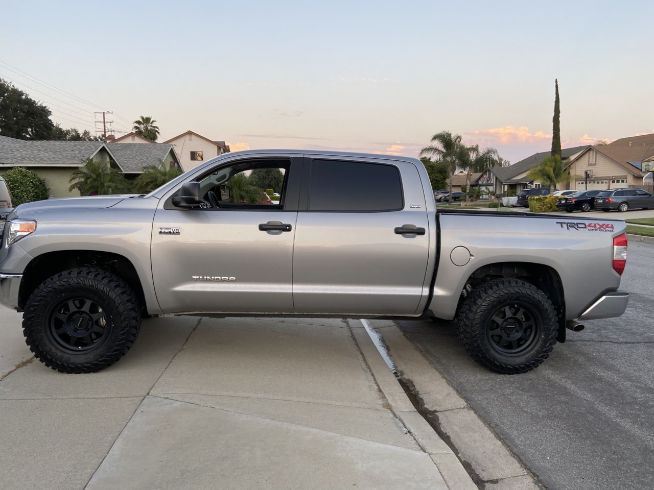

  7. May 10, 2020 at 1:16 PM
    Steve
    Steve New Member
    Apr 13, 2016
    #3132
    17
    2015 Tundra Crewmax SR5 TRD 4X4
    TRD dual exhaust
    Yesterday Method 701’s with Yokohama Geolandar MT’s in a 295 70 18 installed. I have 6112’s at top setting.

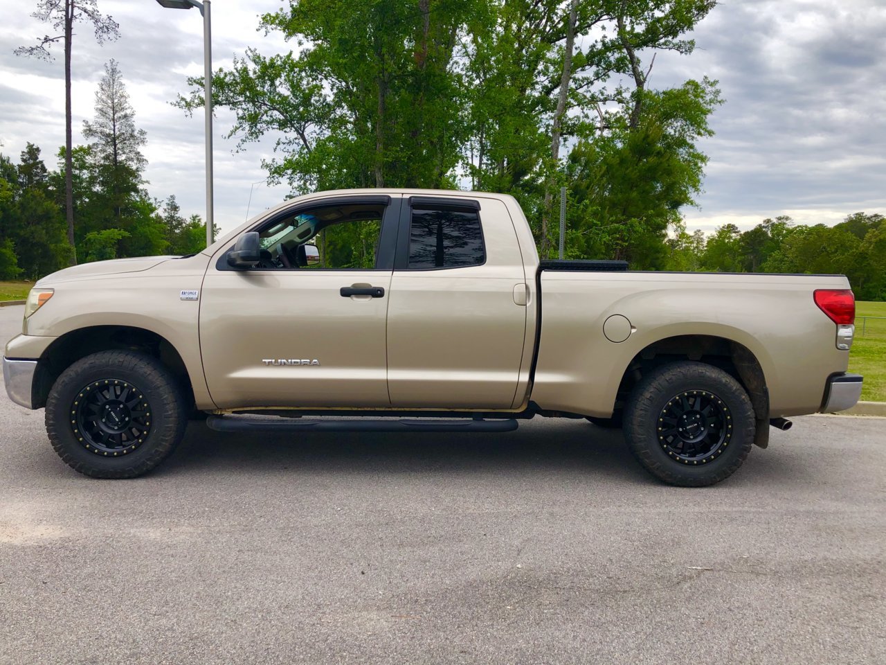

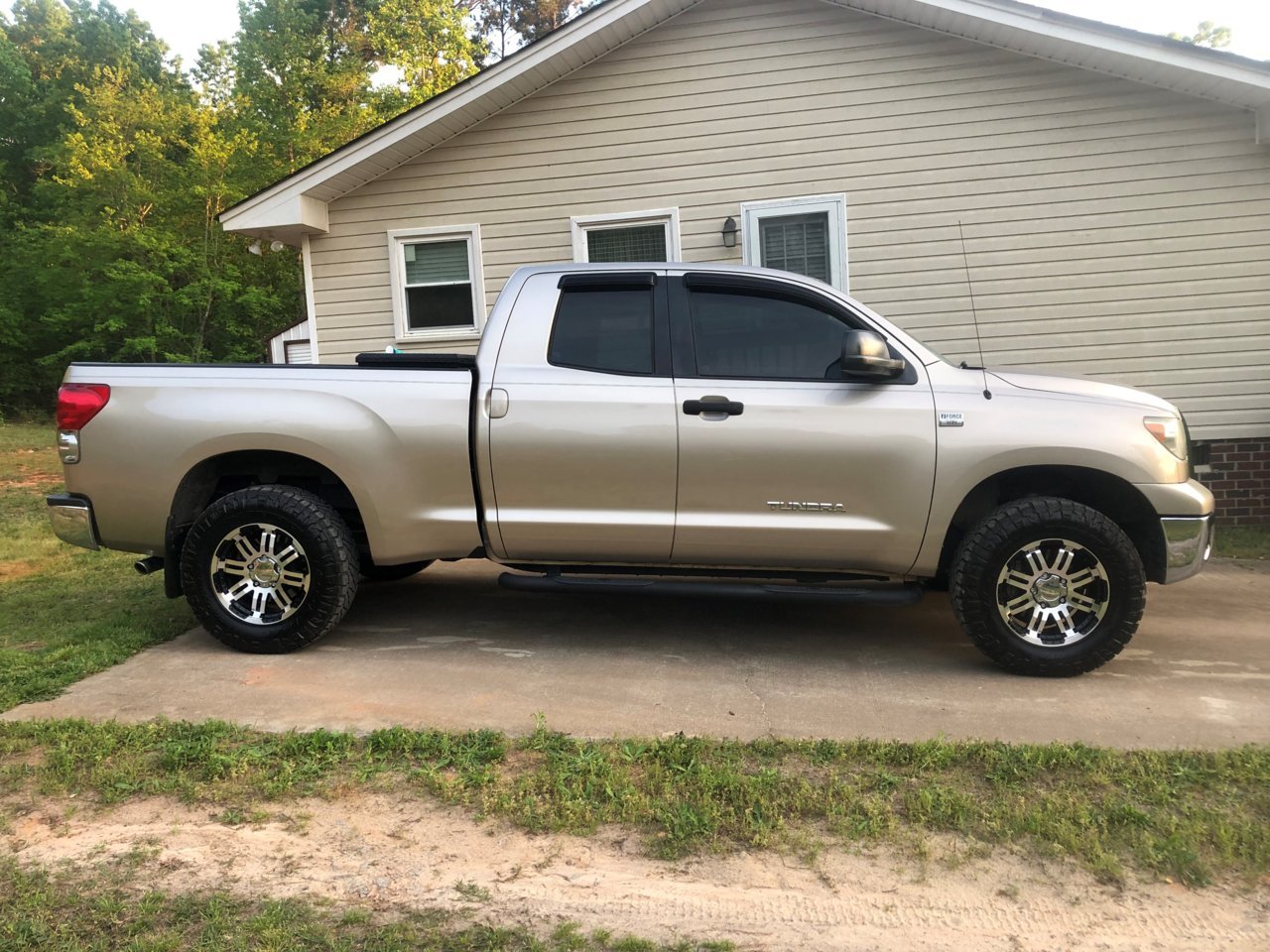

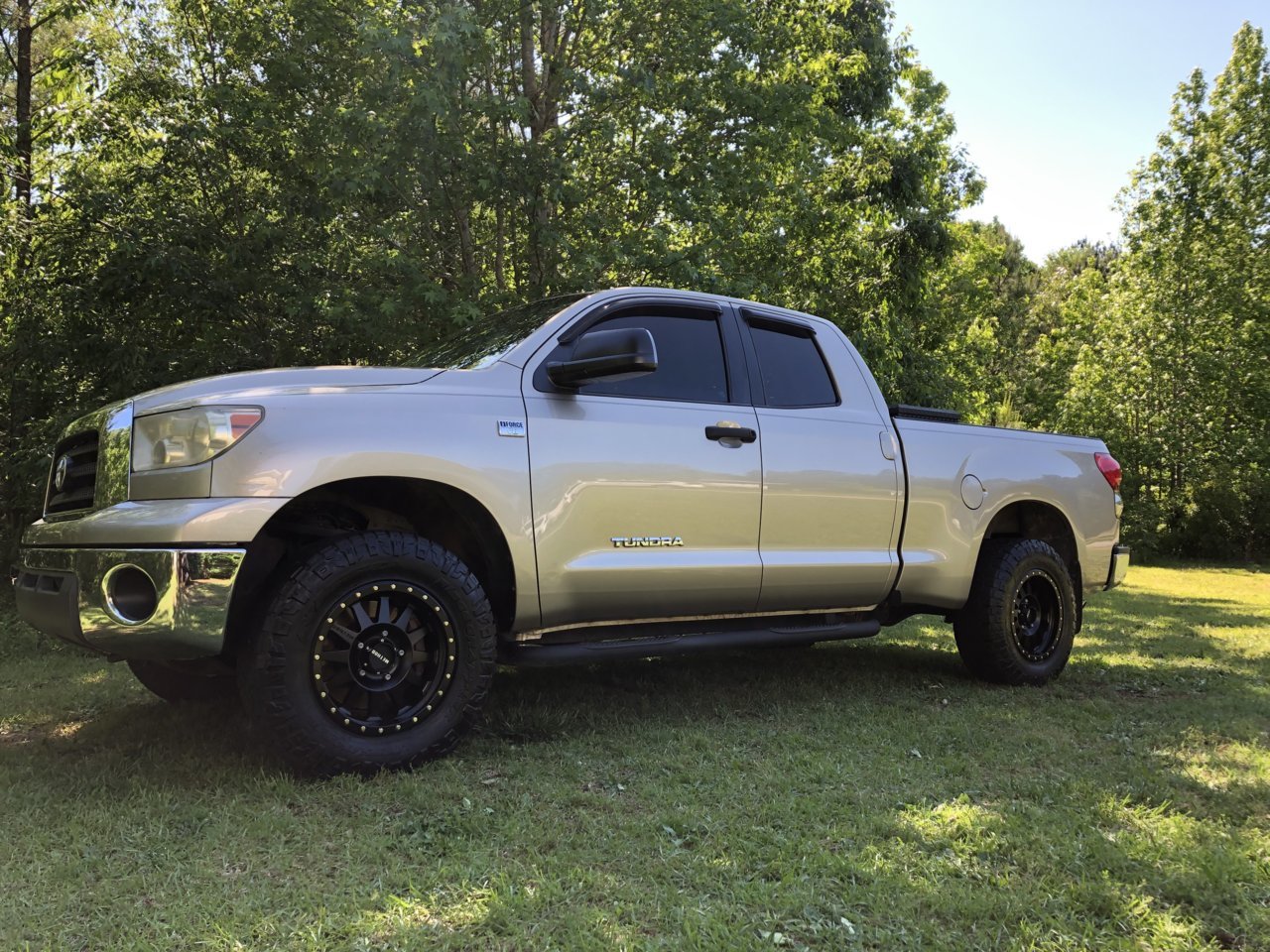

  18. May 12, 2020 at 6:23 AM
    parker44
    parker44 New Member
    Feb 6, 2018
    #12700
    588
    2008 Tundra - Desert Sand Mica
    Pics just for reference. My 2008 has a 2" spacer and I'm running 275/70/18 Ridge Grapplers. The first pictures are from my Vision Warrior wheels, which were 18x8.5 and a +25mm offset. I recently replaced those with Methods because the Visions started peeling the clear coat on all 4 wheels, at under 2 years of being on the truck.

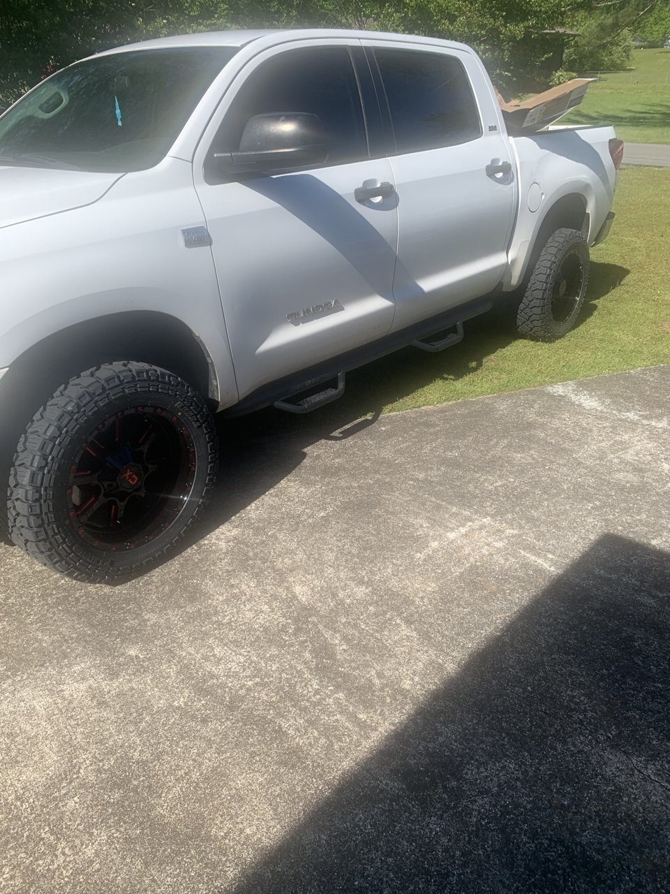

  19. May 14, 2020 at 7:55 AM
    Todd0417
    Todd0417 New Member
    May 10, 2020
    #46360
    3
    Todd
    2010 White Tundra SR5
    I have 20x10 kmc wheels with a 285 kenda tire. Have n-fab step bars that i think are the best looking bars out there. Just ordered a pedal commander for it...
    Wild Bill im not running any spacers other than the leveling kit. I havent trimmed anything. I changed the step bars bc it was close to catching the edge of the old ones i had on but thats it. 20x10 wheel with 285/55r20 tires
