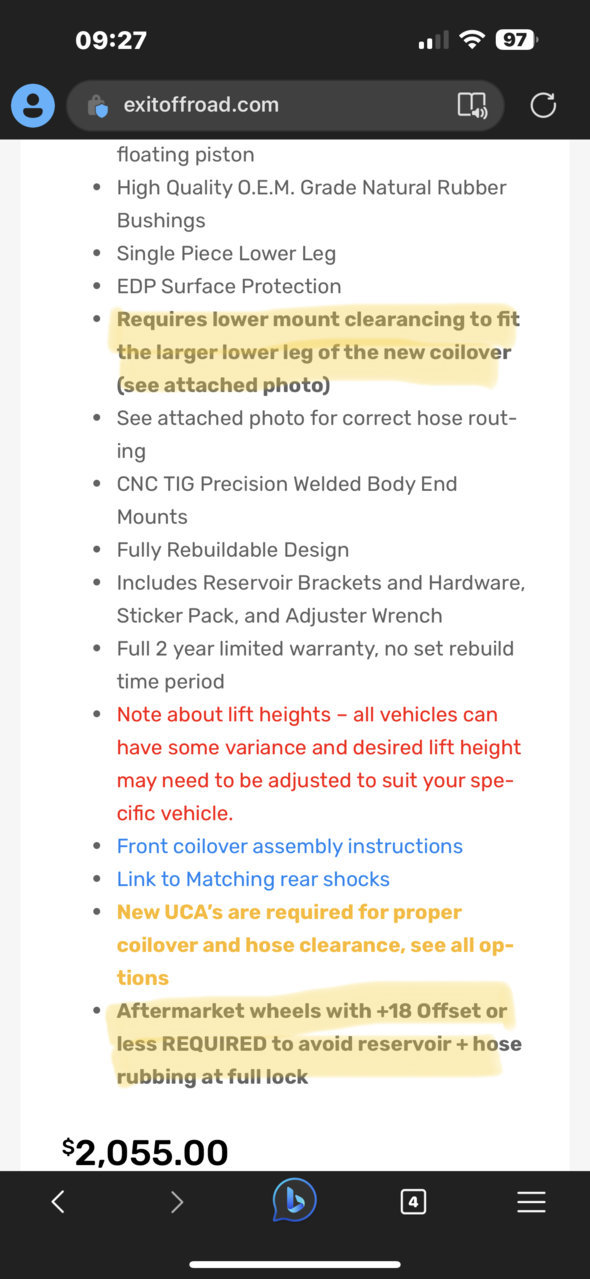

    I had my suspension choices narrowed down to these two, the Dobinsons MRA/MRR and the 8112/8100. However, there seems to be new issues with Dobinsons shocks being mounted now, according to Exit Off-road website.
    Looks like you now need to do some additional work to fit properly, and run aftermarket wheels.
