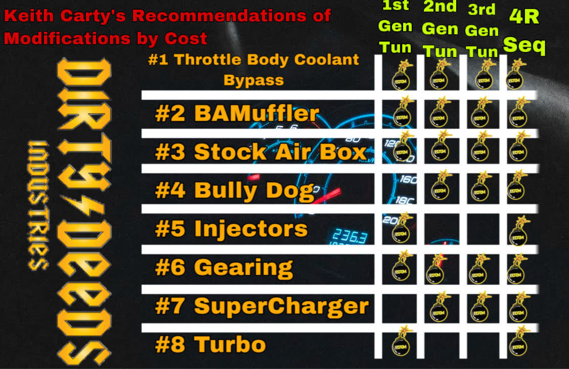

    Here's a help little guide that we put together.
