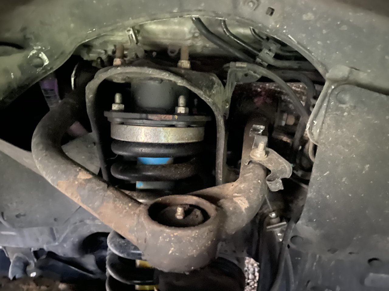

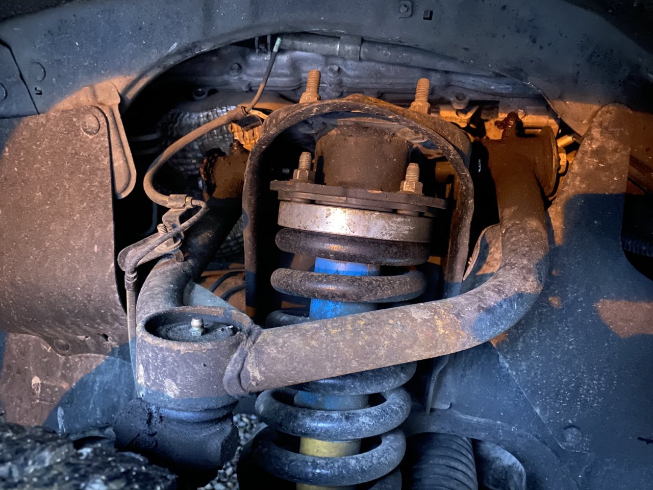

    My 14 CM is lifted and it was that way when I bought it but the dealer didn’t know how much or what kit was in it, so if any one still has a stock CM tundra if you could get a quick measurement for me that would great, center of hub to highest wheel well opening I guess that would work??? Unless any one here has another idea?

    It's probably a spacer lift kit such as ReadyLift. Post a couple pictures so that we can see what you have.

    Looks like the ReadyLift 3/2 spacer kit and aftermarket UCA's.

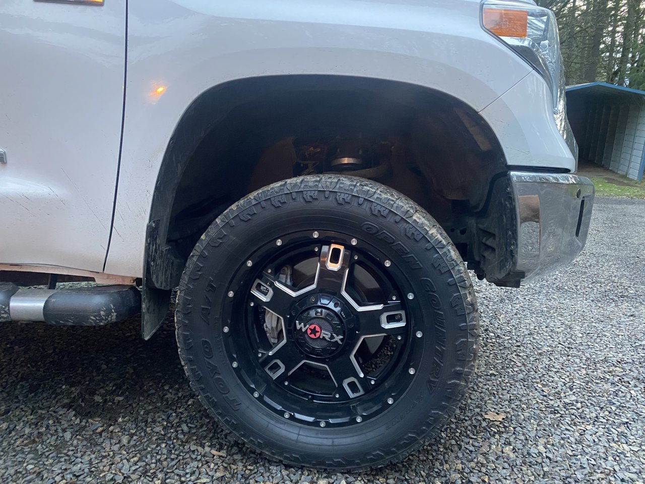

    So the question is would 35”s look stuffed under it? I really want to get rid of the 20’s I like the look of having side wall on tires

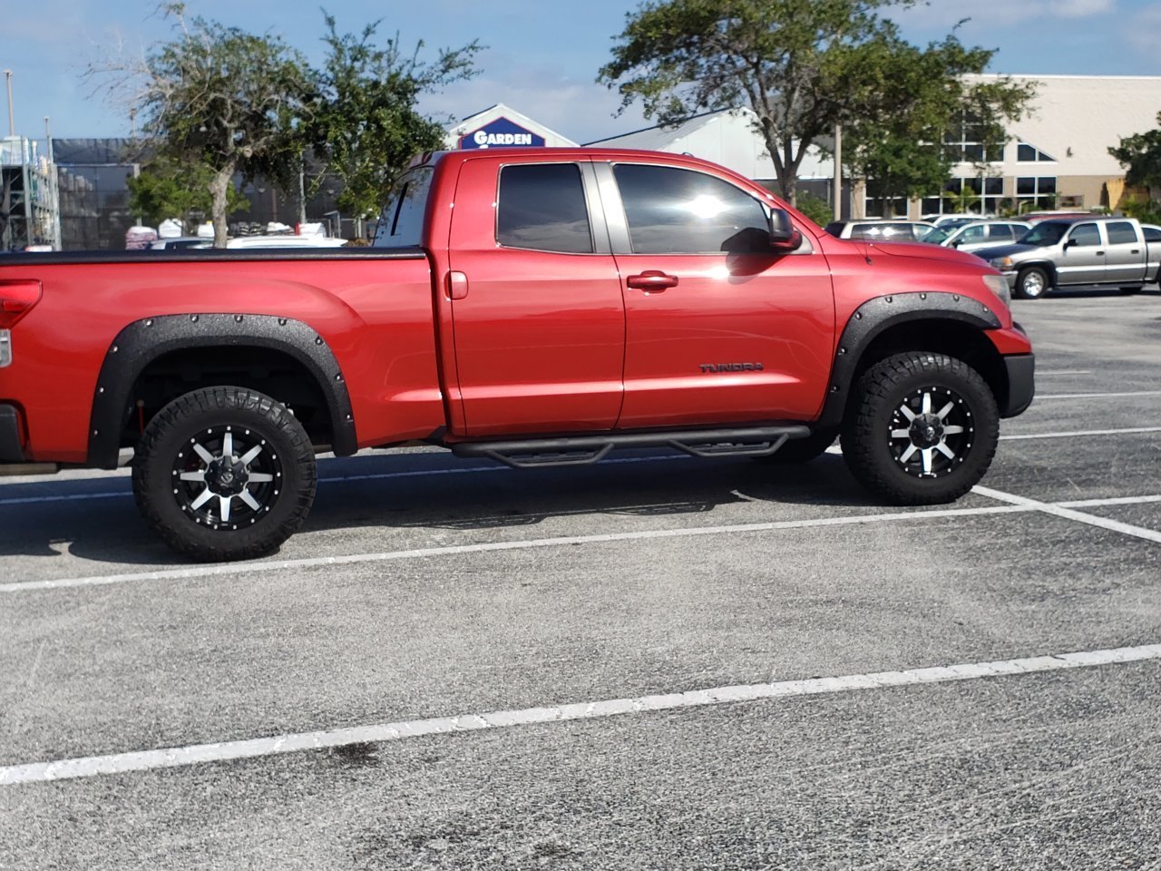

    I have the ReadyLift 3/2 and I run a 285/70/18 Ridge Grappler on a 0 offset. The 285/70 is right at 34.

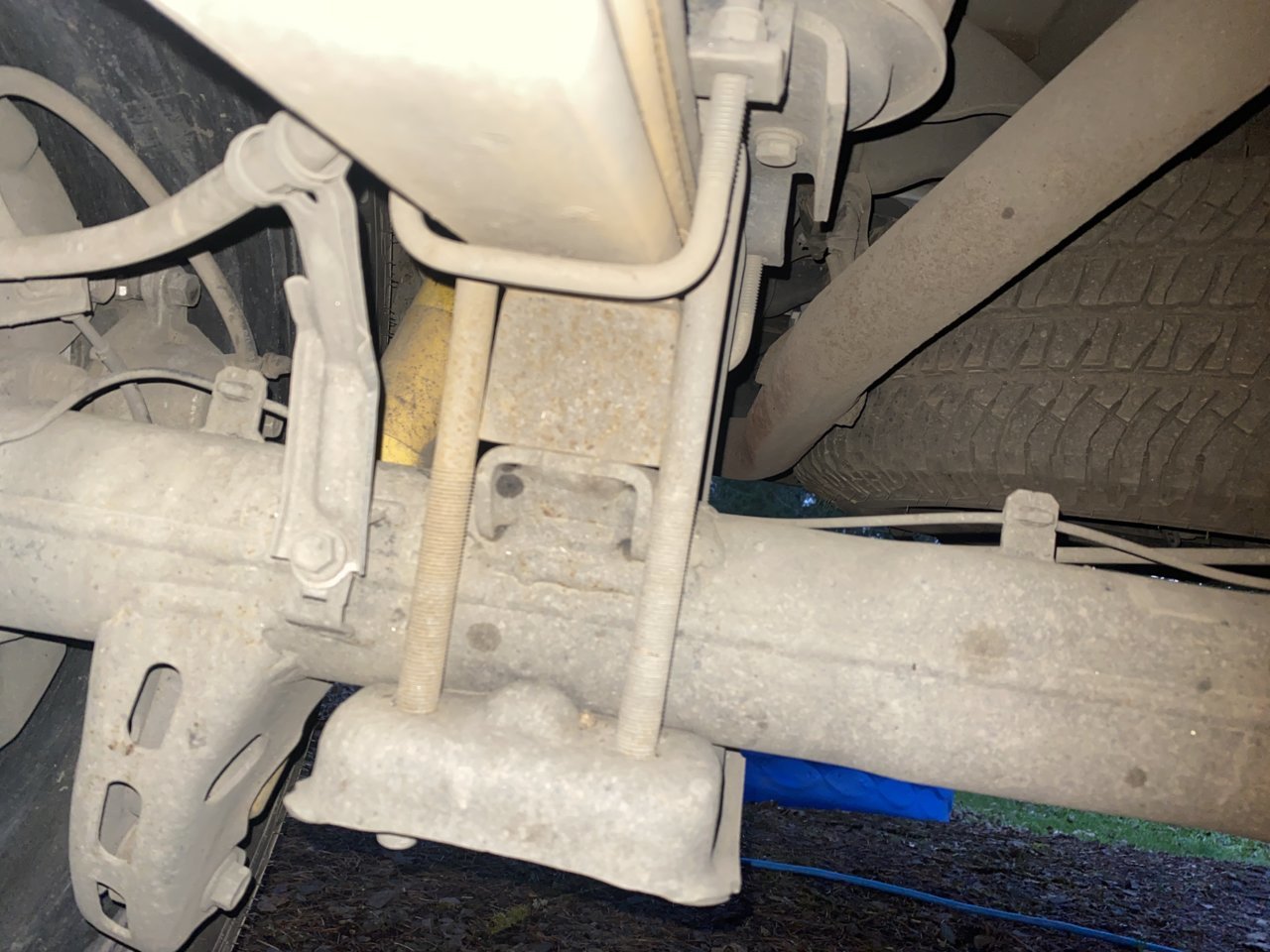

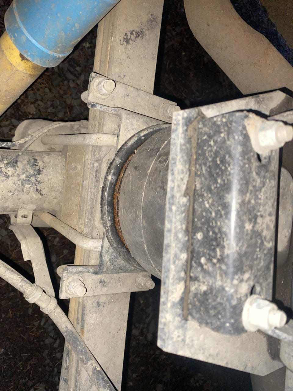

    After looking at the photo again. It looked like you have two different kitsch. Rough country (black spacer on top of spring perch) and Tuff country (aluminium spacer between spring and perch). I assume rough country lift will be the rear block.

    I would be buying new wheels since I want to go with 18’s when I get new tires

    It’s all good I understand offset I might stay with the same size tire but just a 18” wheel with the same offset and all will be right in the universe
