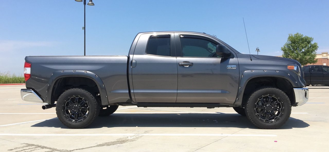

    2.5" front - stock rear.
    It looks nose high, but it measures level.

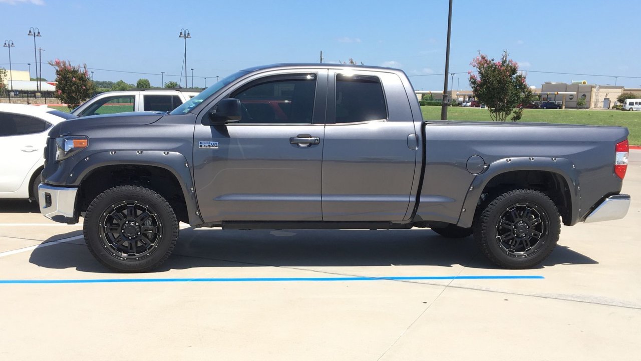

    2.5" front - 1" lift rear
