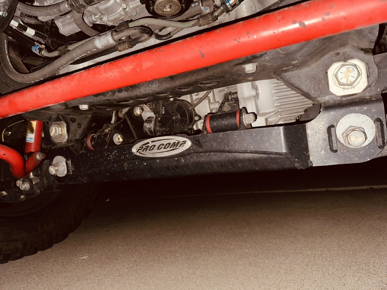

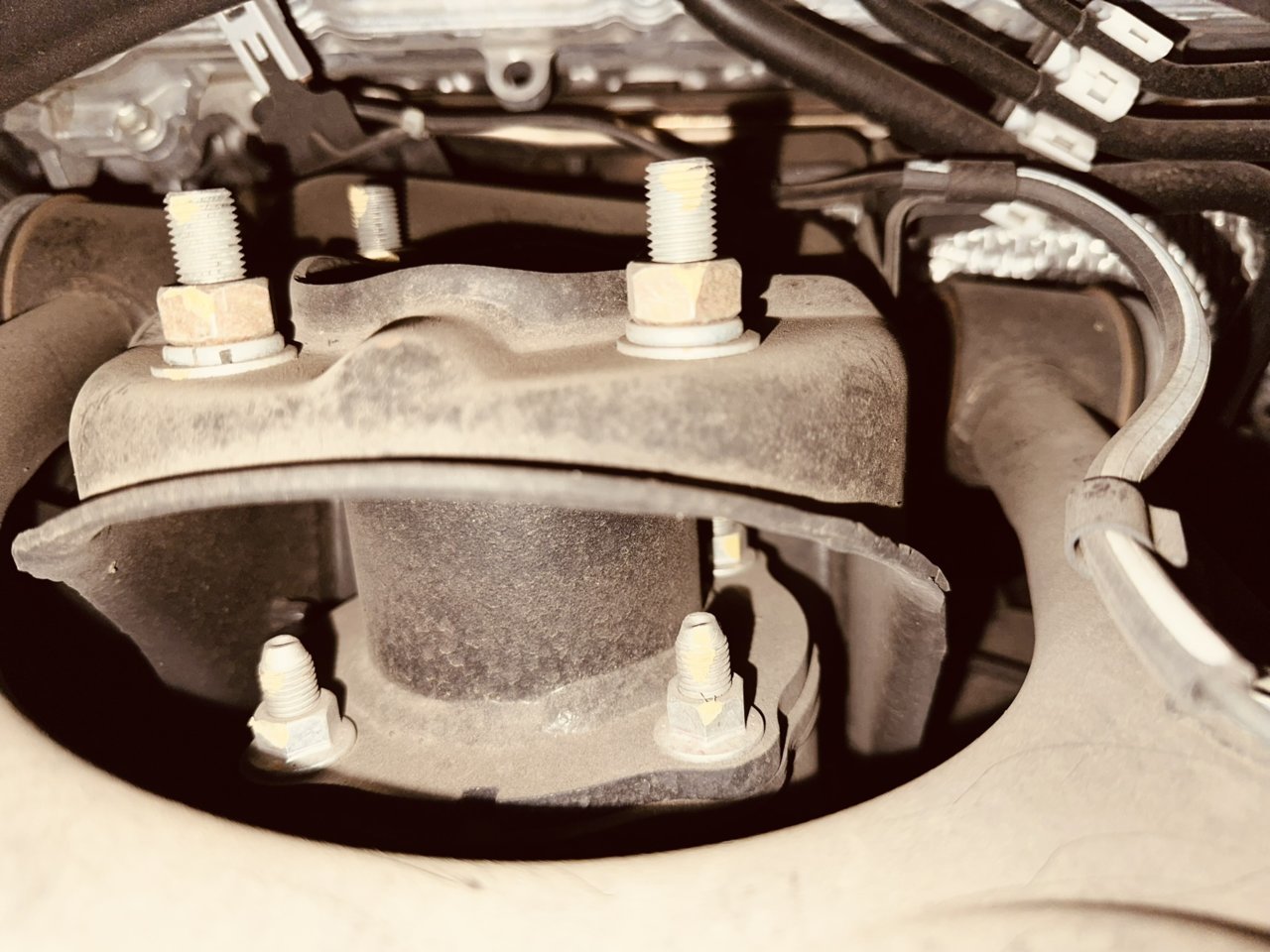

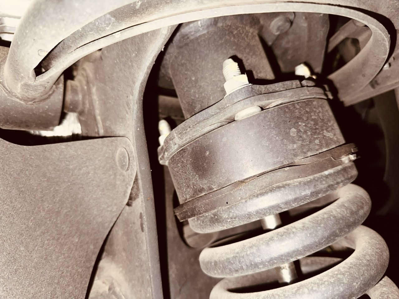

    When I bought my 2019 Crewmax it came with a Pro Comp lift installed on the truck. I am not certain what the actual lift height is. I'm assuming it is a 4" lift but it could be a 5" and I'm pretty sure it is not a 6" lift. Here are a few pics.

    This does look like the 4" lift based on that upper spacer size and rear suspension config. Aftermarket upper control arms add extra geometry adjustments to get camber and caster more in line. May help with tire rubbing if that's an issue. I am not a spacer fan. A single 1.5-2" spacer is meh, and gets you a cheap lift with only some minor drawbacks, mainly downtravel issues and some alignment issues. The double spacer stack you have is a no go for me. It would be like scabbing together 4x4 posts that are too short to build a deck. Does it hold the deck up? I guess, but I would be leery of it, and a solid post would be stronger, and better match the use from an engineering standpoint. Performance gains are absolutely there as the coilover will have more travel than the shorter factory shock, better control of the larger wheel and tire combo you have and handle offroad duties way better with a larger oil capacity that will stay cool longer than the smaller factory shock. If it remote resi, even more so. That being said, if a factory ride is your goal, the 6112s have a rep for being stiffer. The Icons are ell reviewed, and while potentially overkill for your usage, will ride much smoother based on reviews here than the 6112s. No experience with the Freedoms, can't even recall reading a post about them here, so maybe someone else can chime in on those. Also, let's see some pics of the truck!!

    for the lift height, you have to measure the distance between the lower control arm bolt and the subframe bolt above it. Thats how far down the lift dropped. Then meaure the spacer above the spring. It looks like an additional 2 inch lift preload spacer in the spring assembly as well

    I'm not sure about what you are saying with regards to the bolts. The preload spacer is 1-1/4", I know that and I think the one above it is about 2" but I haven't measured that one to be sure but I will.
