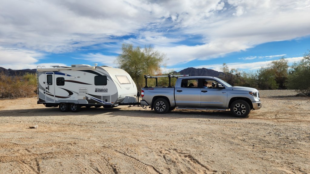

    90% of my camping is boondocking... Not necessarily "Off Roading" but definitely off the road. I like having a trailer that is comfortable but on the smaller side. Many of the places I camp I wouldn't be able to get to in a longer trailer.
    I probably wouldn't want to live in mine, but the next size up would be do-able, and still be small and light enough to get into those BLM spots you're talking about.
    I'm not saying you shouldn't go with your plan, just food for thought. Towing at or near (or over) your capacity is no fun... it's hard work and stressful for both truck and driver at best, and can go south in a hurry and be dangerous at worst.
    With a good floorplan you don't need a huge trailer to be very comfortable.
    My Lance is only 16' 6" box, 21' bumper to hitch, 5,500 lbs. wet and loaded to camp, and is plenty comfortable for me, my wife, and our pack. Again, I wouldn't want to full time in mine (maybe solo) but 3 dogs kinda' clogs things up. :rofl:Especially when I'm cookin' bacon.

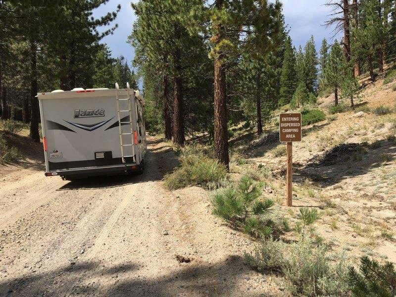

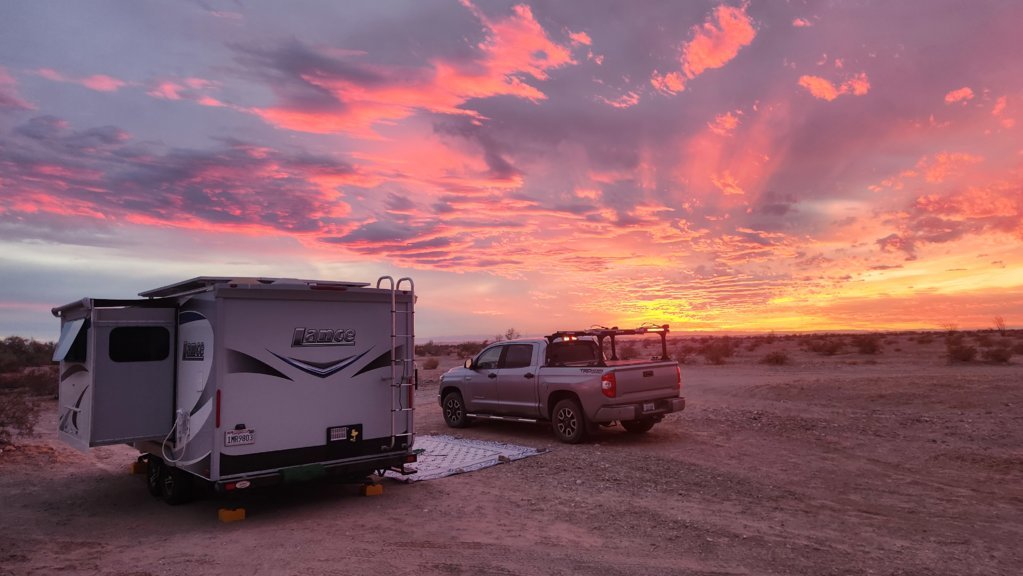

    November was 8 years we've had it, and it's been amazingly problem free!
    I put together a trailer tool kit 'cuz I expected to be fixing things that rattle loose, and so far that's just been dead weight. And you can see from the photos, my trailer spends a good portion of it's travels bouncing down dirt roads.
    Tundra Texan[QUOTED] likes this.
