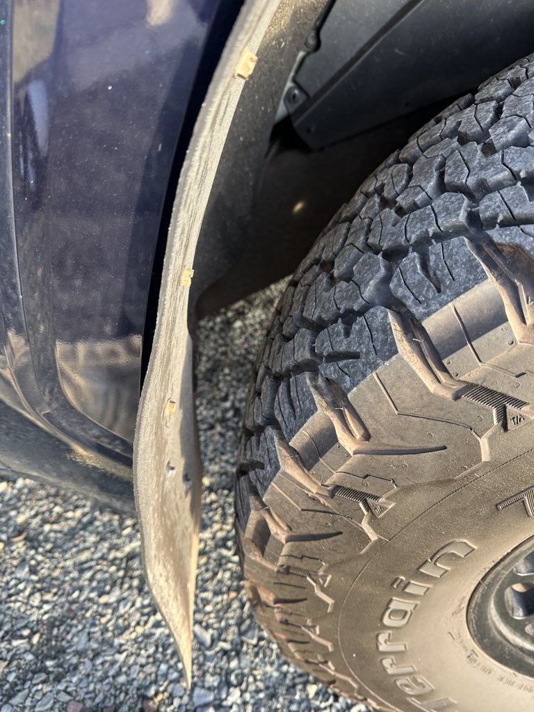

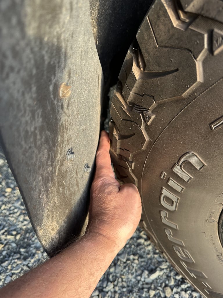

    I have the TRD Lift. Falken 37in tires, Method wheels +25 Offset. I rub pretty bad I’m thinking I need to push the wheels forward with control arms sad I have to alter the lift that is under warranty. What upper control arms are recommended to give me the clearance I need thanks everyone

    Just installing the 3" lift is not enough or really needed to clear 37" tires.
    Fitting the 37" starts with the right offset. +25 push that wheel too much out. Ideal would be +45.
    Did you remove the bracket that holds the felt behind the wheel ?
    What are your alignment specs ?
    I have Kings 3.0 with about 1 1/2 " of lift , TRD upper arm and fit 37"KO2 with no rubbing at all.
    Removed the rear bracket and had to massage the felt in front of the wheel little.

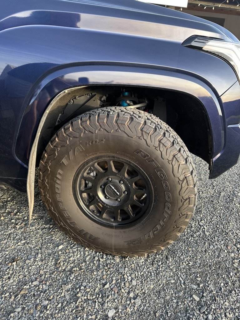

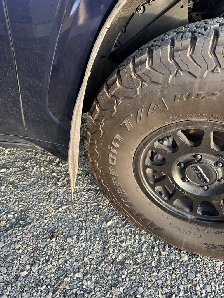

    It looks like this with +35 offset IMG_4120.jpg IMG_4121.jpg IMG_4122.jpg IMG_4123.jpg

    I’d be curious to see the “body horn” on yours. Nice truck man! I know that the falken are big 37” when it comes to actual size. Idk man guess I have the bad luck.

    Body horn is gone
    Yes the KO2 are known to run smaller I when with the KO for the C load rating IMG_4118 (1).jpg IMG_4118 (1).jpg
