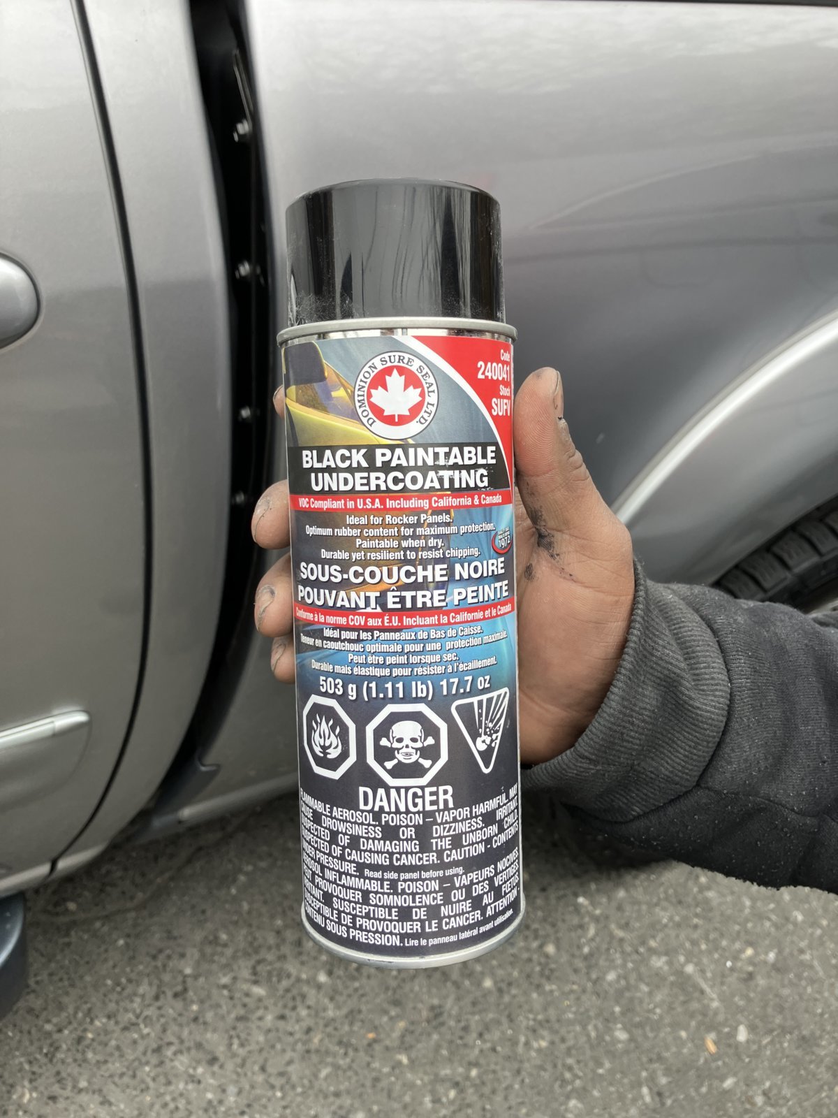

  4. Nov 11, 2023 at 5:06 PM
    Trueno
    Trueno [OP] New Member
    Oct 19, 2023
    #105655
    61
    Will
    2006 Sr5 Dbl Cab
    Something tells me this is NOT good
    Black@Blue19 likes this.

    Any interest in DIY? Undercoating shops drill holes. Holes are bad
    Get a wire wheel on your cordless drill. Spray some rust converter (VHT, corroseal) then get under there with some wool wax or fluid film.
