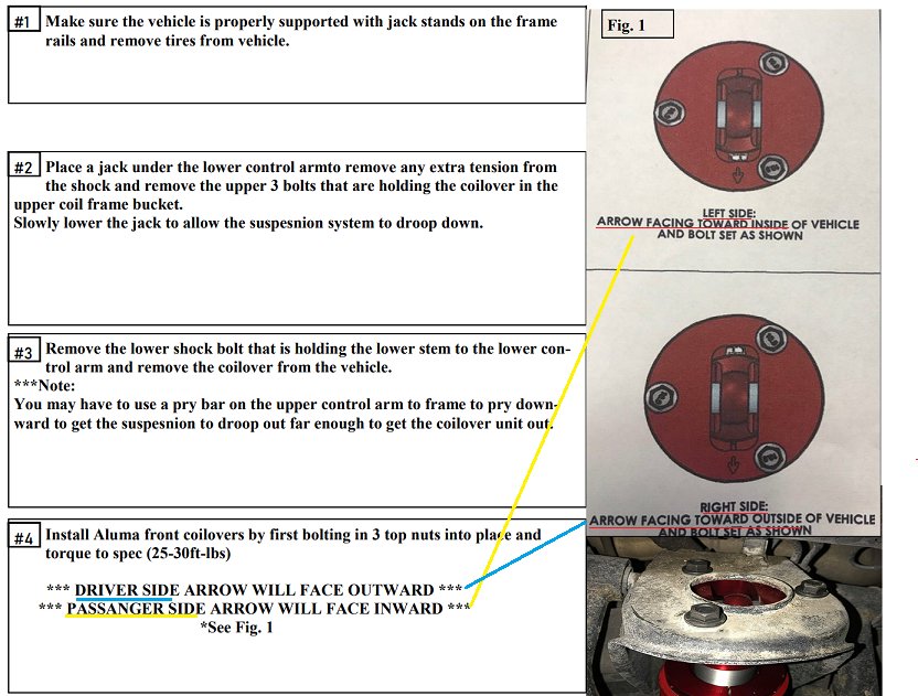

    I found instructions online, none in the box. One CO is marked "DS" so I assume that's the driver's side. But looking at the instructions ... which is correct here, your "left/right" details or your "passenger/driver" details or am I just suffering from a massive brainfart?
    w/Toyota OEM "right" is passenger side, "left" is driver side on everything. The instructions appear to be backwards of Toyota's stuff here... or is it? Is the text correct, or is the picture correct in this scenario?

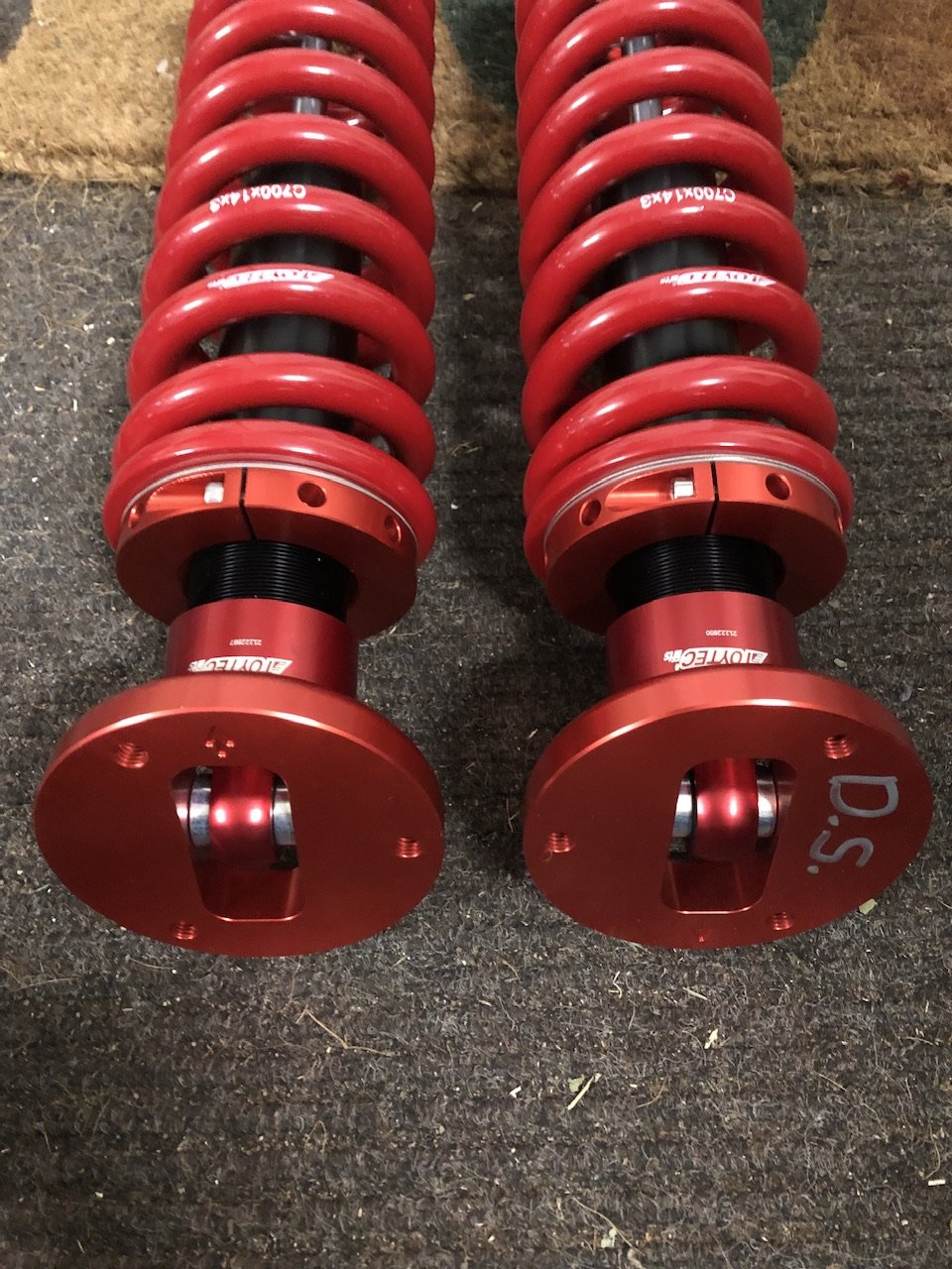

    Basically I assume they want the logo facing outward. If I follow the text "Driver/Passenger" instructions, the CO marked “DS” (which I assume is intended as “driver side”?) would have the arrow facing inward, which matches the picture description, not the text.
    If I go by this picture I'm posting, the "Driver/Passenger" text indicates the left CO I'm showing should be the driver's side. The right one marked "D.S." should be passenger side, maybe D.S. is actually the initials of the person who packed the box?

    Nevermind, D.S. has to be driver's side, it's the only way the bolts will line up while logo is facing out, without having to rotate the lower mount. Mystery solved.
    @Toytec Lifts please fix your Aluma Boss instructions so the driver/passenger designations in the text in the left column match what the images show on the right. Note the "PASSANGER" typo as well.
