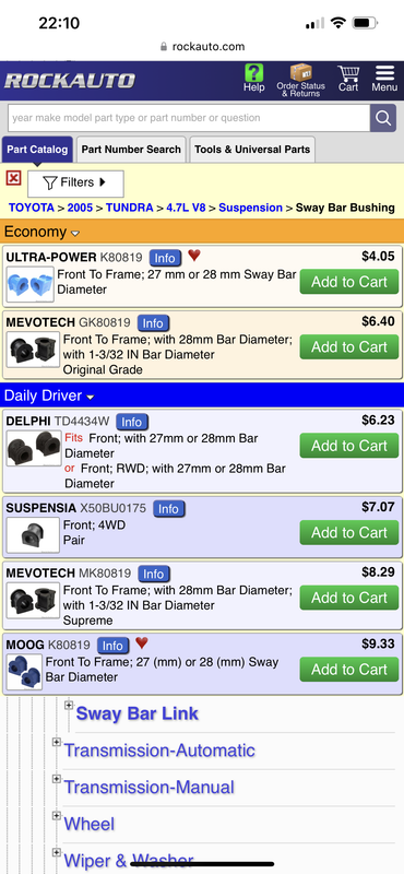

    Any of these recommended?
  12. Mar 12, 2023 at 10:17 PM
    assassin10000
    assassin10000 New Member
    Oct 27, 2020
    #54157
    2,197
    Andrew
    Northern CA
    '05 SR5 AC
    They're the universal ones. You may need to use the provided bracket too.

    The ones I linked for sure fit a DC.
    I had bought some black Moog ones prior and those were too small -- 23mm for an AC.

    Yeah, it says both the ones I purchased and those don't fit, but I know I have a 27mm bar.
