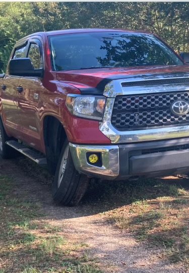

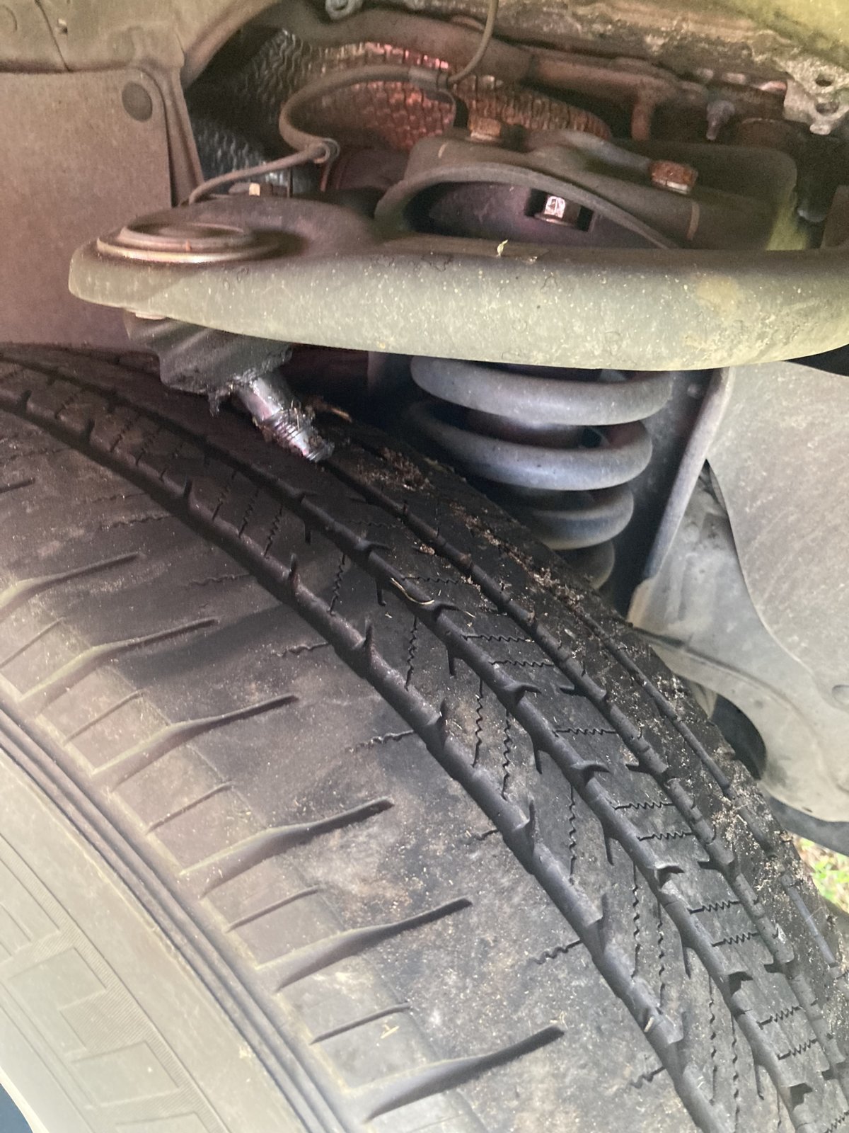

    We turned into our driveway yesterday after a 3 hour trip back from near Atlanta. Suddenly, the truck didn’t want to move forward. I got out to look and saw the problem (pics). What is this part called exactly. Someone said it’s the ball joint connector and the nut that is no longer there should have been torqued at the factory and should not have come off. The cotter pin that is the safety device is also gone and the bolt is stripped. Nothing has been done to the suspension/steering that we know of and this is a 2020 in excellent condition and has been maintained and “inspected” by our dealership. We were very fortunate to have made it home! Thanks.

    I spy a spacer lift, could be that it wasn’t installed properly or bolts tightened up after. Did it collapse like that when you got home??? That’s nuts. Oops just saw that it did in fact happen at home, thank god. Still sucks though

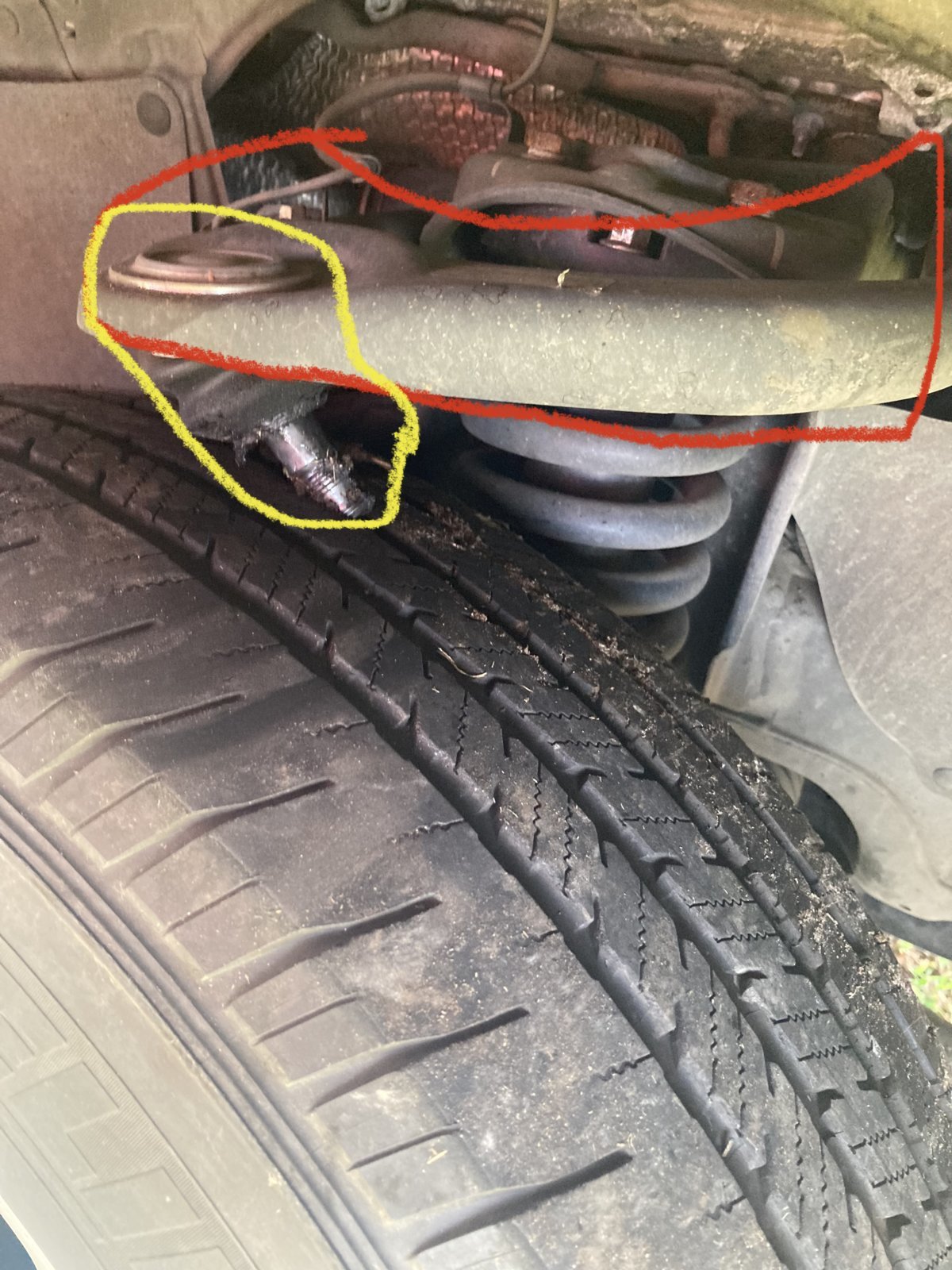

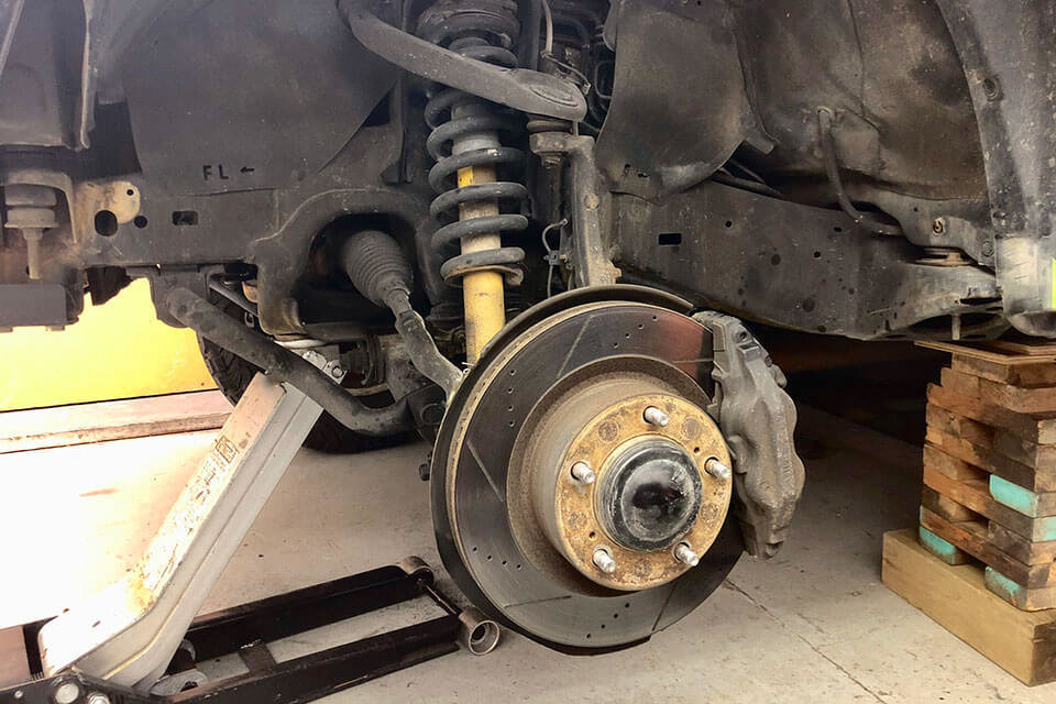

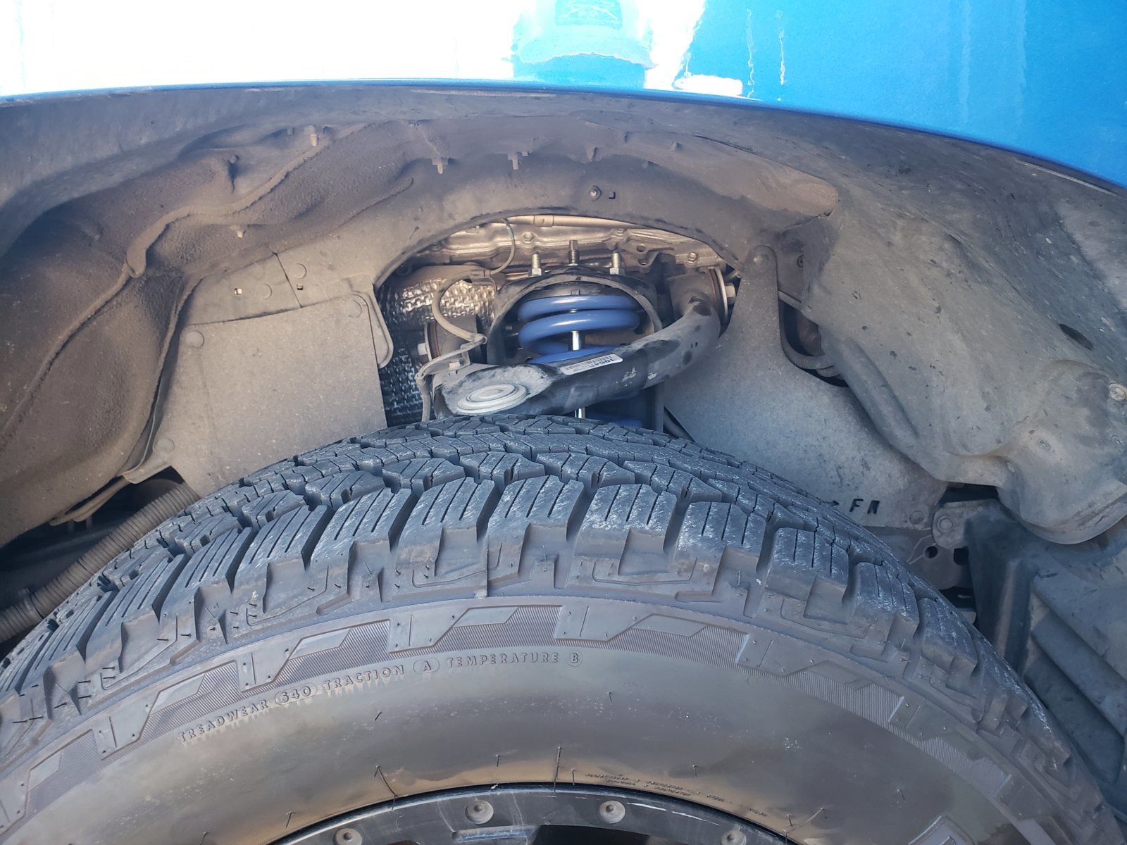

    Red is the upper control arm. Yellow is the upper ball joint that is pressed into the upper control arm. The ball joint connects the upper control arms to the spindle.
    The second photo is showing how it all goes together on a factory truck.

    Someone has been poking around in there. I too see what looks like some sort of spacer lift. Glad you made it home safely.

    I agree on some kind of spacer lift.
    Toyota isn't to blame for that, unless they installed the spacer lift.

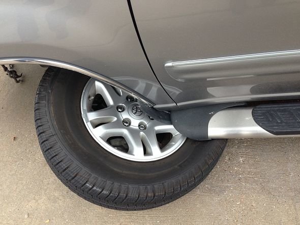

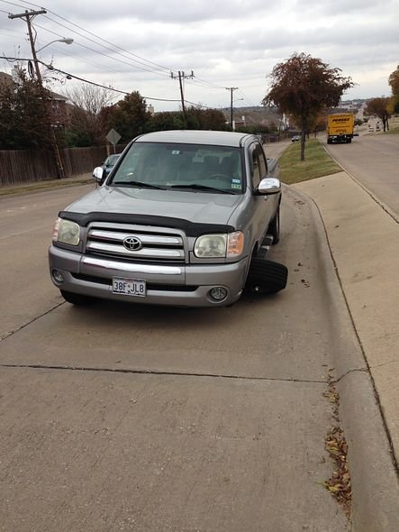

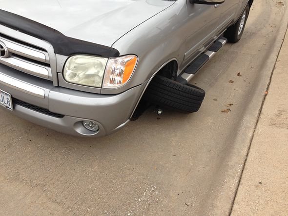

    I had this exact issue with a lower control arm when a shop forgot to install the cotter pin on the spindle..
    6 months later the nut worked it's way off and I hit the right bump to pop the spindle out of the LCA..
    I filed a claim with insurance since it was due to negligence and they sued the shop that did it.
    I even got my deuctable back.
    I traded that 2005 truck in while it was in the shop and bought my 2014.:cool:

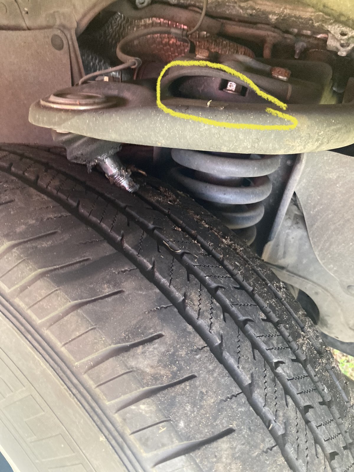

    Could someone draw an arrow or circle where the spacer is? I’ve never seen any before.

    Spacer circled yellow.

    As @Slag_Dynamics indicated, is the portion above the front coilover. Only way to install one is to fully remove the front coil over assembly and add in the spacer. You can see that the bolts on the coil over are only secured to the spacer, and the spacer adds new bolts that go thru that upper bracket to secure the front shock assembly. I would look to see if you have any thread protrusion, I'm not seeing any but it could be angle and there is only a thread or 2 above the nuts.
    Its apples and oranges, but you can see i have a lot of thread protrusion on my front shock after installation.
