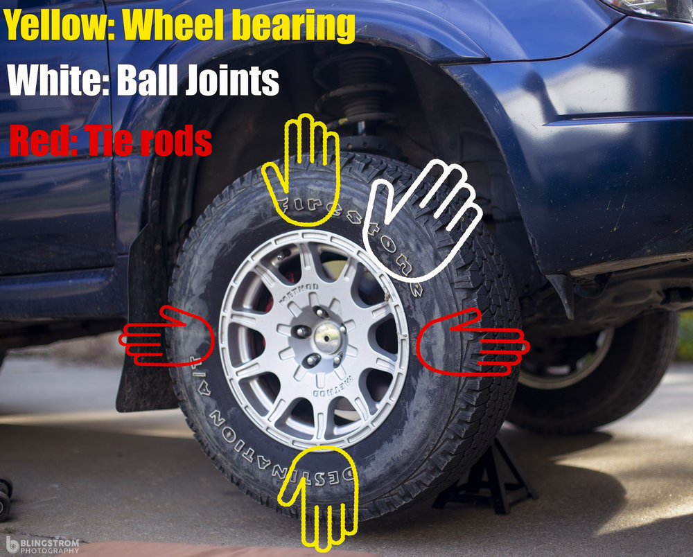

    I think it's one of these issues...
    Possible warped rotor, and...
