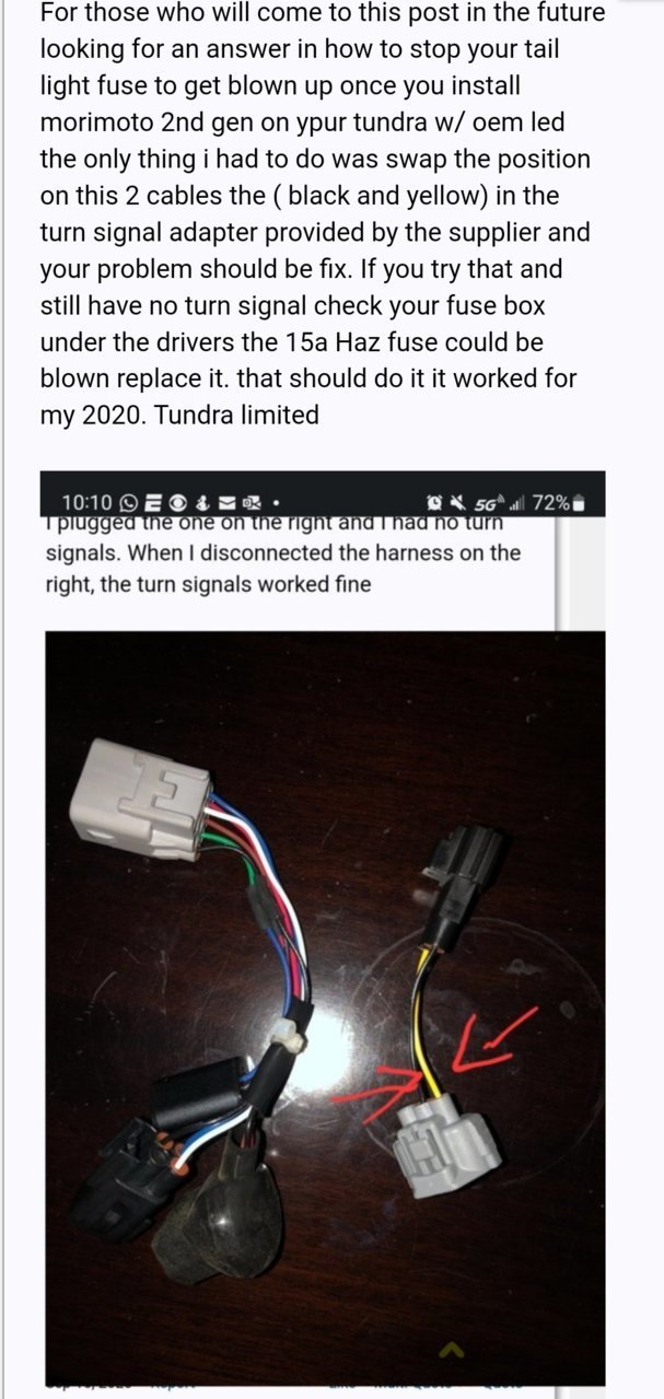

    Check your turn signal plug, MORIMOTO uses the a standard wiring for all the trims and some of them are wired different (models with halogen headlights and LED strip)

    If your truck wiring look exactly like this picture he shared (plug with red arrows)you have to flip the black wire in the center to the outer hole, if you keep it like the picture it can work sometime but eventually will start blowing your taillights fuse
    texasrho83[QUOTED] likes this.

    thanks all i was able to figuer it out.
    for those that may run into similar issue with stock led bulbs:
    leave the harness with black and blue wires unplugged and run the jumper to fuse box. even though morimoto says that jumper is only for non led models you need the jumper to get the start up sequence to work.
