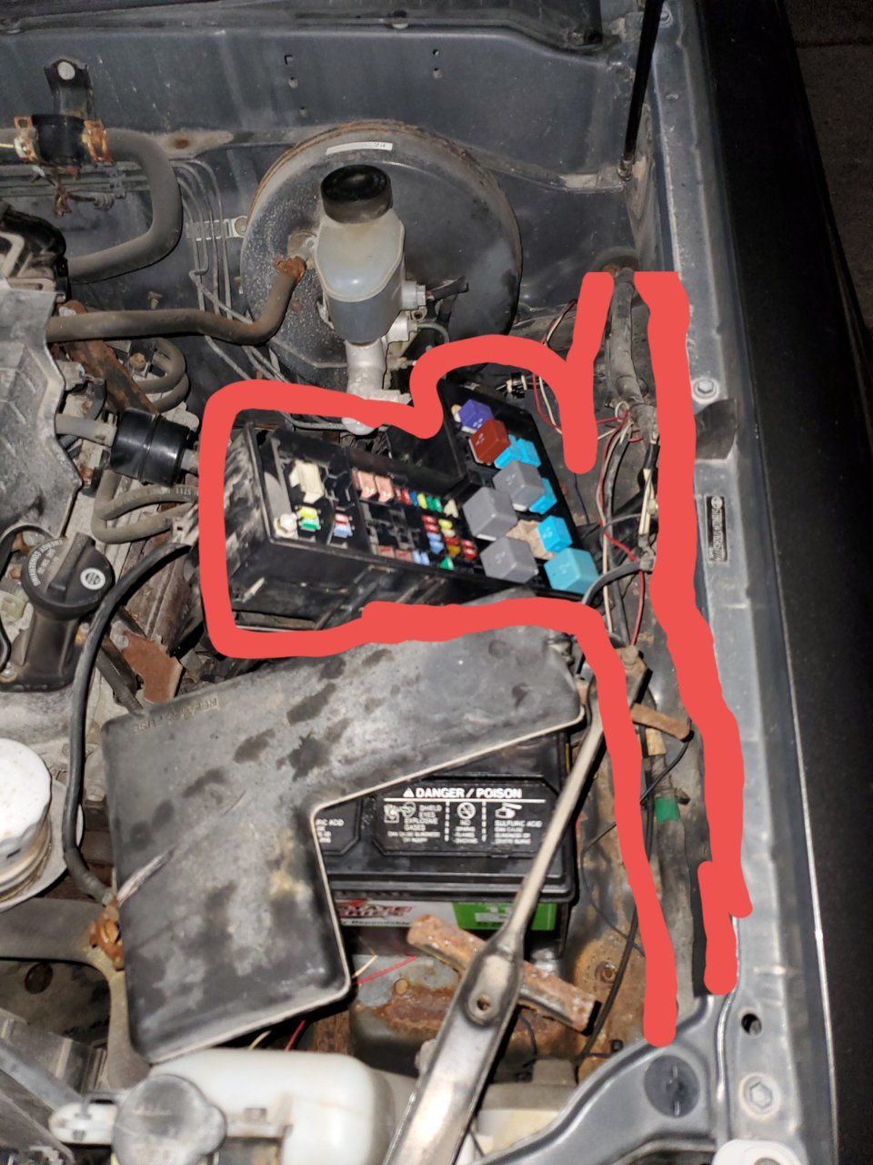

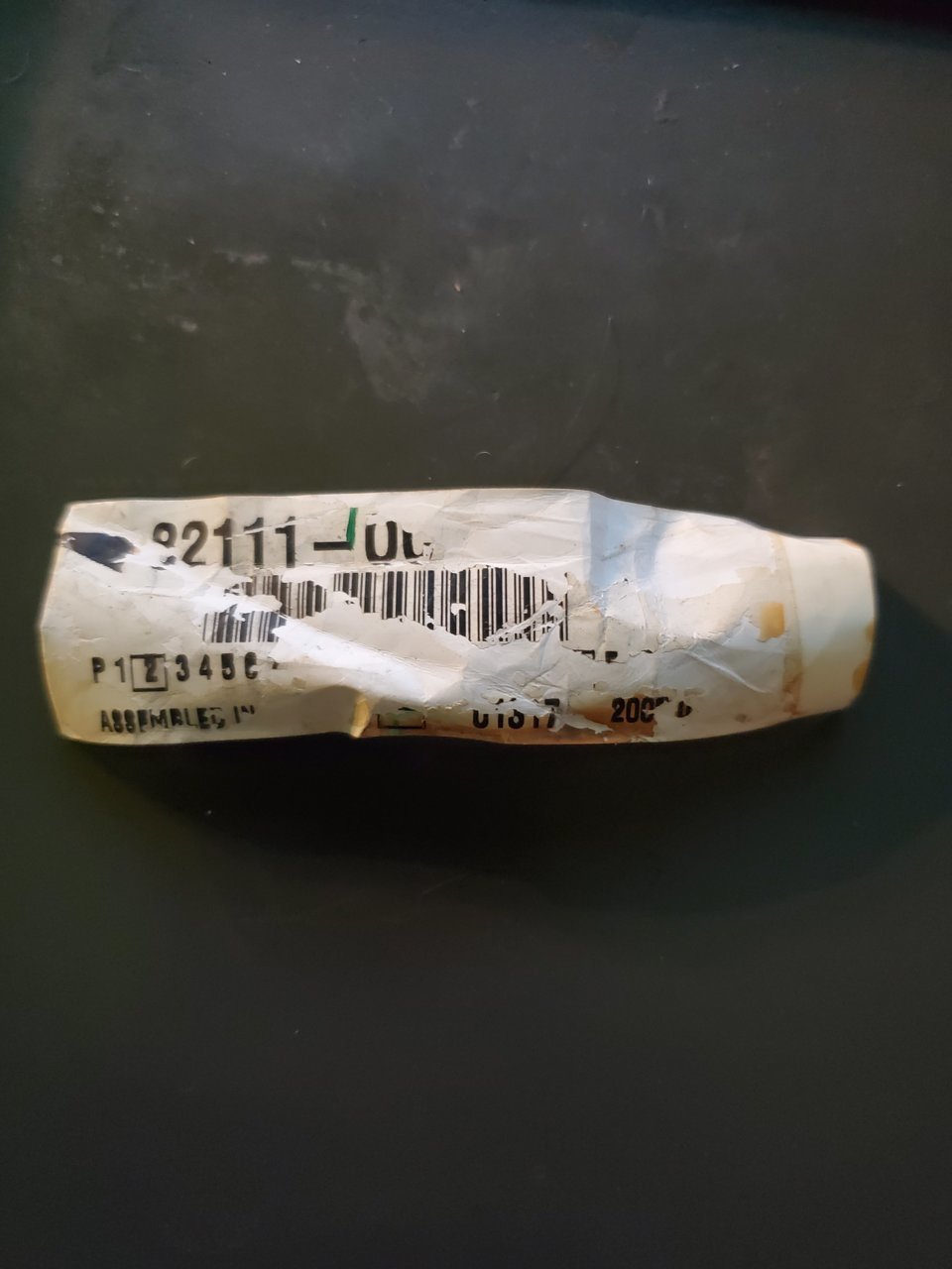

    Hello everyone,
    Nee member here, we just picked up a Tundra this past weekend. It's an 06' Tundra sr5 V6 4.0 AT access cab. Last owner shorted out the harness, we called two local Toyota parts department up, gave Vin and even then they said they need the harness number. There's just one slight problem... the tag's worn out. Part starts out with 82111-0Cxxx, I am not sure which I need since there are six different ones 82111 - 0C280,1, 290,1, 300,1

    I need the harness that hooks up to this fusebox 14CRWMX

    You need engine wire harness. the main one

    The engine wire harness is a different parts nunber and starts out with 82121. That was not the right part.

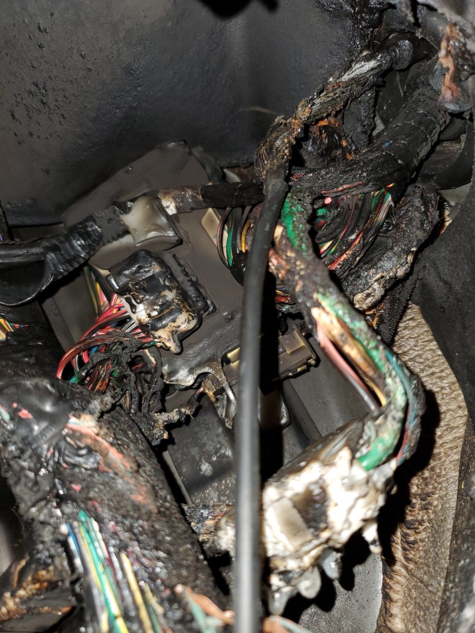

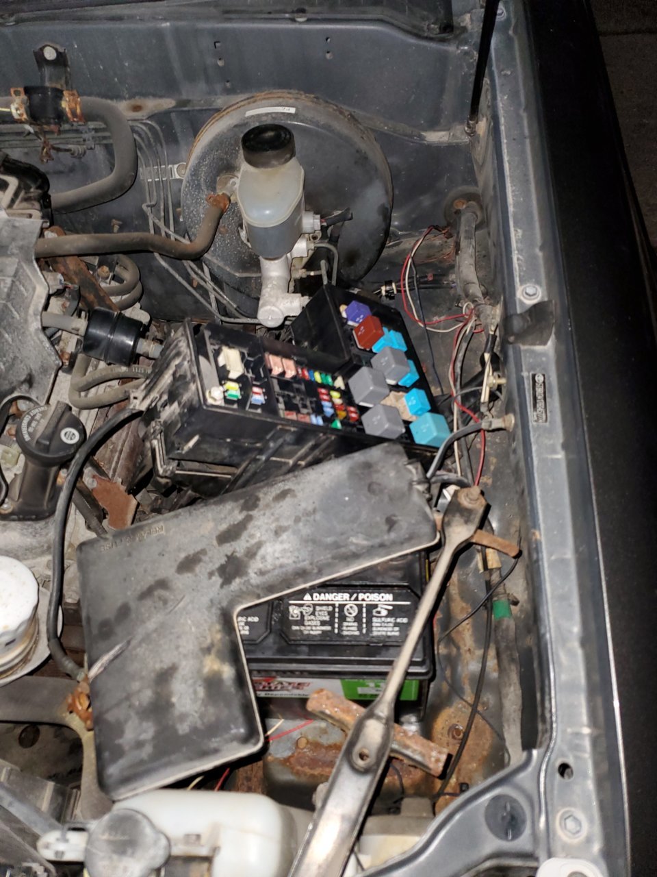

    Man, this is great! Thanks everyone! I believe this is the part number for mine that I will need 82111-0C281 for 2WD, AT 1GRFE V6 engine. Next, I think it's the fuse junction box... Check this out!
    That is what I am working with! 8 blown fuse, four from the fuse box and 4 from the relay in the cabin. Was able to get ODO to display, radio and blower fan to work, high beam, 3rd tail light and cabin light. No turn signal, bake light or low beam and can't crank the starter over yet. This is getting fun for me!

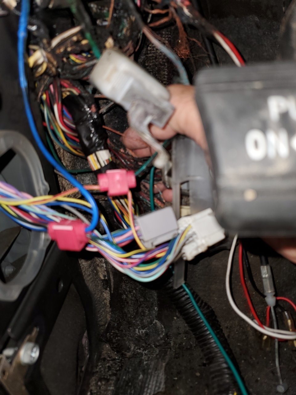

    Was 2k for her, after seeing the rat's nest I asked if $1400 was acceptable, we settled on $1500 + $355 towing, $20 for a kick panel replacement (lighter grey than mine), $90 for the wrong harness shipped from ebay for the engine 82121...
    The original seller is in his mid 60's fly rc planes and he hot wired (with out a fuse) a 12v to charge up his rc airplane stuff and this is the end result. This really does give you respect of how much heat these wires take and how it can wreck havoc.
    My question is in the earlier posted image, the wiring loom that connects to the fuse relay junction (driver side kick panel) that took most of the damage the wiring harness goes to the floorboard, it looks like it's the loom for seating sensor, seat-belt restraint and taillights? The only real bad damage to the harness was the melted hood latch cable from the main fuse box. But for $350 I might just replace the entire 82111-0C281 harness. I believe that's the one I need.
    See pic attached. The wiring loom that goes to the floor pannel is the one with the most damage with three or four melted wire casing. Definitely not going to get tailights with that.
