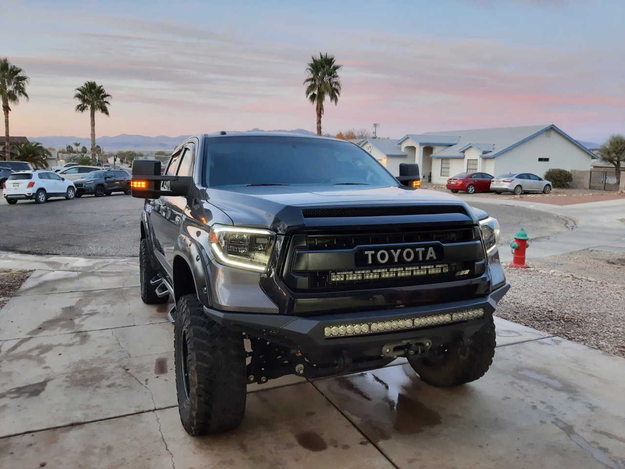

    SPOD allows 6 items, all with fused outlets. I run my 42 inch ONX6 plus BD front bar, 2 BD 8 inch fronts,32 inch HR light bar, bed lights, BD bumper lights, and my ARB onboard air compressor

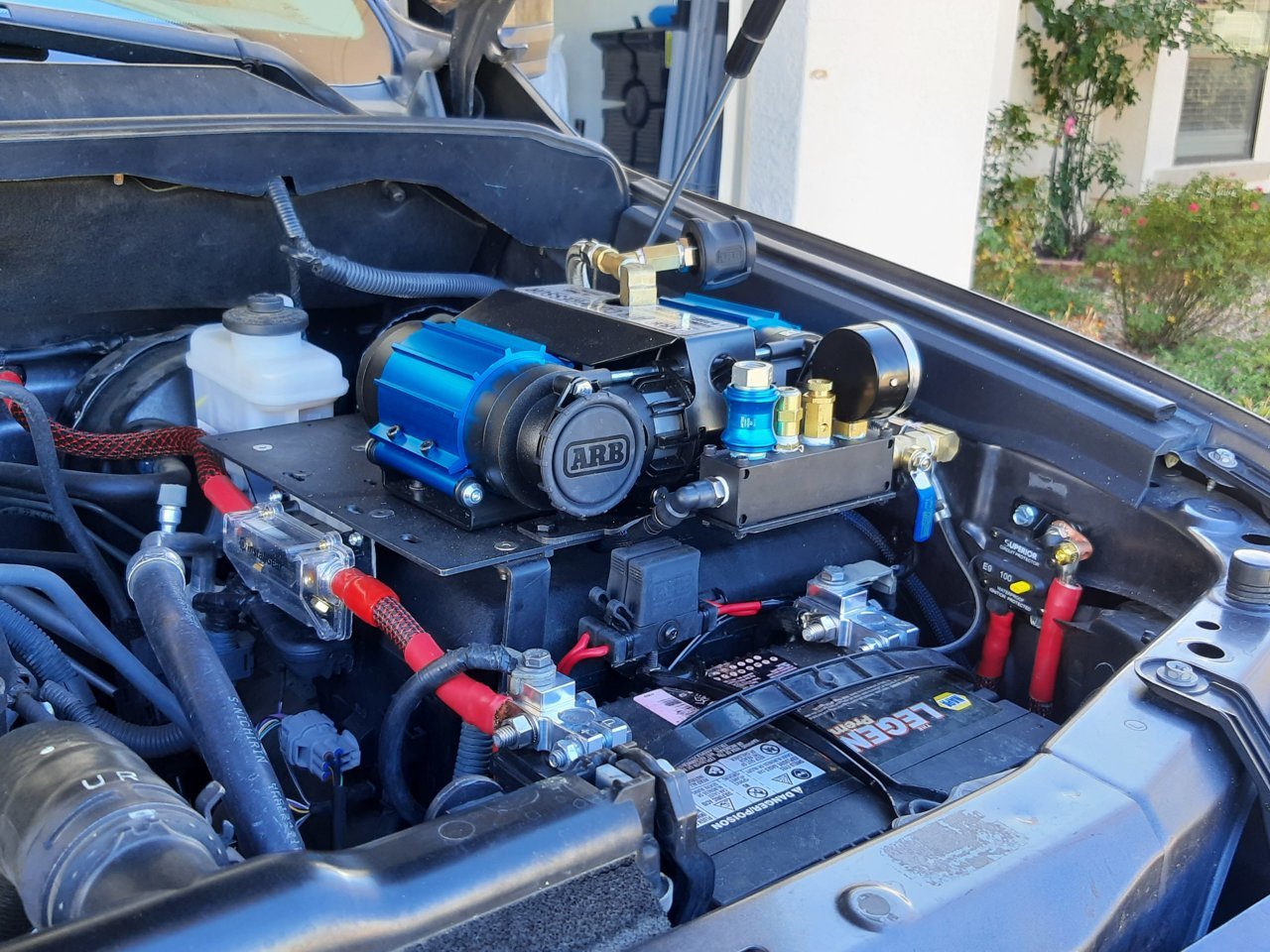

    Did you build that air manifold? Nice set-up!

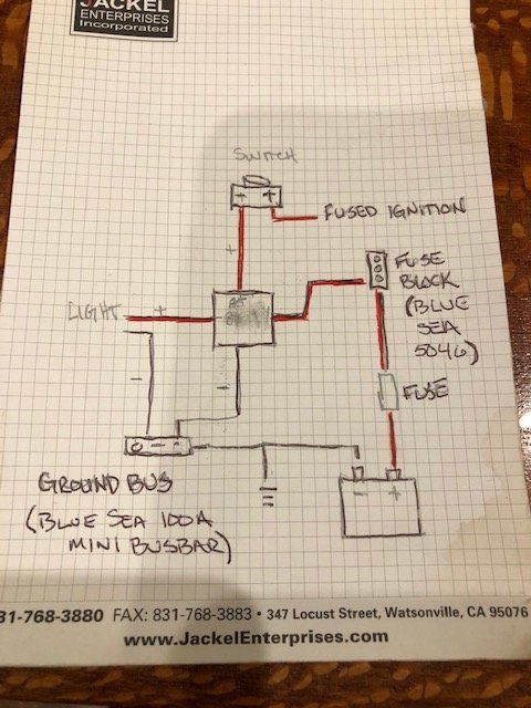

    I had one of those cheaper switch systems, tossed it in the trash. There are lots of benefits to using one of the switch systems but you can easily build what you want and learn a bunch in the process. Someone above mentioned switches not being able to handle the current???? This is what relays are for, the switch handles minimal current simply to open or close the relay. The higher current passes through the relay, not the switch. Here's a quick example:
    I added the Blue sea mini busbar cause it's a really bad idea to just ground lights all over the truck, much better to run all the grounds to one location.

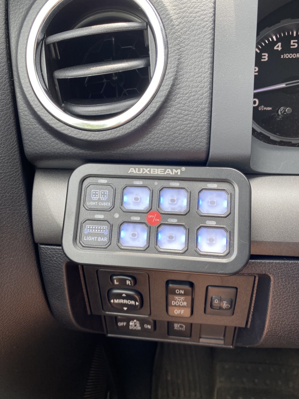

    I’ll vouch for Auxbeam as I’ve been using it for 5 months now; have wired my light bar and ditch lights to it.
    I wouldn’t want to wire anything to the a-pillars given that if the airbags were to go off, you’d have switches in your face and body.

    Relays are built into the fuse box! I had that question too, but all the relays from the harnesses were causing so much wiring mess in my engine bay.
    It’s been really reliable so far!

    Nada! Works damn well. Once your truck is on, you can set which lights you want on and able to turn them all on/off at the same time.
    It’ll reset once you shut off the truck.
